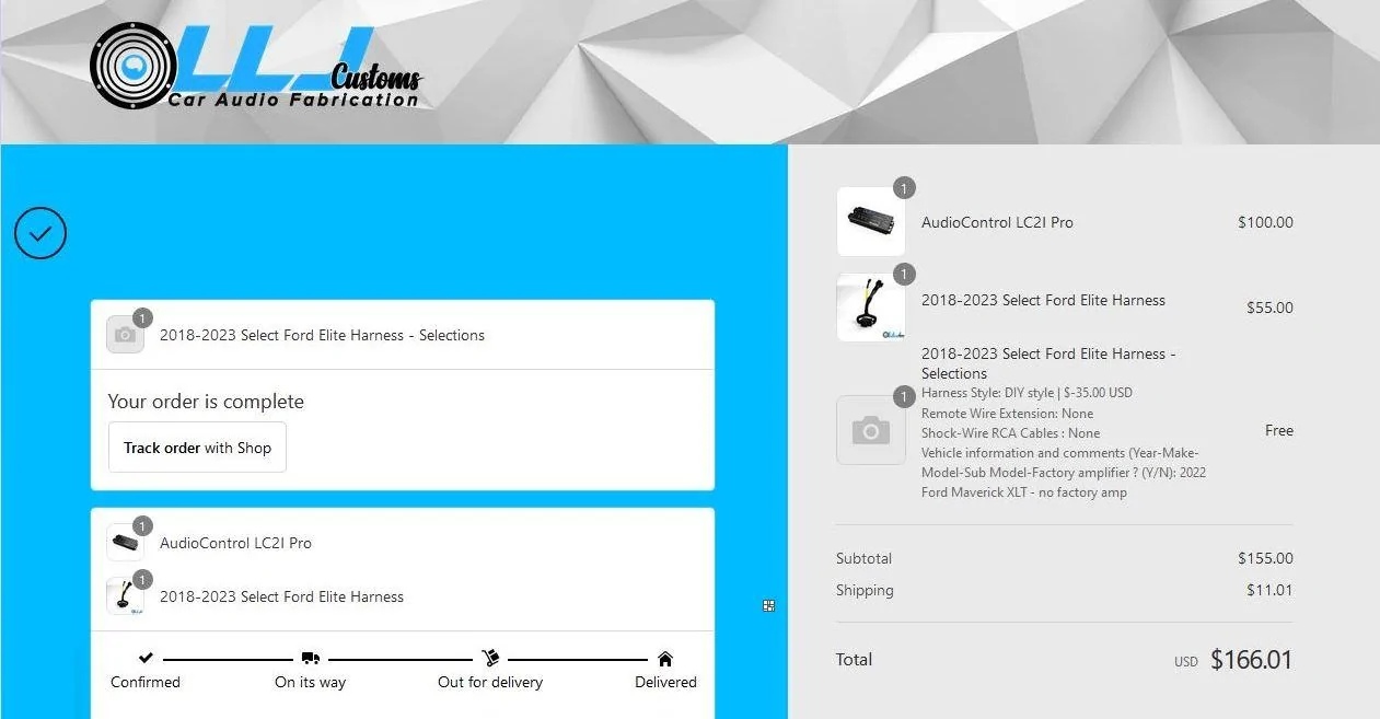

I've gotten a few more PM's from forum members requesting the LLJ Customs part number for the DIY harness. Since they typically "build-to-order" with many customization options, there doesn't appear to be an encompassing part-number, but below is what I selected and ordered:
Ford Maverick Budget stock Audio upgrades (XL) - plan, research, options and experimentation LLJ Customs Harness
