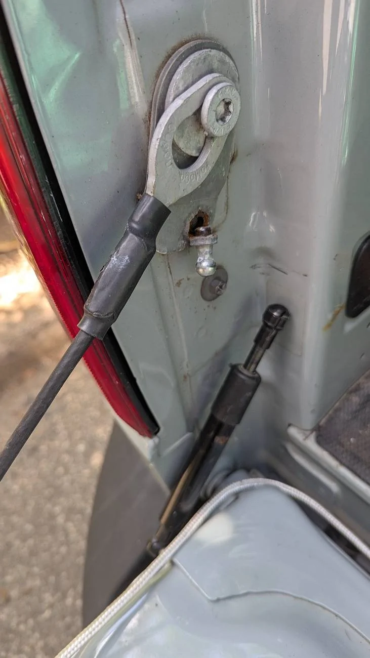

Broken stud on vertical wall for tailgate assist

I don’t know how you managed to break it at all. The cable should have stopped the tailgate from putting that kind of load on the ball.
You will notice that the cable end is missing the retaining clip. A minor warranty claim to be made. So perhaps the cable end was not attached to stud and all the weight was on the damper.

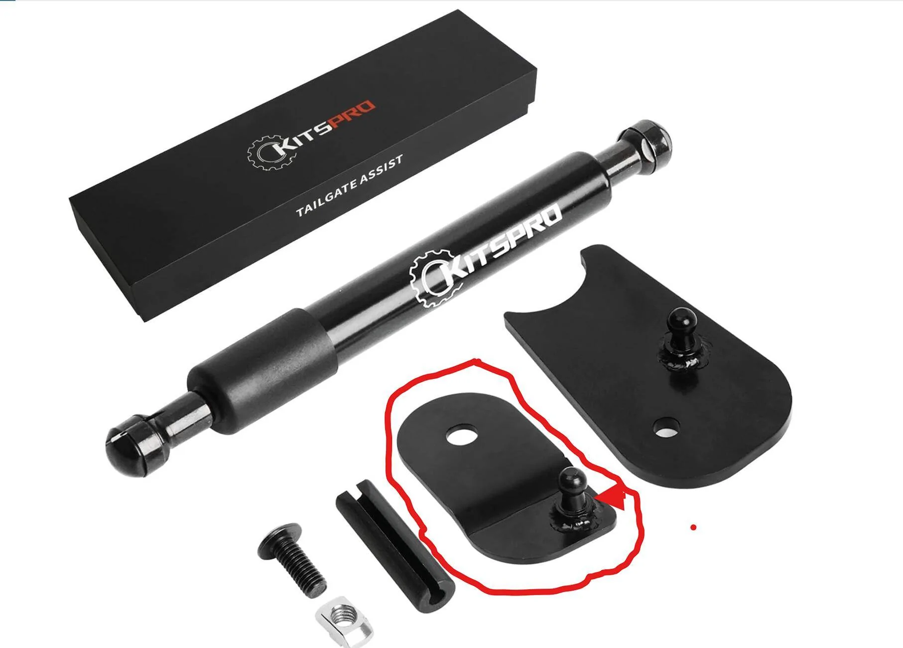

Just to clarify, the part circled in red is the proper piece to use as the upper bracket. In the photo he provided it is slightly askew and not straight up and down as required. Is this the reason for the break? I think not as that angle should not affect the strength of the weld regardless of the angle.
It is clearly the weak point on this device.
By the way, on Ebay I have found the same complete kit for $9.95. I ordered one as at that price it would give me more confidence than my epoxy fix. It also is alreasy painted black to match my blackout package.
From my evaluation they are all coming out of the same manufacturer, just marketed under different names.
f1jim
I can weld that ball stud for you for nothing, but neither of us can afford to ship back and forth, as that would be more than replacing it. I say that but, it may be made from Chinesium Alloy that is 2/3 junk that will blow a part when you strike an arc. It looks identical to the one on my Maverick, except mine is painted black. I didn't remove mine to view the backside but I suspect the ball stud was electric spot fused to the plate and it was contaminated and simply didn't fuse. A local welder can fix it, butt it will take some of his/her time to clean the rust, lay a bead, grind it smooth and call you to come and get it. Buy a new one.
