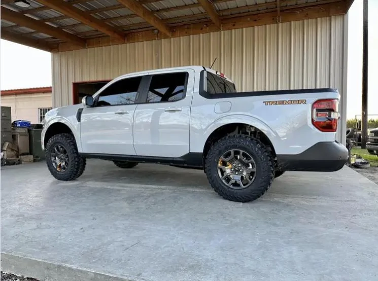

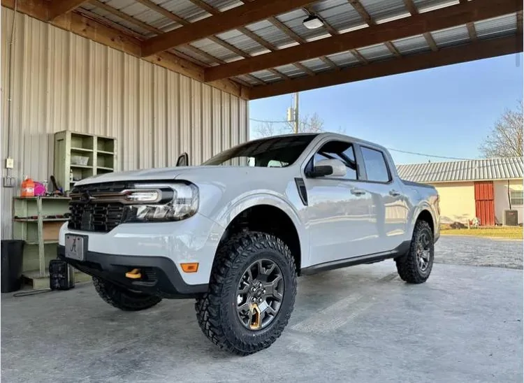

As people have more time to do upgrades we will see more big tire Tremors.
The Maverick is light for a truck, that should help it off-road a lot.
