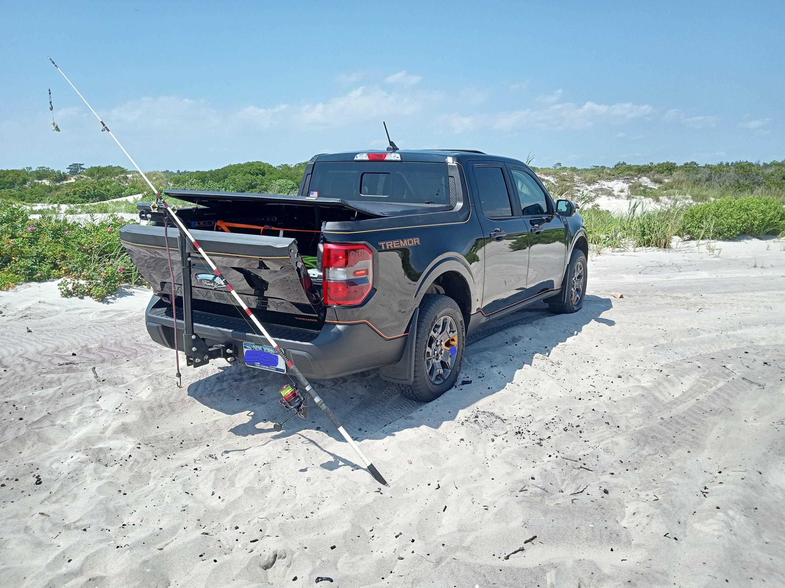

Hey all! Just got my new Tremor and want to go bigger with the tires. What's the largest that can fit without rubbing/modification? Anyone have photos of their Tremors with larger tires?

I'm not sure. There are lots of suggestions on the forum however I'm thinking of going with just one size taller with 235/70. Don't really need a wider tire on the sand. Just air down to 18 PSI. Your photo looks like you are at D. point or Sore Thumb beach?
