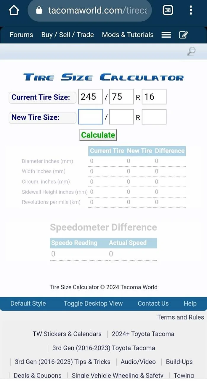

Nope, people have reported mild rubbing on the Tremor with 245/70R17’s. In the top right corner of the page, there’s a little magnifying glass icon. That will let you search the forum for previous posts, so that you don’t have to reinvent the wheel each time.

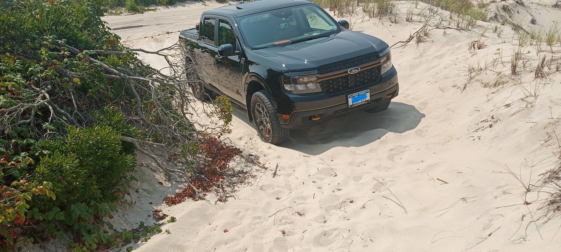

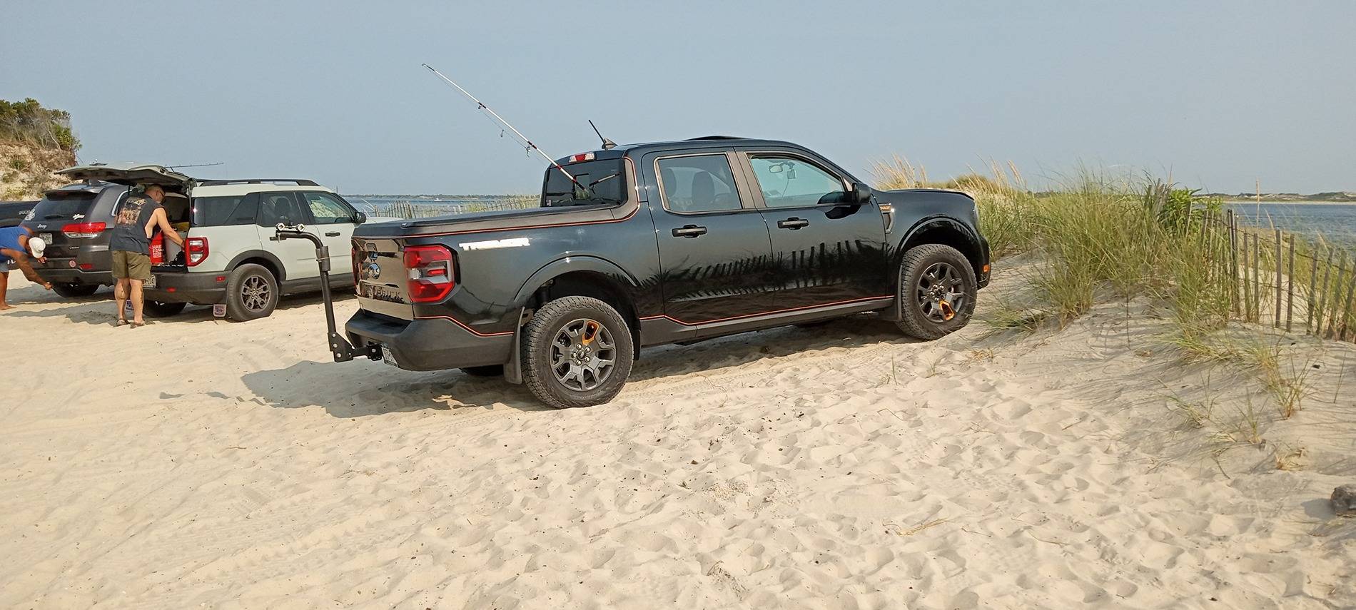

Personal opinion based on personal experience and comparison I would go with the narrower tire. If you are looking for traction a narrow tire has more traction even with airing down. Hopefully a little better gas mileage as well. Also in snow the narrow the tire puts more pressure to increase traction as well. So those are the reasons I would prefer the r65 vs r70. It just might mean the difference when off road.

Agreed. Narrower tires work better in snow. Not sure why all of these amateurs think they need 20 inch wide tires in deep snow. A Maverick on 225 width dedicated snow tires would go right through this, just driving right by these snow wheeling trucks and artic trucks. These wide tire guys are just clueless. 🙄
