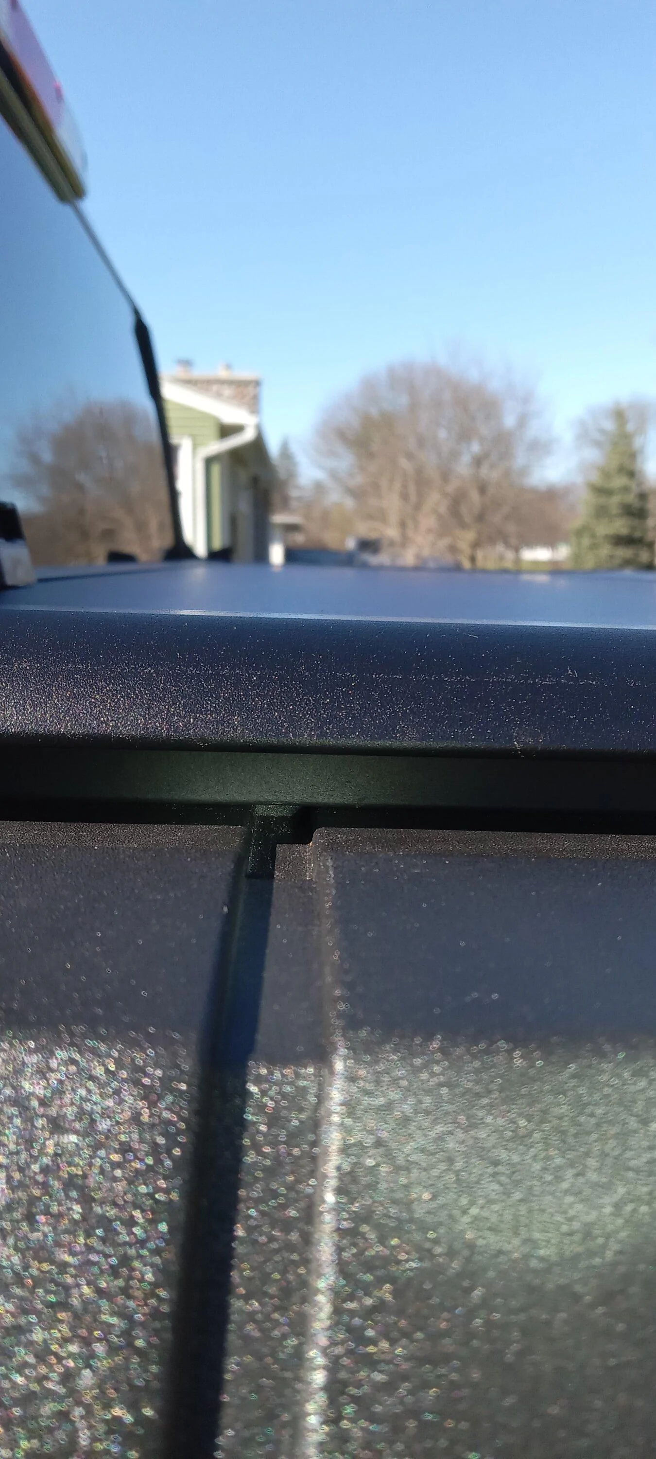

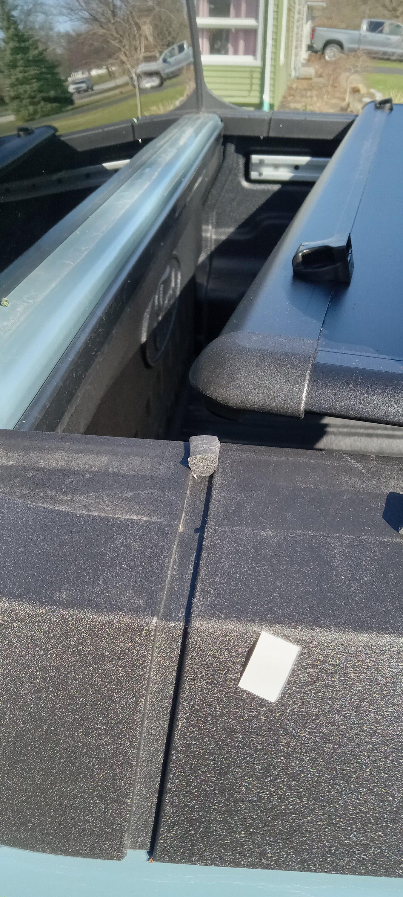

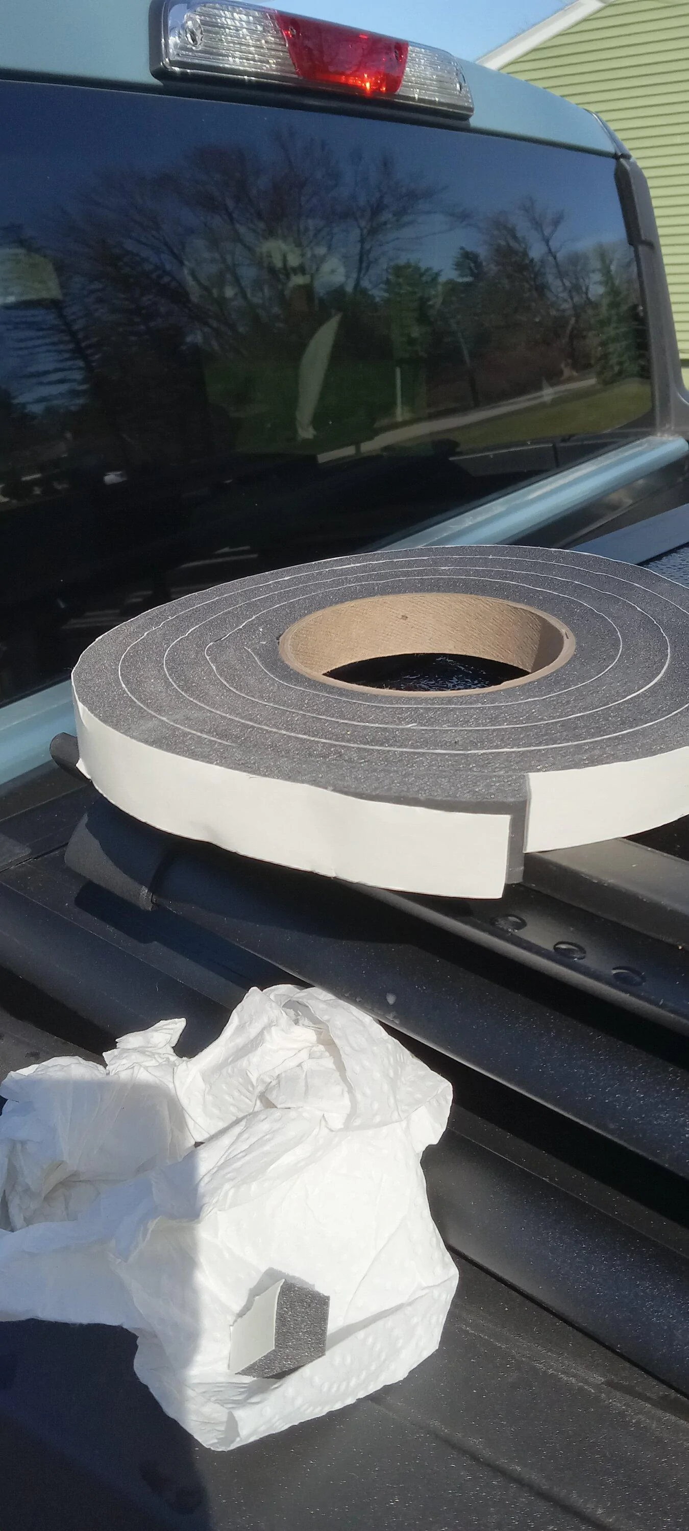

I have an Undercover Triad tri-fold. Keeps the bed pretty dry. But with any "sit on top" cover, there is a gap in the bed rails where water can get in. So I tried some foam tape that is used to seal doors/window gaps in the winter time. Seems to help keep water out. Went through a car wash and the bed stayed dry.

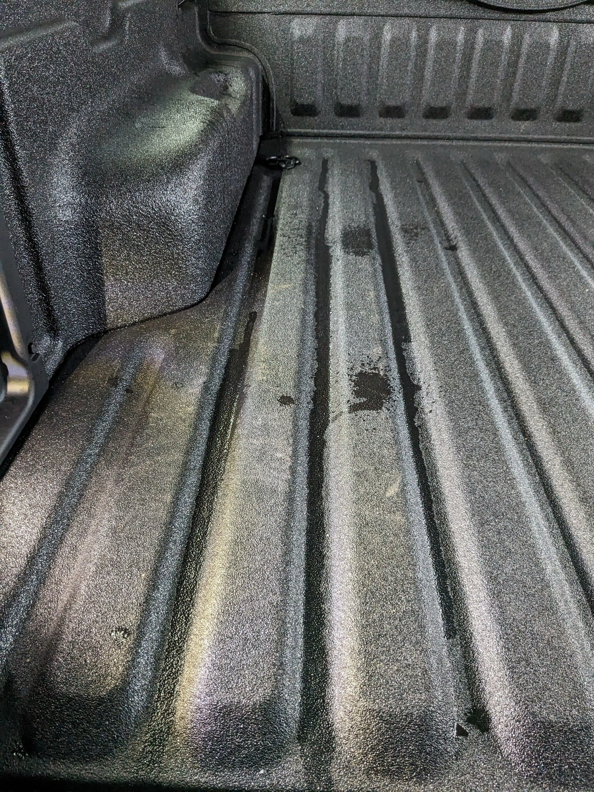

It's pretty frustrating, especially because I really like the cover otherwise. It looks good and seems well made. But you can see what I've been dealing with in the photos below. Water seems to leak in through the panels and drip out of the locks (they screw into the panels).
It may not look like much, but it really accumulates with a decent amount of rain. And for a $1000 cover, it shouldn't be leaking at the seams. The cheap soft trifold I replaced with the bakflip kept the bed drier.
Bak seems to acknowledge this isn't normal, because they keep sending me free replacements under warranty.
I'm also surprised I haven't seen more (or really any) complaints like mine. Like I said, I'm on my third cover and they've all leaked like this. Surely this is a widespread defect and I didn't just get unlucky three times in a row.
