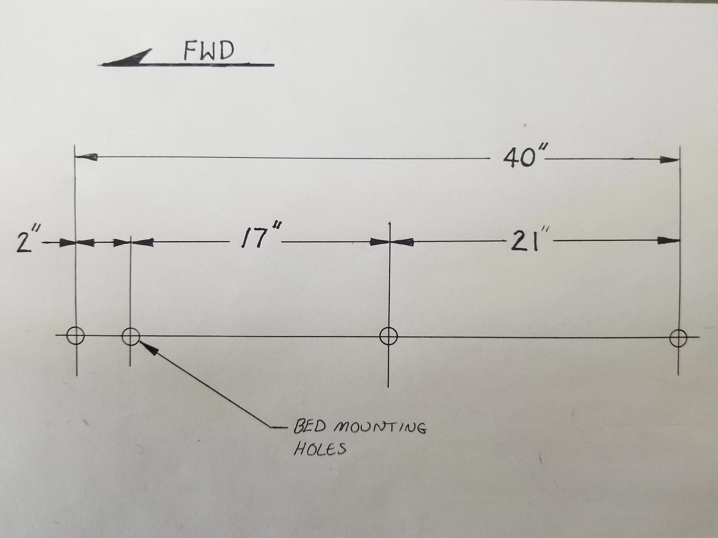

Nice diagram of hole placement. My hand diagrams never look that neat, in order to get something like this I have to pull out a CAD program. I was starting to look into considering this as a project for my Mav that I don't have yet, but was discouraged by someone else saying that the holes in the bed of the truck wouldn't line up evenly with the pattern in the L-Track. But if those hole spacing intervals that you show are accurate, they would match up with the 1" spacing of the L-Track pattern. (Obviously one would have to drill and countersink their own holes because the track that I found based on your breadcrumbs (see below) has pre-drilled holes on a 4" pattern.) You are giving me hope that I can revive my interest in this as a project.
Since front screw mounts are smaller thread. I did 2 screws instead one, and you just remove the cleats to install the track
Are the factory cleats attached to both the holes separated by 2", or only to the front-most hole? I've been trying to scrape the internet for the two sizes. If you have a chance and have a metric bolt sizer, would you please measure the size and thread pitch of the two sizes (either grab one of each off your truck, or if you can find the spares from this project).

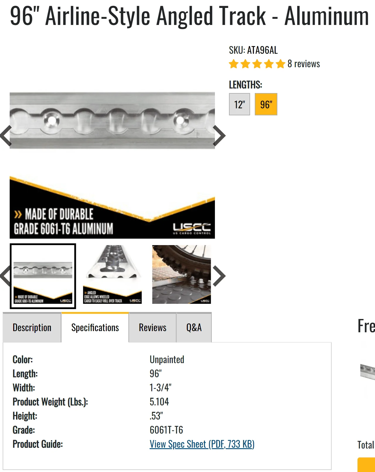

Not sure what grade the aluminum was. The website didnt say. It was UScargocontrol.com I believe.
If it was UScargocontrol, it was probably this product which is currently $76.66 for the 96" length (more than enough for both sides of the Mav truck bed). The product page does list the aluminum grade as 6061-T6, what ever that means:
Thanks for the kudos on the diagram. That's my old high school mechanical drawing coming back to haunt me lol. It does still work well for me at work when I have to convey proposed repairs to the aircraft manufacturer engineers. I speak their language. UScargocontrolcorp sells that track also as a blank. With no holes in it. That's the one I ordered. Drilled all my own. Yes the factory front cleat picks up both fwd holes. Since they are smaller fasteners than the middle and aft holes I figured picking up both of them on the track will add strength at that end.
In between the 17" and 21" lengths on my drawing, theres 2 more threaded holes on the bedside, but they do not line up in a straight line with the ones on my diagram, nor do they measure at exact inch increments, so I didnt use them. I feel that if your pulling that hard on the track between these 2 spots to bend it, well then your also pulling the sheetmetal of the bed wall in as well and have bigger issues.
If you use the measurements and drill at the center of each circle, these will fit. If you dont have countersinks, I can recommend using a torx button head bolt to hold the tracks on. The 48" tracks, you will end up cutting about 5"-6" off one end when done so they fit.

I just watched an install video (the guy had pulled them off of his Lux package before selling it to put on the replacement non-Lux). The top front (i.e. closest to the cabin) tiedowns are removed to make space. And there are 3 weld-nutted holes of which only 2 are used for this sliding. Given the short size of the bed, I wonder if just mounting 3 eye bolts on each side (held in place using a jam nut) would provide comparable flexibility at a lower profile. No, the eye bolts wouldn't slide for custom positioning, but you have more on each side. No, that wouldn't look as nifty as the Ford Accessory, but the parts can procured for around 1/10th the cost (depending on the eyebolt).
If anyone is curious...
On another thread where this L-Track is mentioned a video is linked by Sam Haymart at TDTVGarage. I think I trust Sam and the rear holes are M8 and the front holes for the factory tiedowns are M6. Man he has a good instructor's voice.

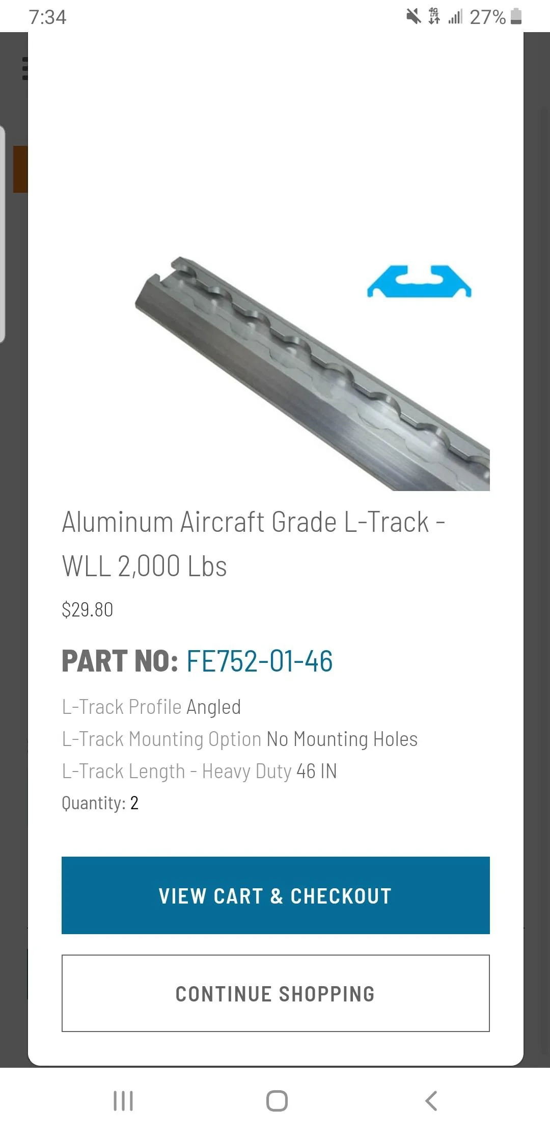

I found it. The L track is available in 46 inch length undrilled. It's really obscure to find it on their website, but here it is. Note on both pix it says undrilled holes.
Ford Maverick Bed rail system worth it? Screenshot_20221118-193459_Samsung Internet
Ford Maverick Bed rail system worth it? Screenshot_20221120-061308_Gallery
