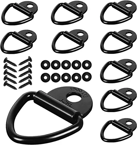

Was going to do the Rail System, thinking it would be stronger, but once the truck was delivered felt the Rail was an overkill for what I needed. Securing a 700 lb motorcycle. The section of the bed with predrilled holes is a thick structural piece of steel, so no worry of a bolt pulling out from stress, and the rings have rating of 1,500 lbs.
I decided to use LOOPS with different bolts that are compatible with Maverick's bed predrilled holes. Did not want the rails that stuck out so far, taking up space and potentially interfering with a bed rack I may install. These loops from Amazon were something like $16.00 with bolts and are out of the way flat when not needed and one in each predrilled hole is more than enough to strap down points for anything I haul.. .as in Motorcycle. These loops sort of match the loops in the bed floor.
Important to note whichever way you go, if you are getting a SIBL I'd have your SIBL guy install these after the SIBL is applied. My guy did it free....took 3 or 4 minutes. Screwing these in through the SIBL was not easy without a very powerful drill.

I decided to use LOOPS with different bolts that are compatible with Maverick's bed predrilled holes. Did not want the rails that stuck out so far, taking up space. These loops from Amazon were something like $16.00 with bolts and are out of the way flat when not needed and one in each predrilled hole
Do you hear these loops flopping around as you drive over bumps?

Defiantly not. Been on for 8 months and they are like hinged when opening and closing them. Have to even give loops a little pressure to raise and lower...and stay where ever you leave them which is handy when attaching ratchet strap hooks.... very well made. Powder coated so no rusting!

Nice. I did a little digging and among the many similar options, I found the ones you use (based on comparing the pictures):
JCHL Cargo Tie-Down Anchors, 10PCS V-Ring 2" Diameter Steel V-Ring Bolt On Trailer Anchor for Cargo on Trucks Pickups Trailers Flush Mount TieDown Anchor
For others, they aren't called D-Rings, rather because of the pointed shape of the ring they appear to be called "V-Rings". Looks like a possible option to add to the tailgate either in addition to or as a replacement for the "bottle opener" tiedowns. Especially if one puts the soft-open shock on the driver side.

Sorry it was January when I put these on, but I had to dig up the rail list of material to get the right bolt size to fit the pre-drilled holes. Pretty sure I picked up the bolts at Lowes. I really like these ”rings” since they sort of match the other rings in the bed and are very strong…also the pre drilled holes covers probably an extra 1 & 1/2 feet in length versus the rack length.
As mentioned in the Load rating - each ring is rated at 1,500 lbs….so the ring is not going anywhere. And these V-Ring have a 2 inch opening so any ratchet strap or rope hook should fit the big opening.
