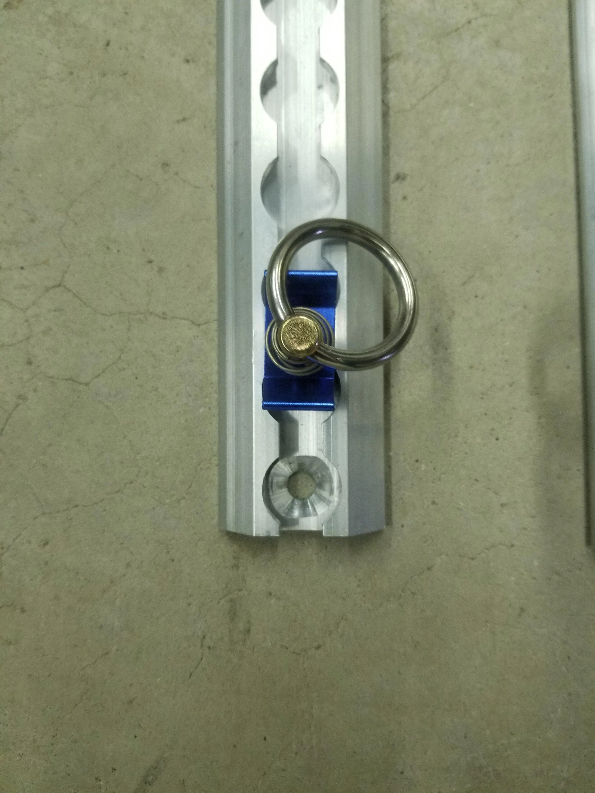

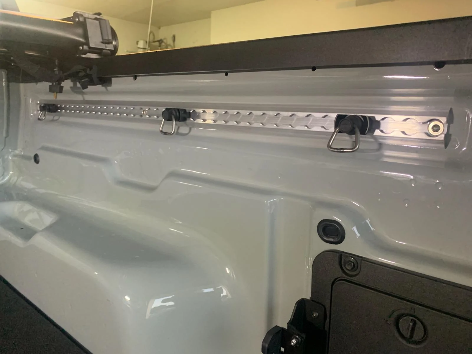

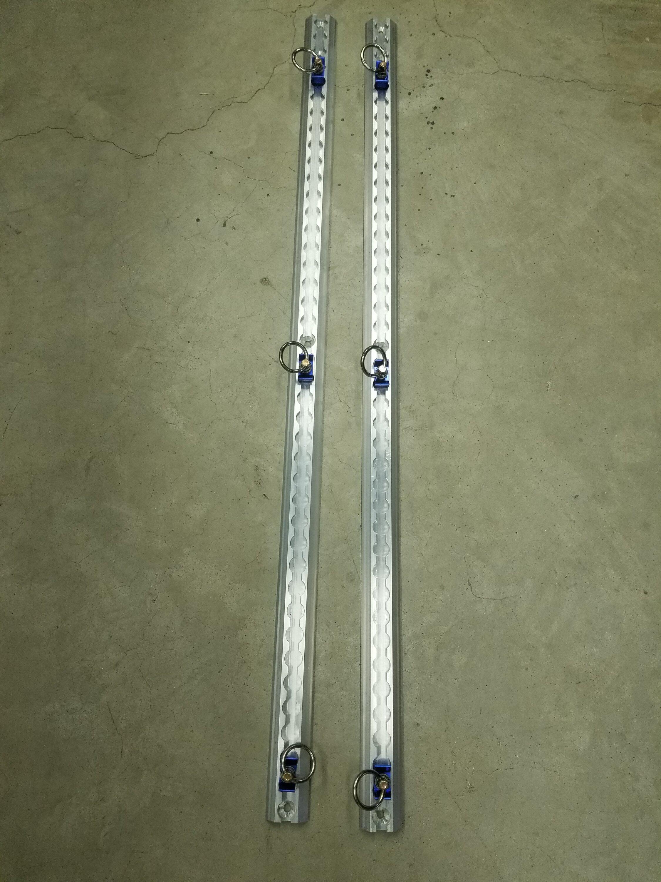

I made my own with commercial grade aircraft style L track. About $100

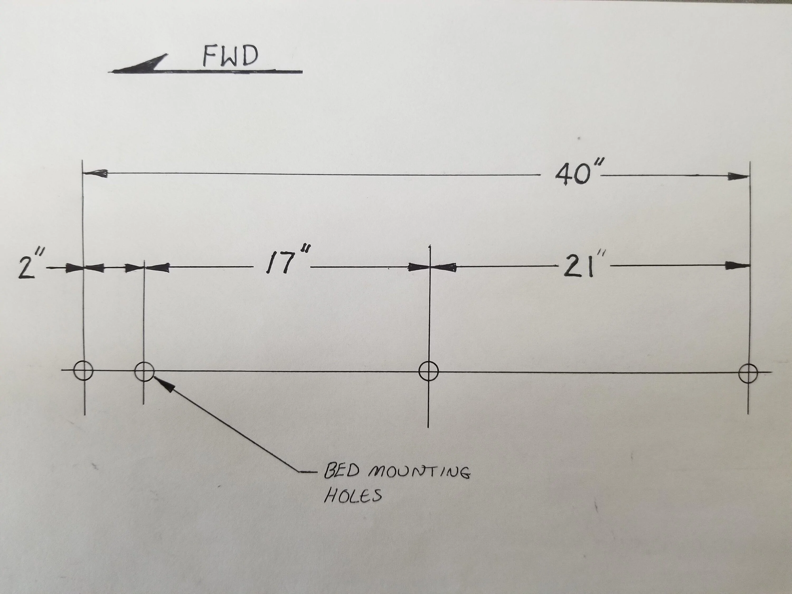

Looks good. Thanks for the template. What did you use for the screws? Assume flat head machine screw, length and thread?

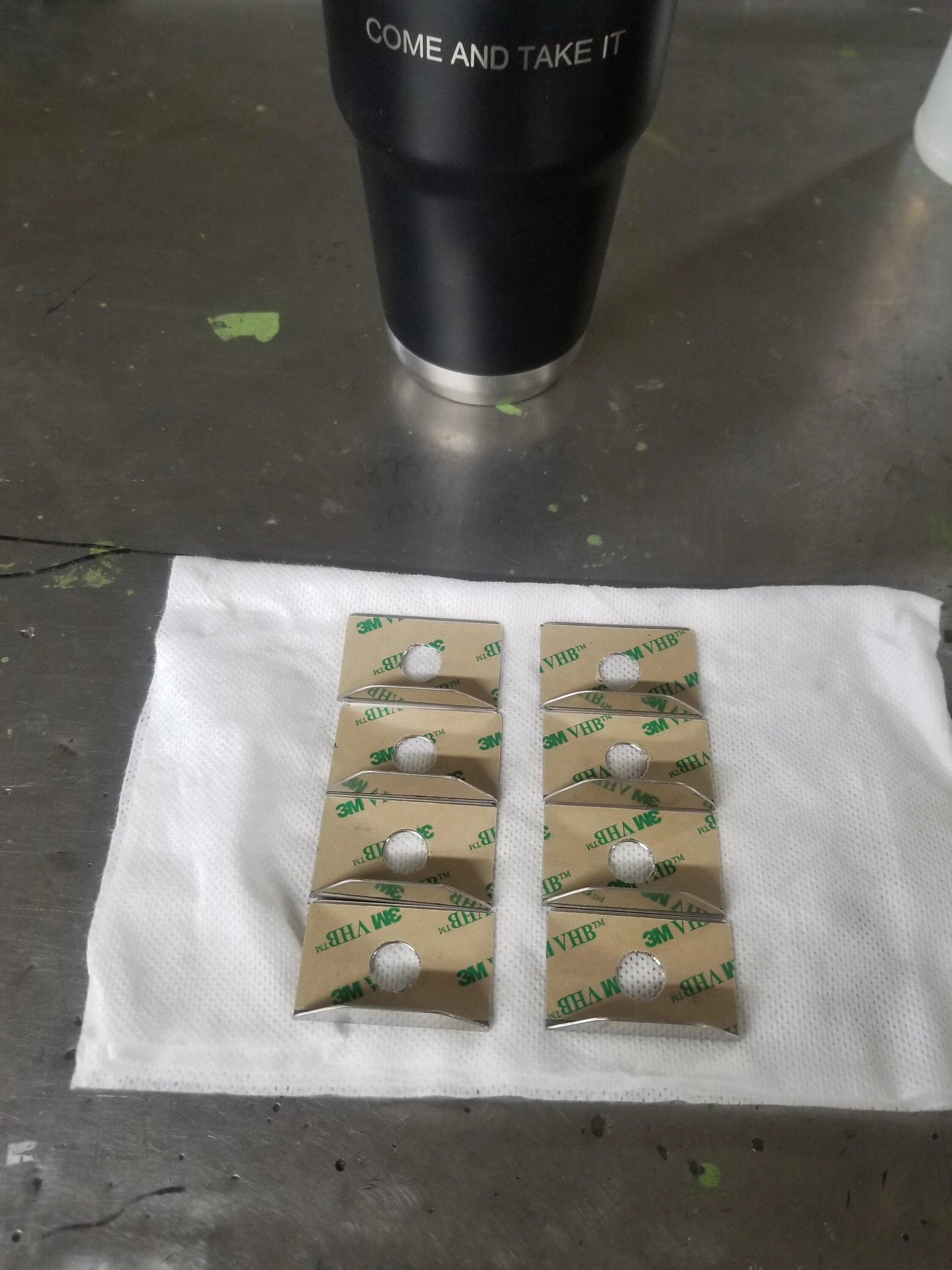

Stainless steel 90° countersink torx metric screws. I dont remember the MM # I used. Since front screw mounts are smaller thread. I did 2 screws instead one, and you just remove the cleats to install the track. I also made some end caps from .040" stainless steel. I had to spend $18 for a 90° countersink bit for the drill press to countersink these. Aircraft flush fasteners are 100° and 130° .
