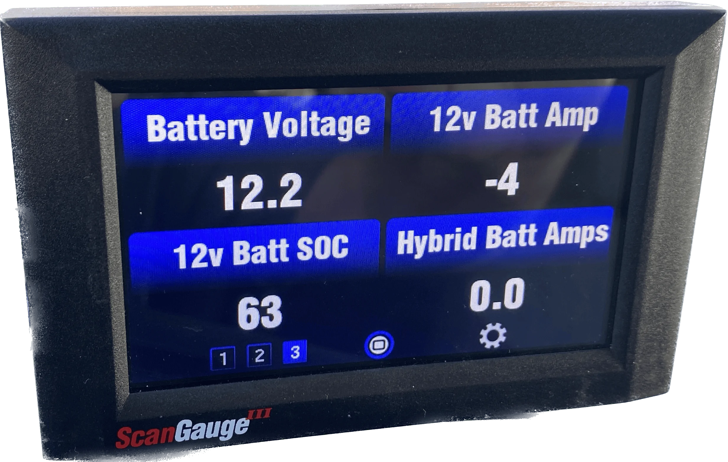

I dunno man.
What I know is I always see this.
To rule out a gauge error, ScanGauge sent me a second unit at no charge. It didn't change. So the value is real.
Ford Maverick Battery Monitoring System, BMS, settings in ForeScan... 1700172940431
Minutes after an hour drive.
