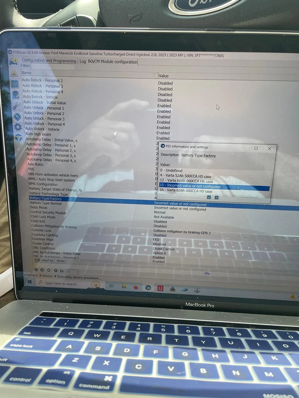

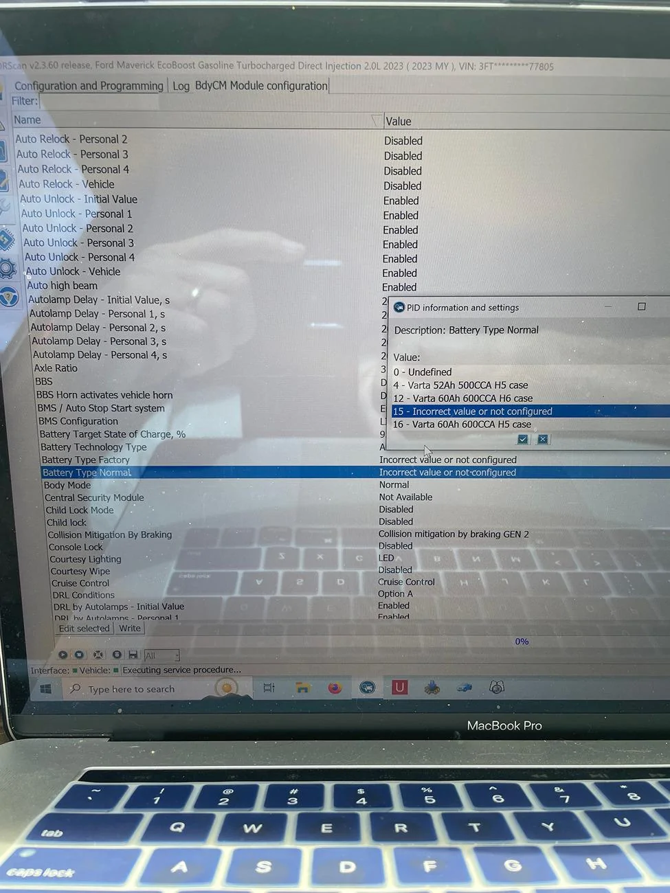

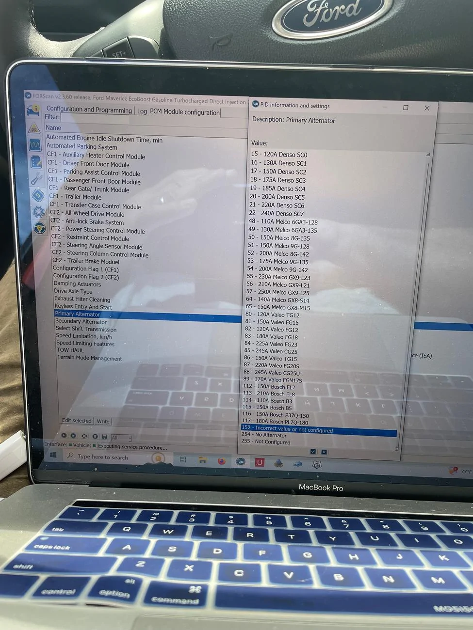

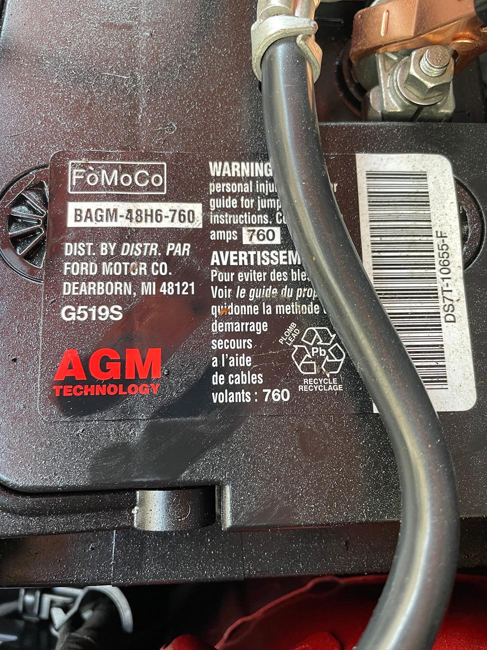

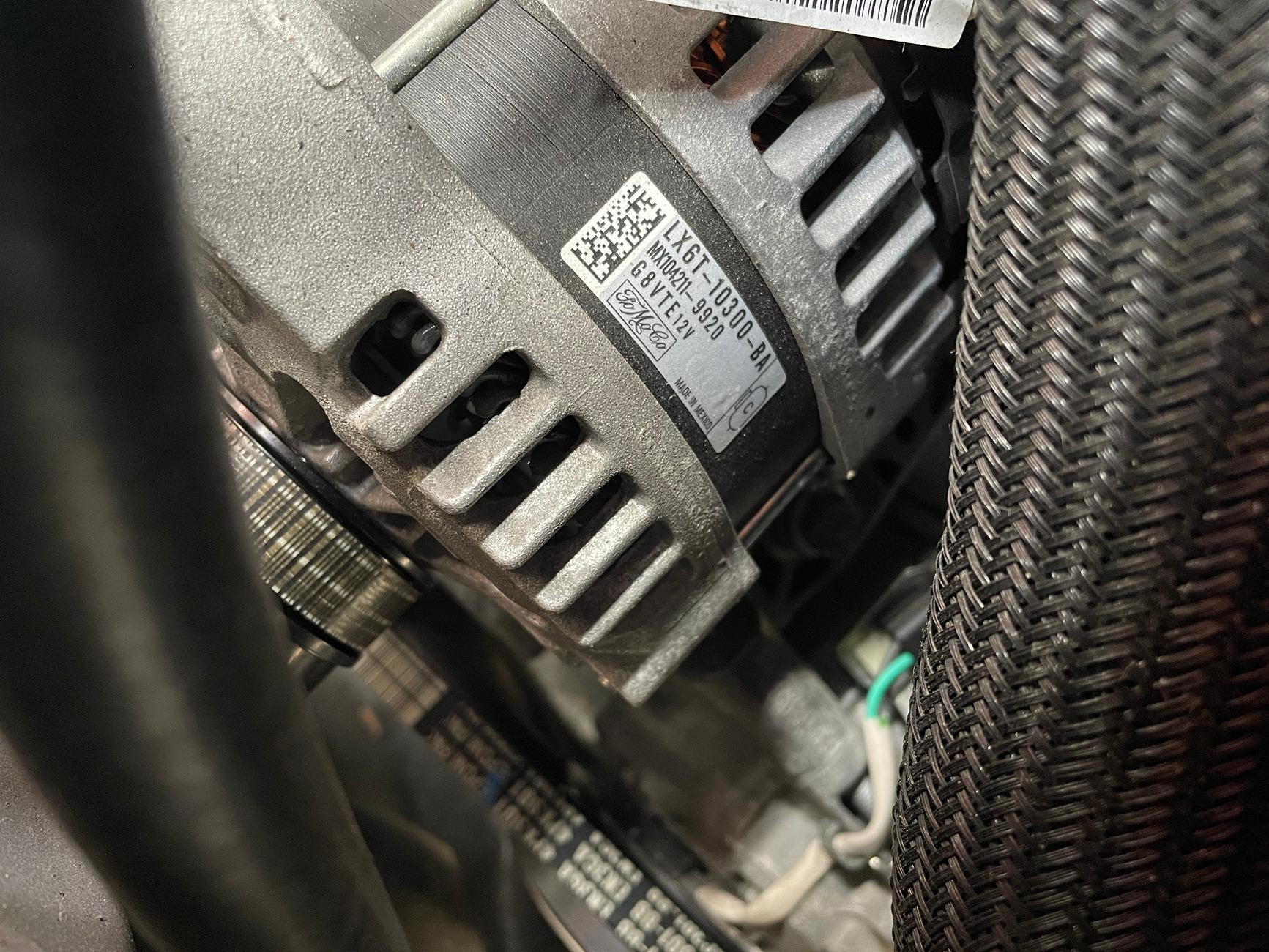

When looking in Forscan my battery and alternator settings are set to "Incorrect value or not configured". Just wondering if anyone has seen this and if I should change the settings.
I would change the settings if you know the correct values.
What model year ecoboost? My 22 has a non-AGM battery that does not get charged enough from the factory. I have not looked at the internal values, but should.
