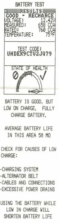

Instead of going back to the dealer, I've stopped by my mechanic's garage who did a battery test. Here's the result:

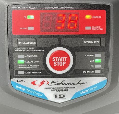

I didn't have time for waiting to charge the battery, but did it at home. My charger showed:

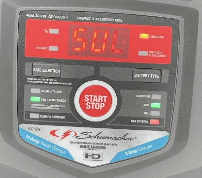

After about half an hour or so, the charger showed this:
What I've gathered, the charger started to charge, increased the voltage to the level to start the de-sulfation. At this point, the charger had been disconnected. Mainly since the landscapers came to clean the leaves from the ground and had to move the truck. One thing I've noticed while moving the truck; both the service panel and the infotainment system had been the brightest it ever had been for the last ten month.
Couple of questions...
Should I disconnect the battery from the truck to do the de-sulfation? The set radio stations are probably lost, but what other things I should be aware of?
Alternatively, Can I de-sulfate without disconnecting the battery?
Thx...
PS: Looking for another dealer service in my area, but at this point, it's hard to trust them...

Your charger was set to agm
I think the maverick has a standard lead acid battery.
Different termination voltage.
I'd try again with standard chosen.

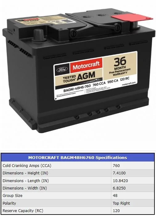

All car batteries have acid and lead, the exception is Lithium-Ion batteries...
I think you meant flooded battery, MY2023 has AGM battery:
I thought they had the regular flooded type stock. AGM is better I believe, that's pretty cool.

Ford's BMS usually only charges to around 80%, and the 12.42 volts on the tester would equal just over 75% SoC (depending upon temperature). Using CCA, 658 CCA of 760 CCA would indicate ~86% charge. - AGM batteries tend to have a slightly higher voltage than Flooded cell batteries. Subtract the electronics load for the post-run 45-ish minutes where the systems stay active, and 75% SoC is within the realm of possibility for a healthy system/battery. I watch my voltages/SoC using a small ultra low-draw BT device, its surprising how much draw the electronics have during that first 45 minutes after the ignition has been on, even if only briefly.
Motorcraft may have nearly the same battery as both AGM and Enhanced Flooded Cell, you might want to check your actual batter to confirm it indicates AGM. Most of us Hybrid owners have an Enhanced Flooded Cell, even though the system is set to AGM. - Supposed supply issues had Ford ultimately install the Flooded Cell in place of the AGM, but that's another can of worms. Apparently, some EB models came with AGM, other with the Enhanced Flood Cell substitute, so no guarantee it's AGM, unless is states AGM on the actual battery.
Yes, I did in #3 post in this thread, it is AGM battery:
https://www.mavericktruckclub.com/forum/threads/battery-charging-desulfation.39723/#post-711113
