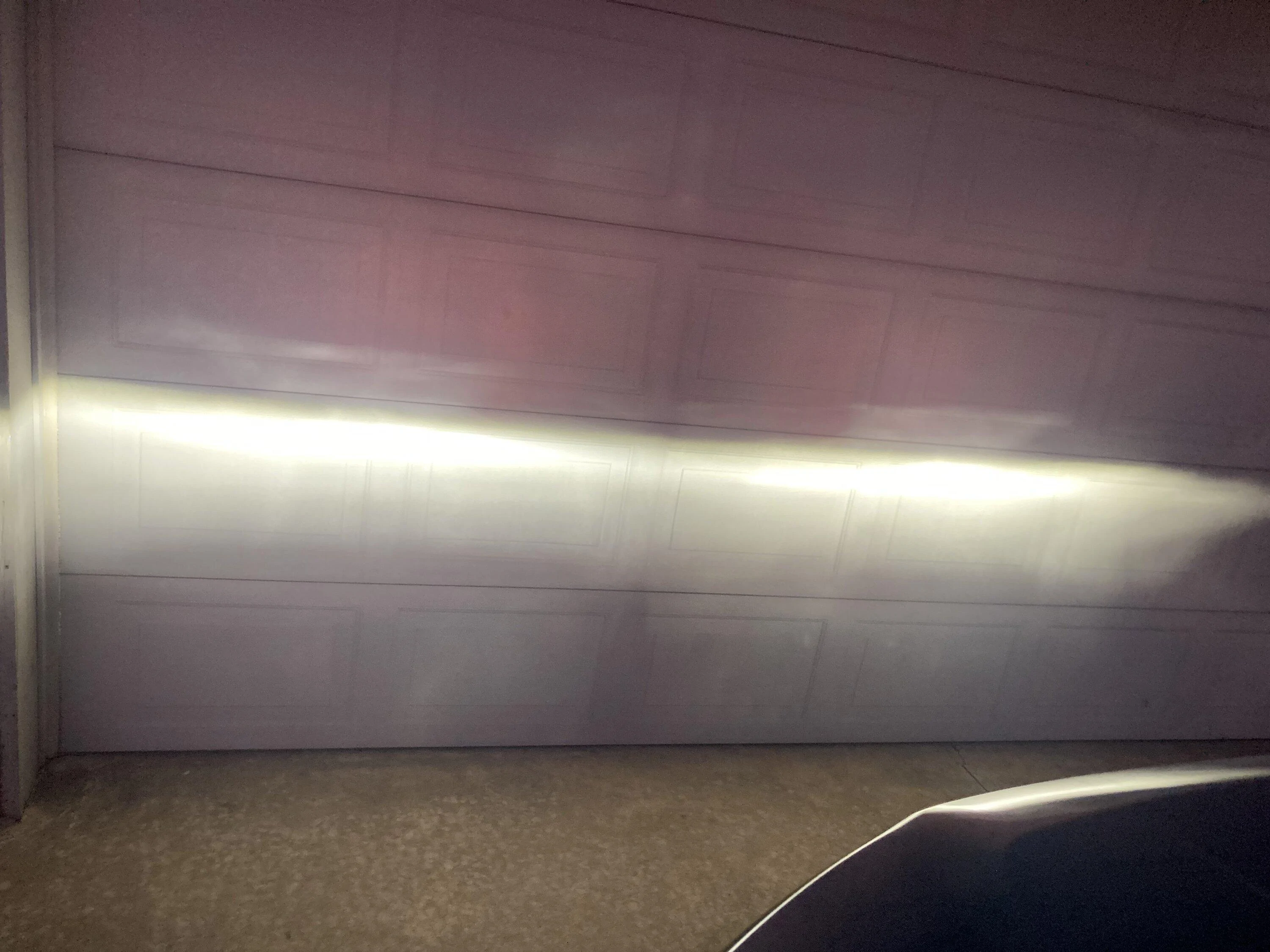

To help me understand the difference in headlights, what is left after the chrome comes off, just black plastic? And from what I see it is just the chrome trim and not the reflectors, so it doesn't affect the light output?
Correct, the reflectors are not touched. This is why the headlight needs to be opened, so that the reflectors are not touched.
On a separate thread, I posed a few photos of one of these modified headlights vs. an unmodified headlight and there was no difference in light output. I've reposted it below.
