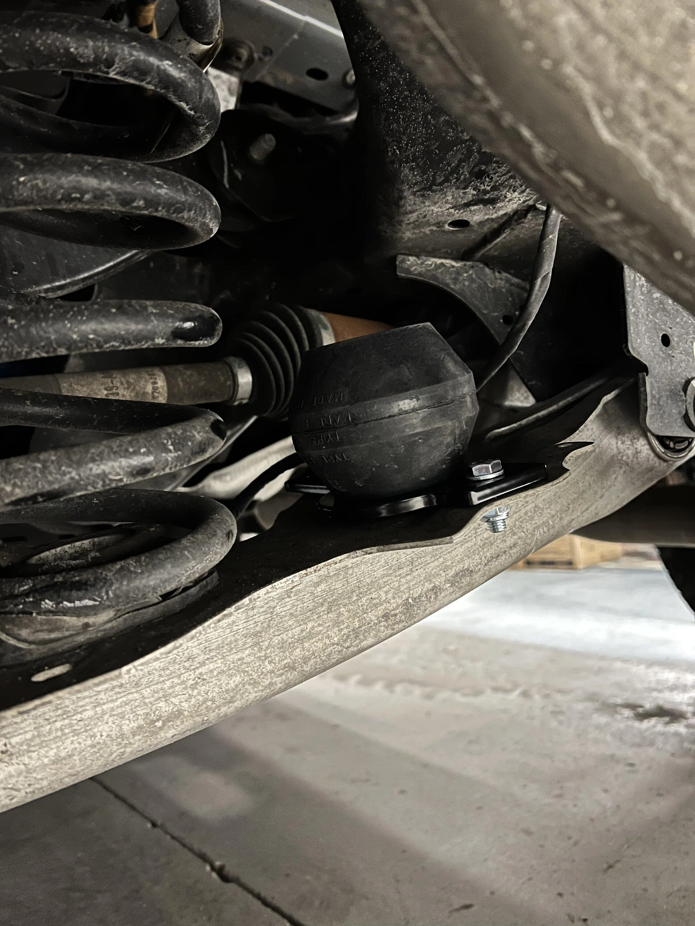

I have the Active Off-road bump stops on mine. Haven’t hit the fire roads and trails yet since I put them on but they’ve definitely soaked up a couple cringe inducing holes in my area’s “well maintained” roads. Also probably one of the easiest installing items ever.

Ya, the ease of install was....NICE! (if I had them, LOL)
