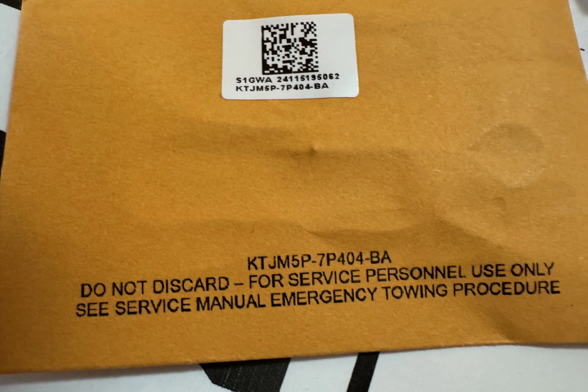

Just had LONE in for an oil change and found this in the rear door pocket when I got home. It's a sealed envelope and from the imprint appears to be a simple pin with a loop. Any ideas? Should I take it back? Or, put it in the glove box and forget about it?

Should have mentioned, it's only about 2.5 inches long and the weight of a heavy paperclip. Would have to be a very, very small Mav. :blush:

My recommendation is that you do not discard it, but save it in case you need emergency towing, and give it to service personnel if you do. I cannot divulge how I divined that information, though.

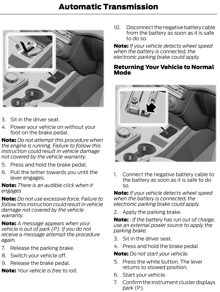

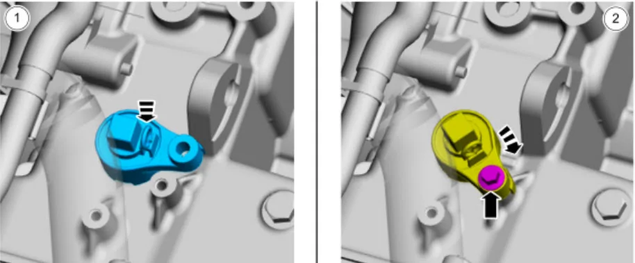

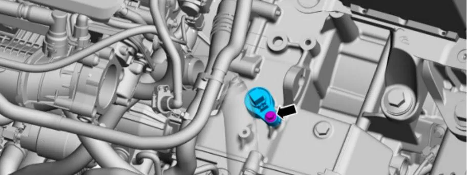

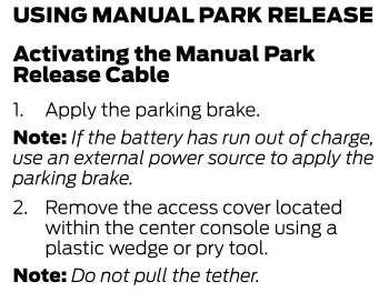

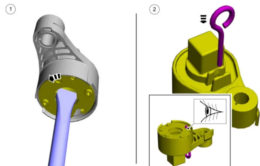

BlueSpec1 said:
I have the metal pin in my glove box and see the Manual Park Release on the Transmission.
Workshop Manual has the steps for using it to get the transmission into neutral:
Transmission Park by Wire Manual Release
Activation
1. NOTE: If the vehicle battery is dead or there is no electrical power available, connect an external power source.
Apply the parking brake.
2. Remove the air cleaner.
Refer to: Air Cleaner (303-12A Intake Air Distribution and Filtering - 2.0L EcoBoost (177kW/240PS) – MI4, Removal and Installation) .
3. Remove the bolt and the manual park release.
Ford Maverick Anyone know what's in this envelope? ve-manual-park-brake-release-from-transmission-jpg
4. Locate the park override pin inside the vehicle storage.
1. Rotate the inner override counter-clockwise until the pin can be installed through the top.
2. Make sure that the component is correctly installed. Use the General Equipment: Flat Headed Screw Driver
Ford Maverick Anyone know what's in this envelope? park-override-pin-install-rotate-ccw-jpg
1. Install the manual park release into the transmission.
2. Rotate the manual park release clockwise and install the bolt. Torque : 89 lb.in (10 Nm)
Ford Maverick Anyone know what's in this envelope? reinstall-manual-park-brake-release-jpg
7. NOTICE: Vehicle can roll if park brake is released.
NOTE: Transmission is now in neutral. Park system has been disengaged.
While applying the brakes, release the parking brake.
8. Disconnect the battery. The vehicle will remain in neutral for emergency towing purposes.
Refer to: Battery Disconnect and Connect (414-01 Battery, Mounting and Cables, General Procedures) .
9. When the repair is complete, connect the battery.
10. NOTE: If the vehicle battery is dead or there is no electrical power available, connect an external power source.
• Once the vehicle repairs have been made, remove the pin and the park system will activate.
Confirm the vehicle is in P and the IPC indicates P .
• Return the service pin to vehicle storage location.
12. Install the air cleaner.
13. While applying the brakes, release the parking brake.
