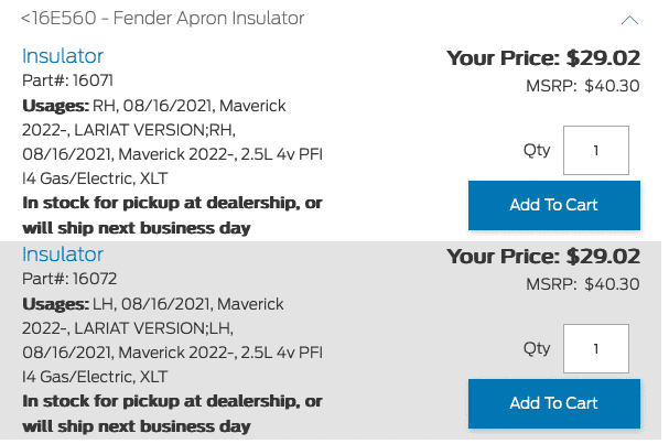

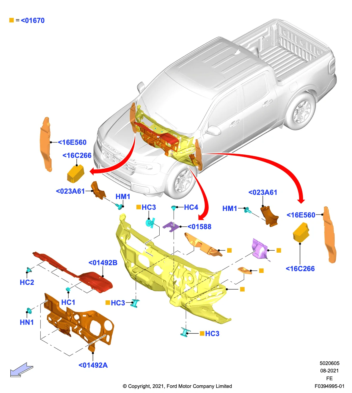

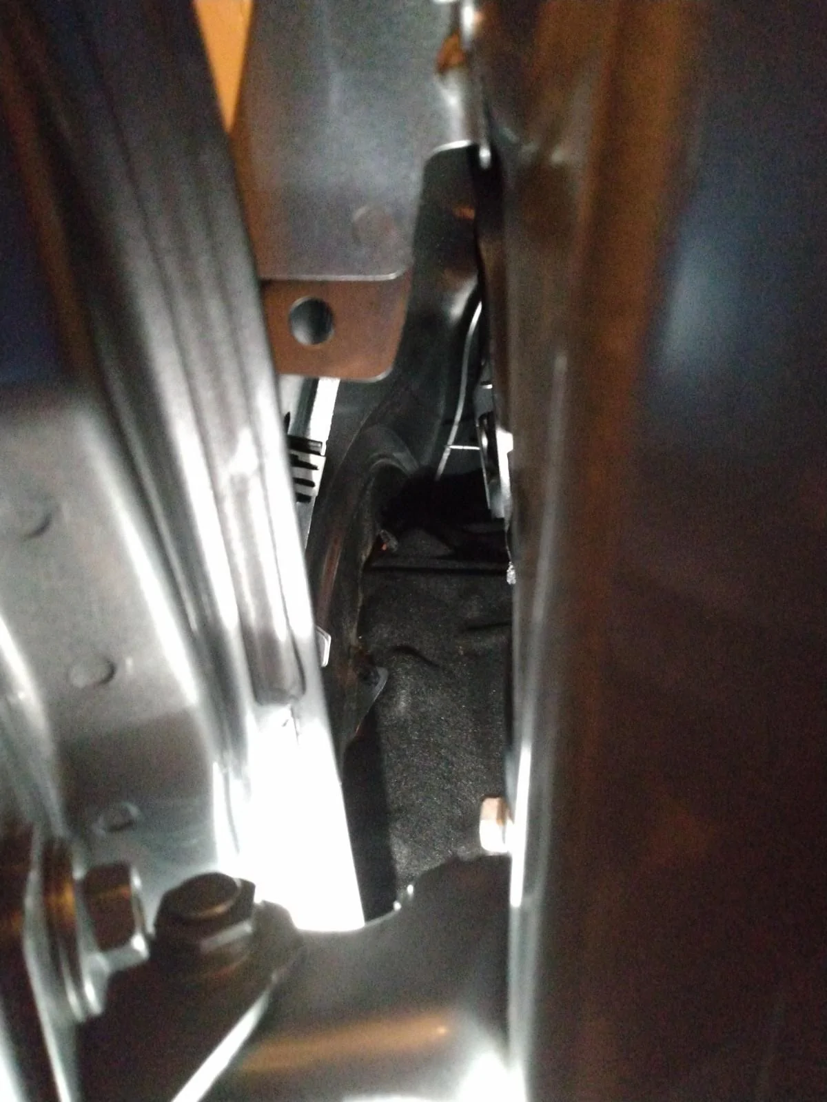

I am completely impressed with the build quality for the low price point. I have an XLT and there is a black plastic shroud between the door and fender. Can not see into the engine bay. Also front and rear tire wells are completely covered leaving little place for dirt to accumulate. I will be installing front and rear Ford splash guards to protect lower paint from stone and debris. I would try and locate an XL and see if it is set up like yours. A trip to the dealer will handle any other problems that you may think are service related
Your vehicle definitely has quality control issues. I checked my driver's door and shined a light into the area. There is a plastic-coated soft insulation panel so yours is missing. It should be resolved under warranty . Similarly, the flexible vinyl upholstery between the dash and steering column on mine is not fitted properly. I played with it and was able to push it into place. My biggest complaint is a low rumble from the dash when going over rough pavement. I was able to isolate one area in the lowest point in the center of the dash where the stop/start button and sliding window control is. I will look for fasteners to tighten. But the biggest dash noise is straight ahead of the steering wheel. I opened the hood and it isn't in the engine bay on the firewall. It is not the lens on the instrument cluster vibrating, it isn't the hood over the cluster, it is somewhere under the panel by the windshield - perhaps the defroster duct? I hate to have mechanics tear into the area and create other unintended problems. These are quality control issues and should not be there regardless of the cost or trim level of the vehicle. I see your point regarding the fender liners. Fortunately I live in a place that barely gets 10" of rain a year so rust etc. isn't an issue. Overall I enjoy the way it drives. I get better gas mileage using 87 octane in my 2.0L EB. We'll see when GM, Toyota and Honda bring similar vehicles to market how they compare in price and quality. Meanwhile Ford can sell all the Mav's it can make.
Any ideas how i can prove that they're missing? is there a tech document or exploded view somewhere that says it should be there? i tried my dealer and they said "the insulation is the way it is" - meaning they wont do shit about it unless i prove its missing. they also deflected pretty hard on fixing the upholstery and told me twice the upholstery guy was MIA, seems odd hed be gone 2 weeks in a row with no explanation.

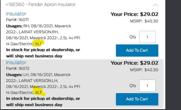

Not missing. You have an XLT, not a Lariat, so the Fender Apron Insulator is not included.

insulator-14199831-1https://parts.ford.com/shop/en/us/insulator-14199831-1?pdp=y#/sectionId:446281000
https://parts.ford.com/shop/en/us/insulator-14200619-1?pdp=y#sectionId:446281000

Awesome, thanks for clarifying
Edit: now that i opened your link, it says XLT right in the product description.
also this is for a hybrid, mine is eco boost.
True, it's worded a bit funny. Maybe it is supposed to come on both.
If installed, when you open the front doors and look forward, you'd see nothing but a piece of dark gray foam, rather than the engine bay.
Can't imagine it would be too difficult to install those if you had them, but it looks like it might rely on a couple other pieces to hold it in place.

Yes its a 20-30k truck so i shouldn't expect luxury. these are some of the build quality issues ive come across not even gotten through my first tank of gas.
1. There is no insulation between the engine and the cab. When i open my drivers door i can see inside my engine bay. Ill elaborate more on this later on.

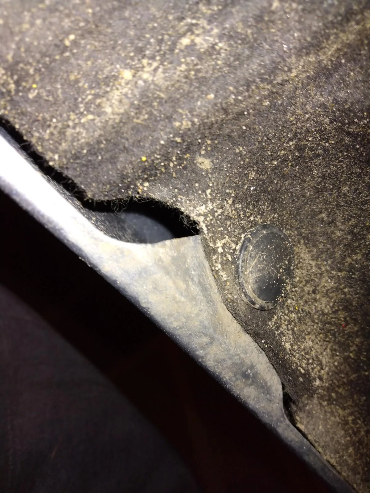

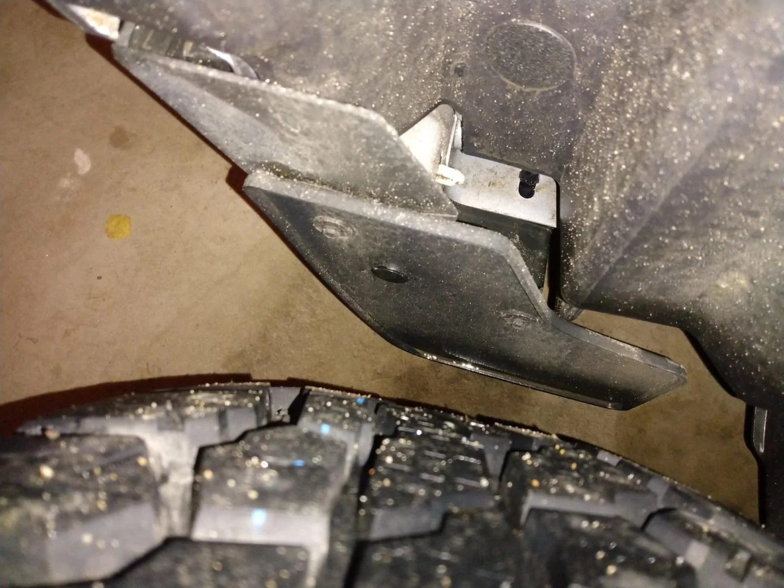

2. The fender liners dont align, mate, and cover the wheel well. tons of dirt, salt, etc gets up inside the engine bay from here and accelerates corrosion in hard to reach spaces, especially the pinch welds. Dirt and grime also easily migrates to the door seals, door wiring boot and can seep its way inside the frame.

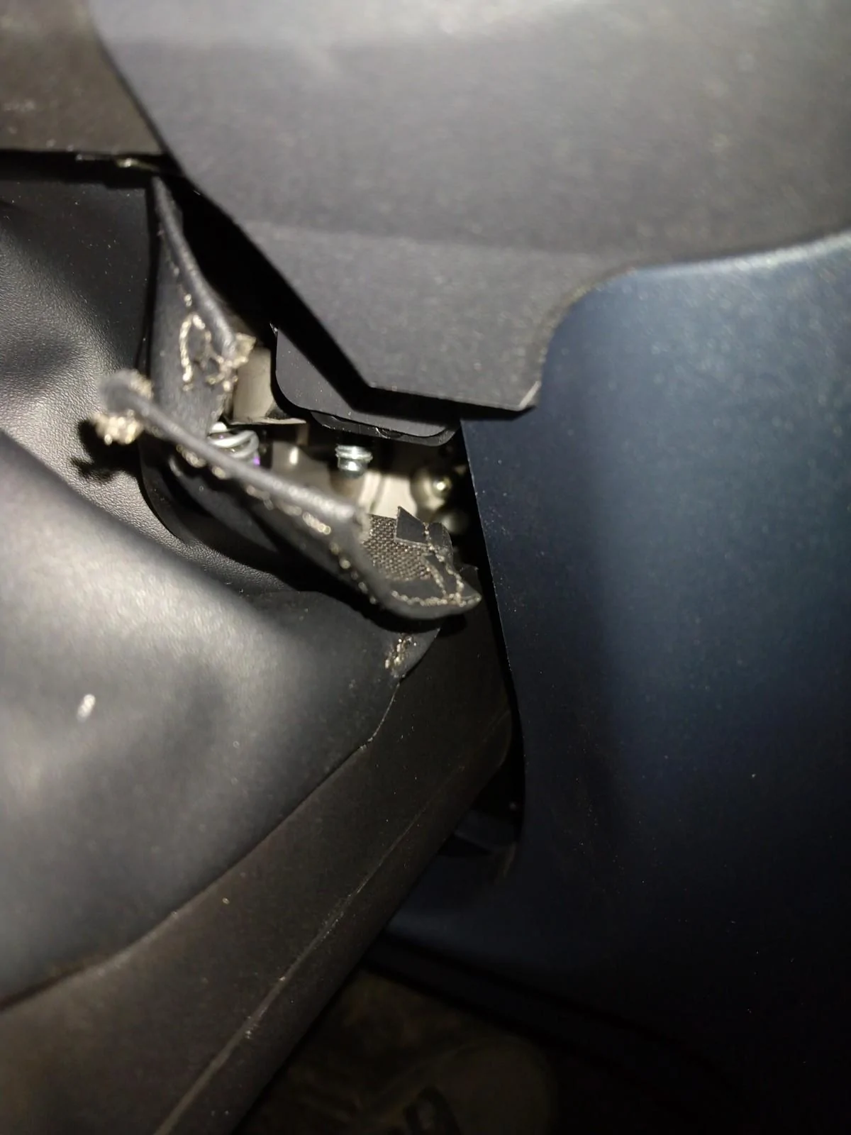

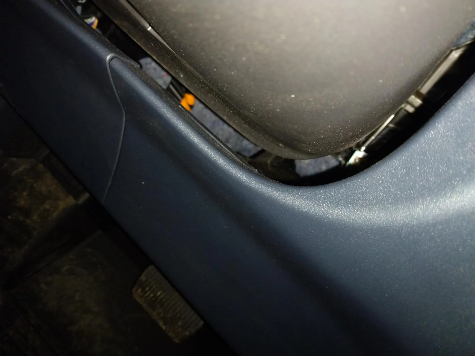

4. this one is a little more specific to me, The steering wheel upholstery is torn and not fitted well, you can easily see inside the steering column into the engine bay.
besides the torn upholstery are these same issues on everyone else mavericks? or worth raising a warranty claim?. Anyone else have things they've noticed?

3. The rear wheel well fender liner and splash guard doesnt cover or protect the rocker panel and the wheel constantly shoves water and dirt into it accelerating corrosion. i dont think there is a product that could even help this as theres just to much water flow.
