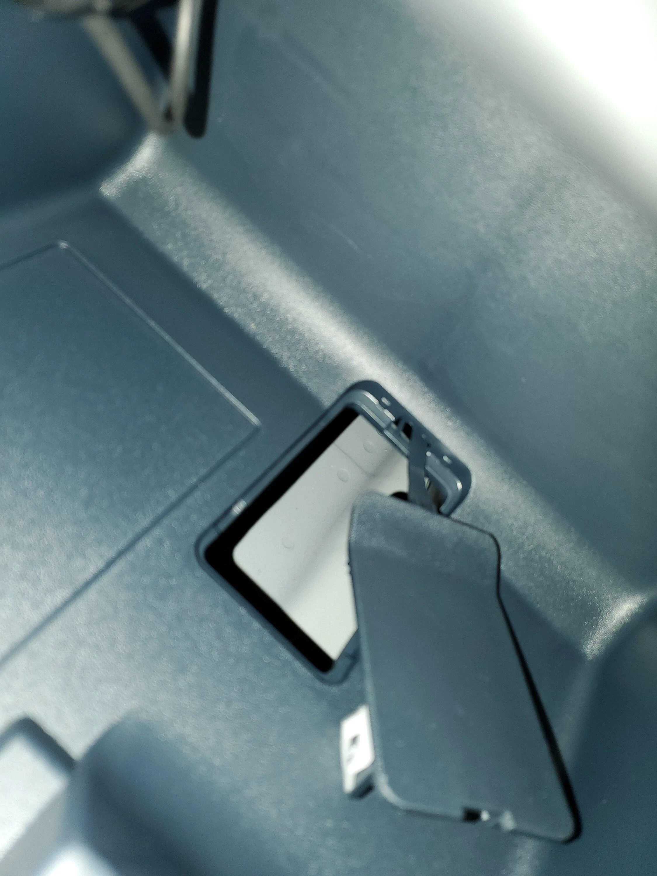

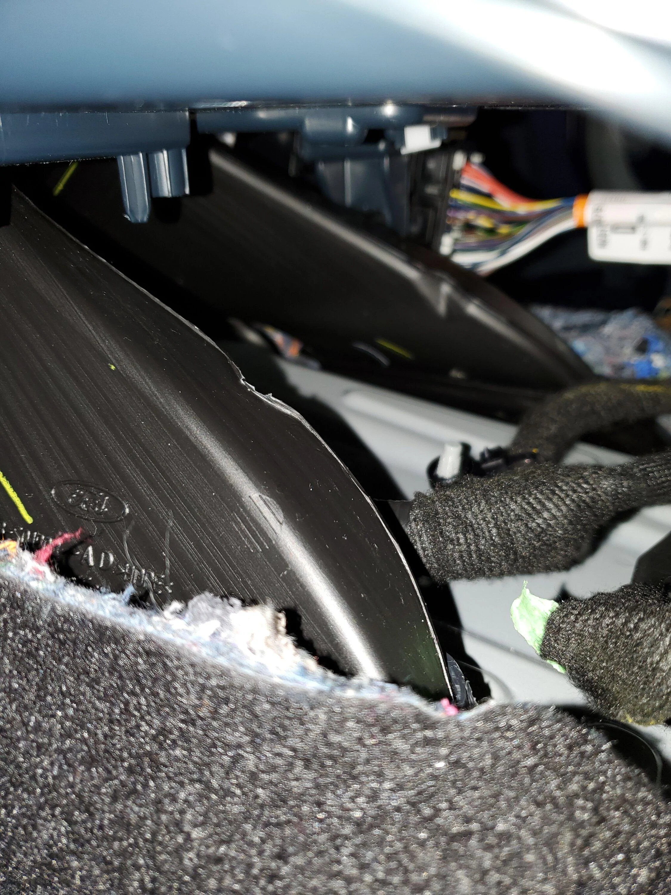

I was looking into putting an induction charger down on the center console where it's installed on the Lariat. I remember seeing that Park release tether in some other posts and I noticed that I don't have one? Pulled both side panels to investigate and can't find a tether anywhere. Anyone else confirm if they have it or not? Seems like a big deal if it's not there and I get towed.

Wanted to bump this. My vehicle definitely doesn't have the manual park release. I think they produced some without it and people should know. Have no idea how to put it in Neutral if the transmission is broken.

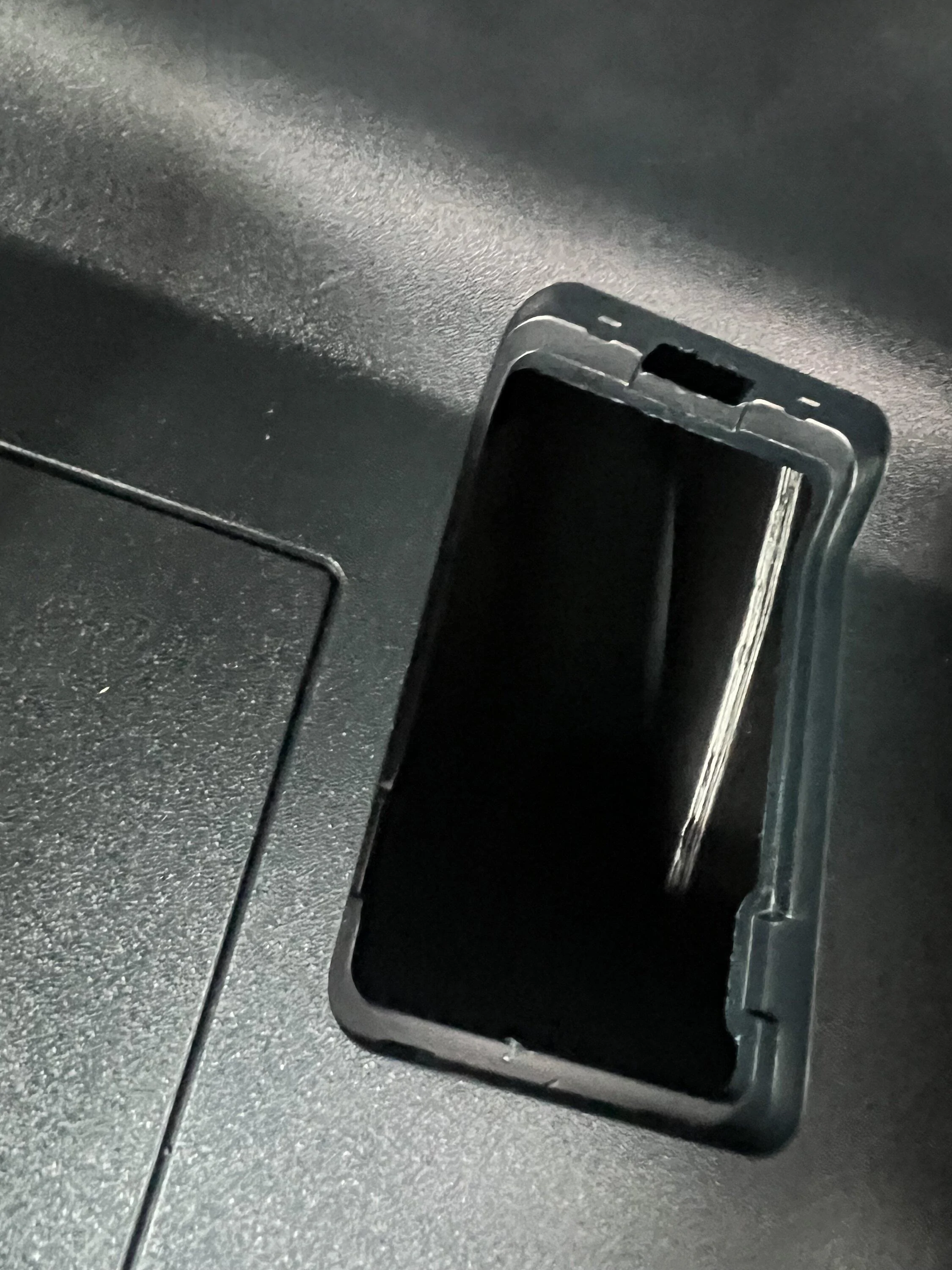

We’re missing ours. Do you know if it was a manufacturing issue or something that was supposed to be installed by the dealership? They have us bouncing back and forward between the two…we’re missing some other stuff too

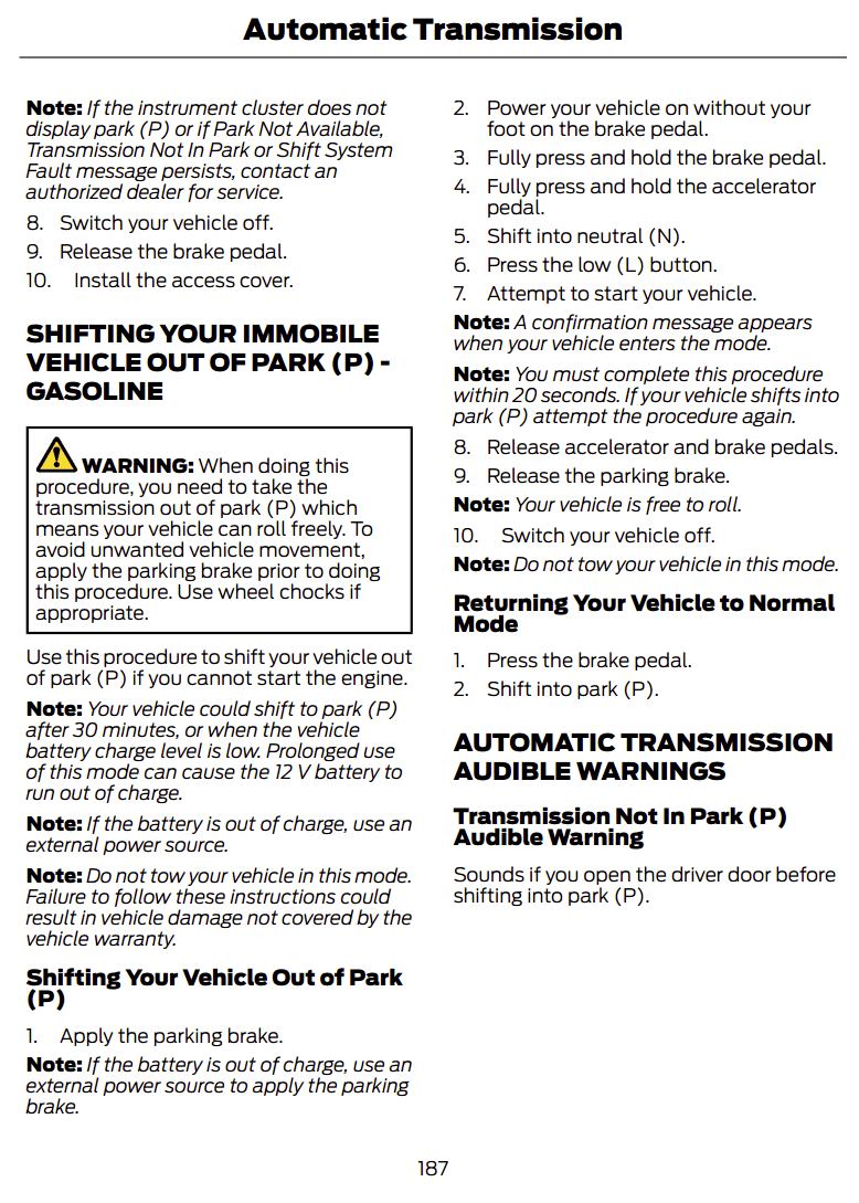

Looks like the park release has been moved.
Or the park release had been changed for the EB 2.0; from page 187 from the manual:
