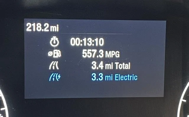

Ok, the "idea" of grid charging or solar charging a HEV like Maverick is starting to look less and less crazy.
As is, unmodified, I can go 3.3 miles in pure EV mode keeping it under 35 mph.
Plenty for a lunch run from work.
Plenty for most to pick up the kids at the neighborhood school.
I just went 2 1/4 miles on a less than full battery. Hmm.... if cheap enough, didn't mess up the "computers" and had reasonable installation procedure, not such a crazy idea for city dwellers. May decrease MY gas use per month by 25% just with the stock battery.
