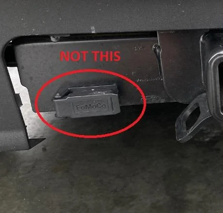

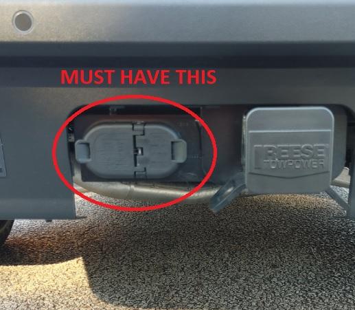

Check if it has the four pin connector or the seven pin connector next to the hitch.
The 4K tow package has the seven pin connector because of the trailer brake controller. All other ones with the hitch have the four pin connector.

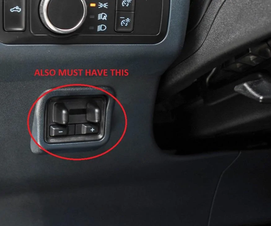

2000 lb tow package: 4-pin wiring harness next to the hitch, no trailer brake controler
4000 lb tow package: 7-pin wiring harness next to the hitch, trailer brake controller with controls near the headlight switch
You can also check the window sticker if available.
