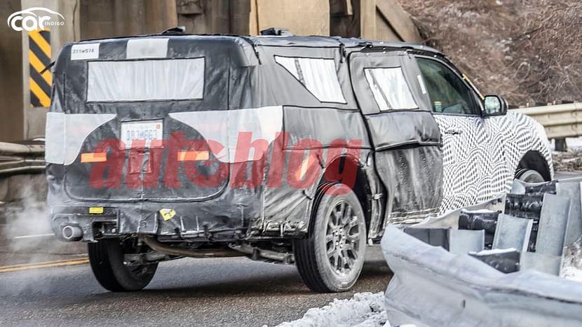

Ford Maverick Another remote start gone wrong, GLOWING CAT 422ac6efd049dc874690459b2897f1b
EB appeared to be testing in the cold.
Seriously hope they COLD WEATHER TESTED the Hybrid also *FACEPALM*
