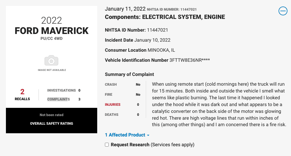

I got in my Mav, which I had remote started about 10 min earlier, and noticed the sulfur smell, so I hopped out and looked at my catalytic converter. This is what I found:
Follow up video with engine off 20 min later:
Truck was started with climate control set to max defrost. I've only noticed the smell with heat turned up high. Normally I set it to 60 degrees, and I don't have the problem, although I do get the weird revving engine sound while it's running after being remote started.
What do I do next? Is Ford going to do a recall, or do people's homes need to burn down first?
