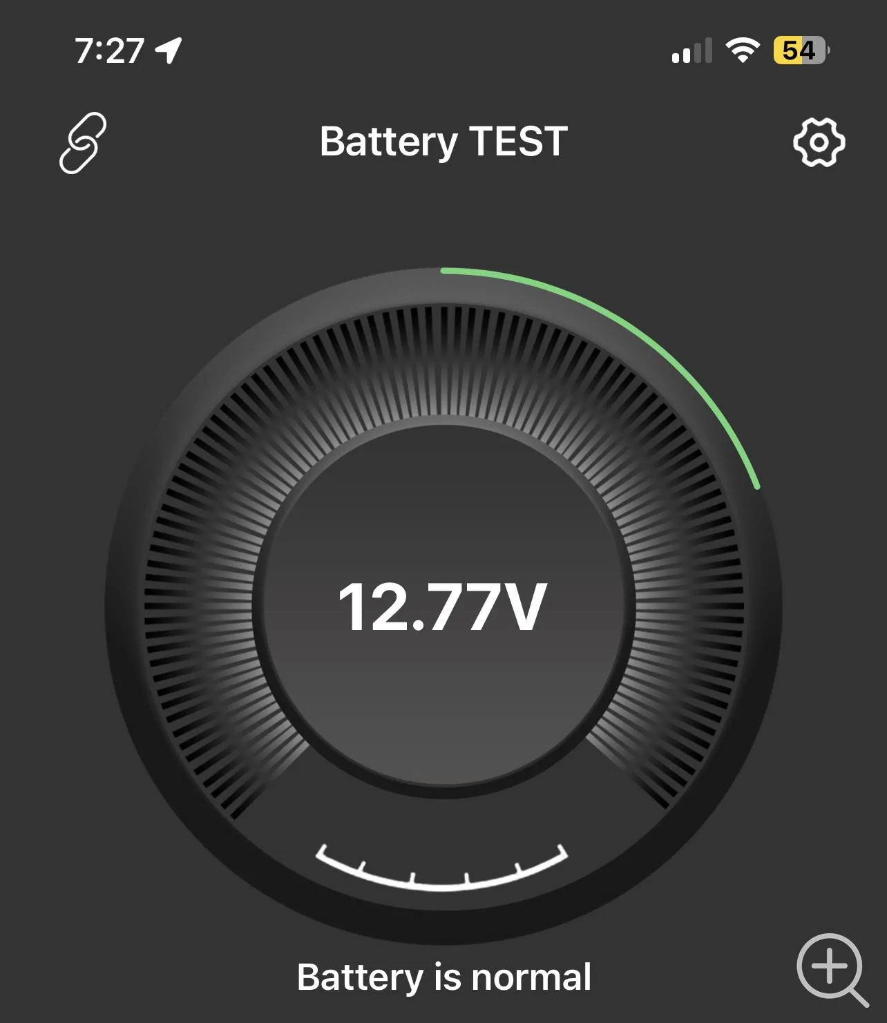

I picked up my 23 XLT Hybrid one month ago - after 17 months of waiting - and have since had 2 completely dead batteries. Both times I had to jump start my truck with my Noco GB40 and thankfully both times it worked. The first thing I wanted to figure out was whether or not my battery itself was weak/defective. I bought a multimeter and after multiple tests I continue to show a strong 12.6V to 13-14V with the key ignition on.
