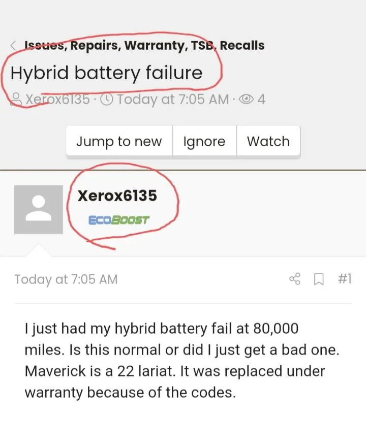

There is no Hybrid battery in an EcoBoost. The 12 volt EcoBoost battery is situated in the engine compartment
Unless of course you've mislabeled your profile and you actually own a hybrid in which there are two batteries a high voltage Hybrid battery, located on the rear driver side under the truck and a 12 volt battery contained inside the passenger compartment underneath the rear bench seat.

Is that the high-voltage battery under the body or is that the 12V battery?
The 12V battery is pretty common because of the misprogramming, but the HVB is extremely rare. The 12V battery is covered by the 3/36 bumper-to-bumper warranty, and the HVB is covered by the 8/100 hybrid components warranty.

I'm confused.
Doesn't the OP "Xerox6135" own an EcoBoost?
See post #1 & #2
