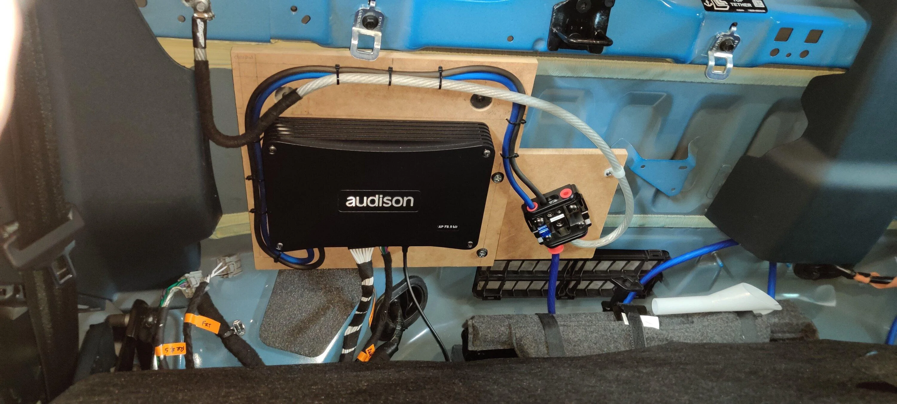

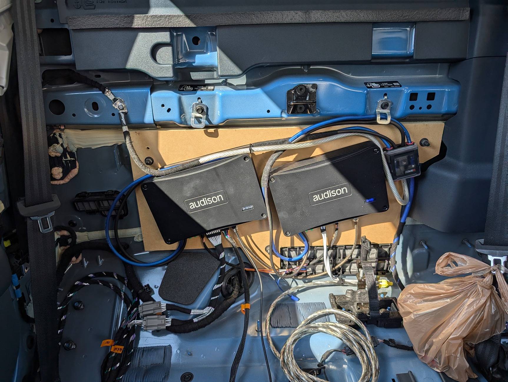

I bought both the Llj and plugnplay harnesses. Ended up using the hu adaptor harness and then built my own input and output harnesses from the pieces. I stripped the speed wire and twisted the cable for the speaker input and bought 16AWG TXL wire and twisted it for the amp outputs. Power kit is a Stinger 4 AWG. Used a Bussman circuit breaker and crimped eyelets for those connections. Connectors are Molex mini fit JR and Yazaki YESC 2.8. Used Tesa 51816 and 51036 for the covering tape. There’s just enough room in the sill wire harness troughs to fits everything.
https://www.mavericktruckclub.com/forum/threads/factory-integration-stereo-wiring-harnesses.9880/

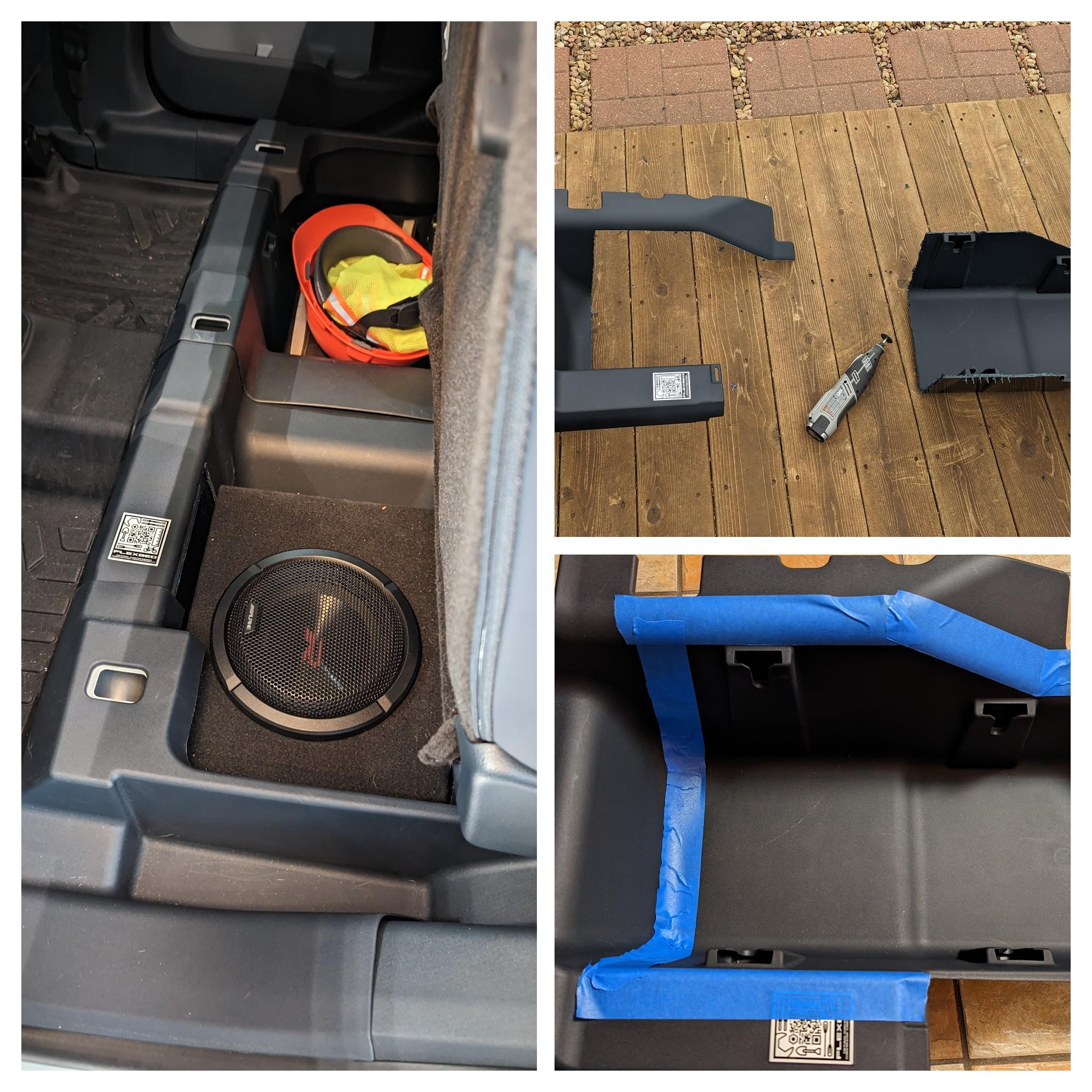

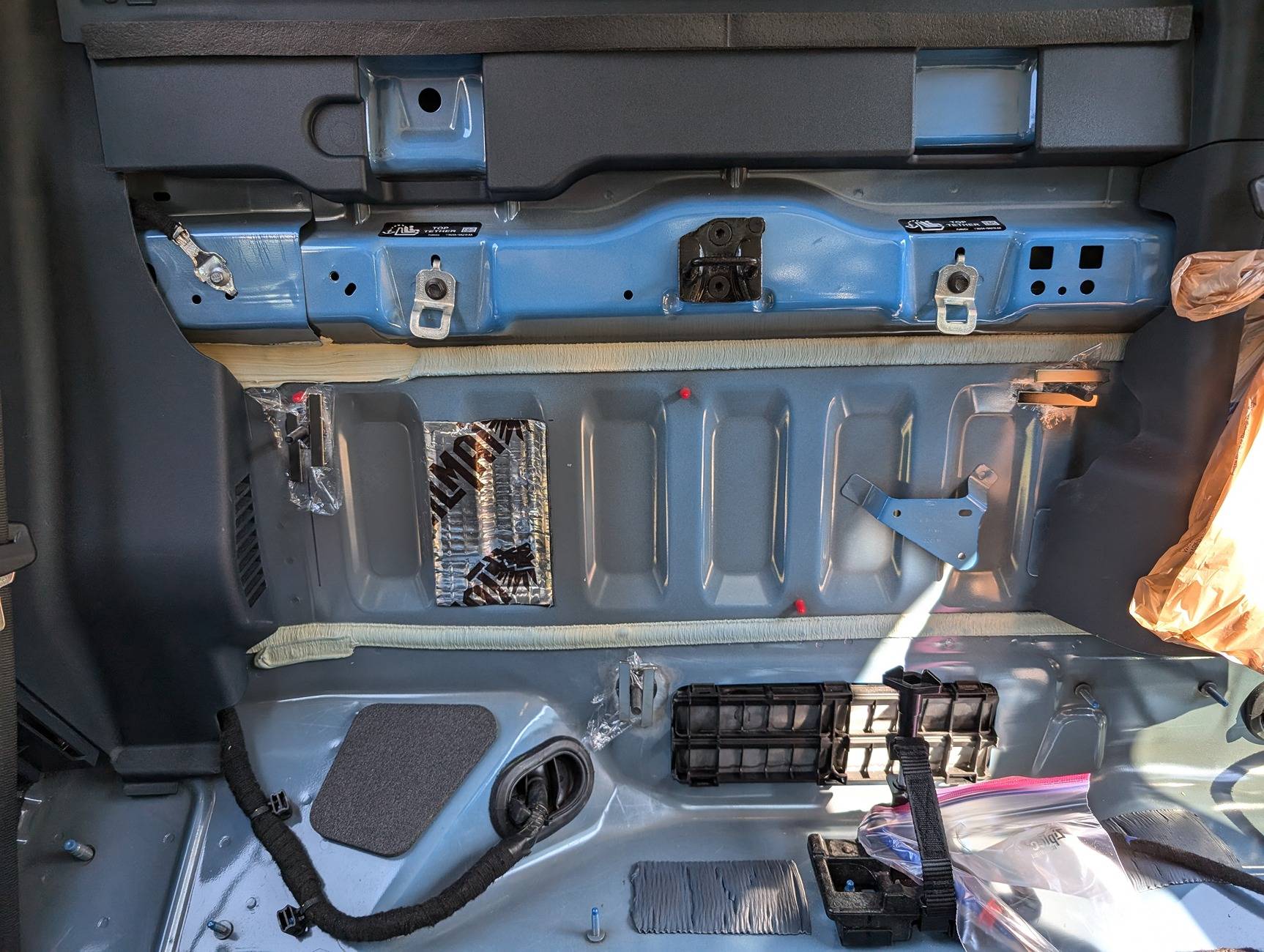

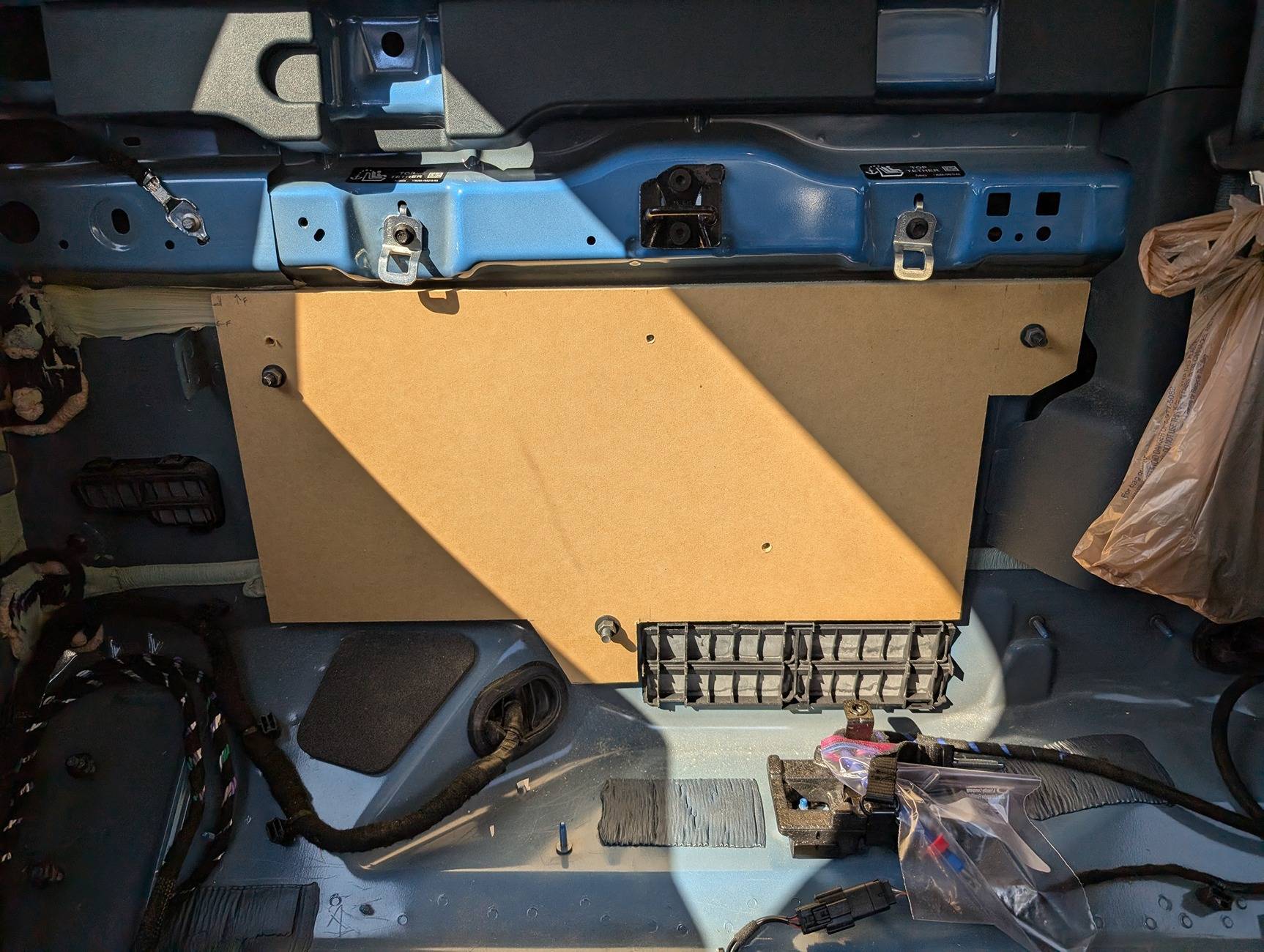

Sub is a JL micro sub cp108-w3v3. Box is 18.5 in long, 11in wide, and 5.125 in tall. Fits perfectly after removing the tub. Harness was purchased and then highly customized. Didn’t want to use a single connector - split it into multiple parts to make updates easy.
Is it hard to remove the tub? Is it reversible?
very easy with plastic trim removal tools (you can get them on amazon). you start on the part that is above the door sill and work backwards. after you know how it's done, you probably can pull them off with your fingers.
you can cut the bottom out of the tub so that you don't have a gap. I ran without a tub for a while, then when I realized it was <$150 for a new tub (if the next owner even cares, or I decide to pull the sub and keep it), I modified it. it would be prettier if I had not cut so high, but you have to cut out the FITS tabs or you won't have the clearance.
