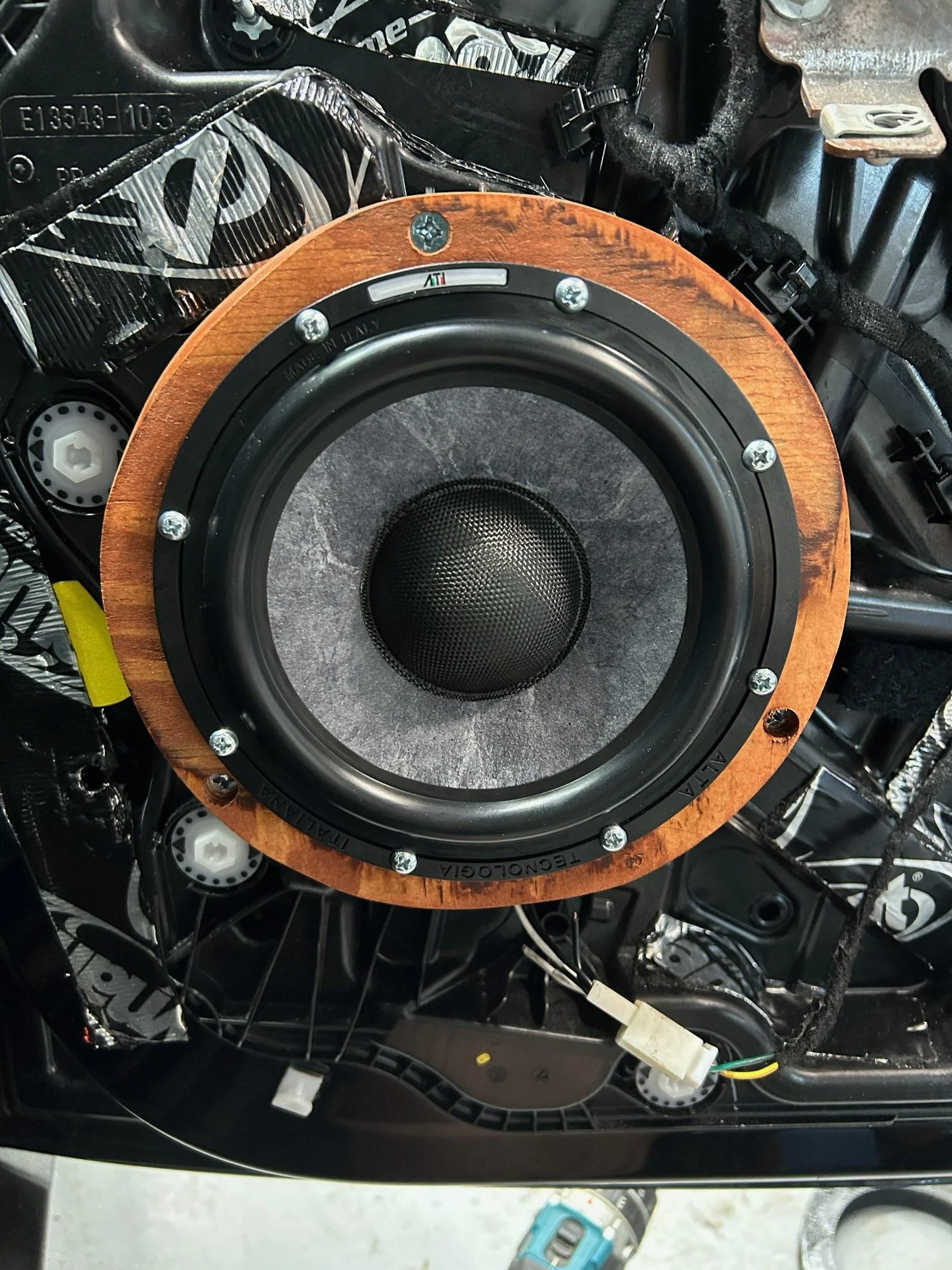

looking good! Do you have pics of what all you sound deadened for the front doors? Also where did you mount the crossover? I have a few other questions but don’t want to hit you with them all in this post lol.

I don't yet, but I will when I rip out all the mega zorbe around Christmas time. I don't have crossovers either as I am running active with the focal DSP. I don't mind questions either so have at them

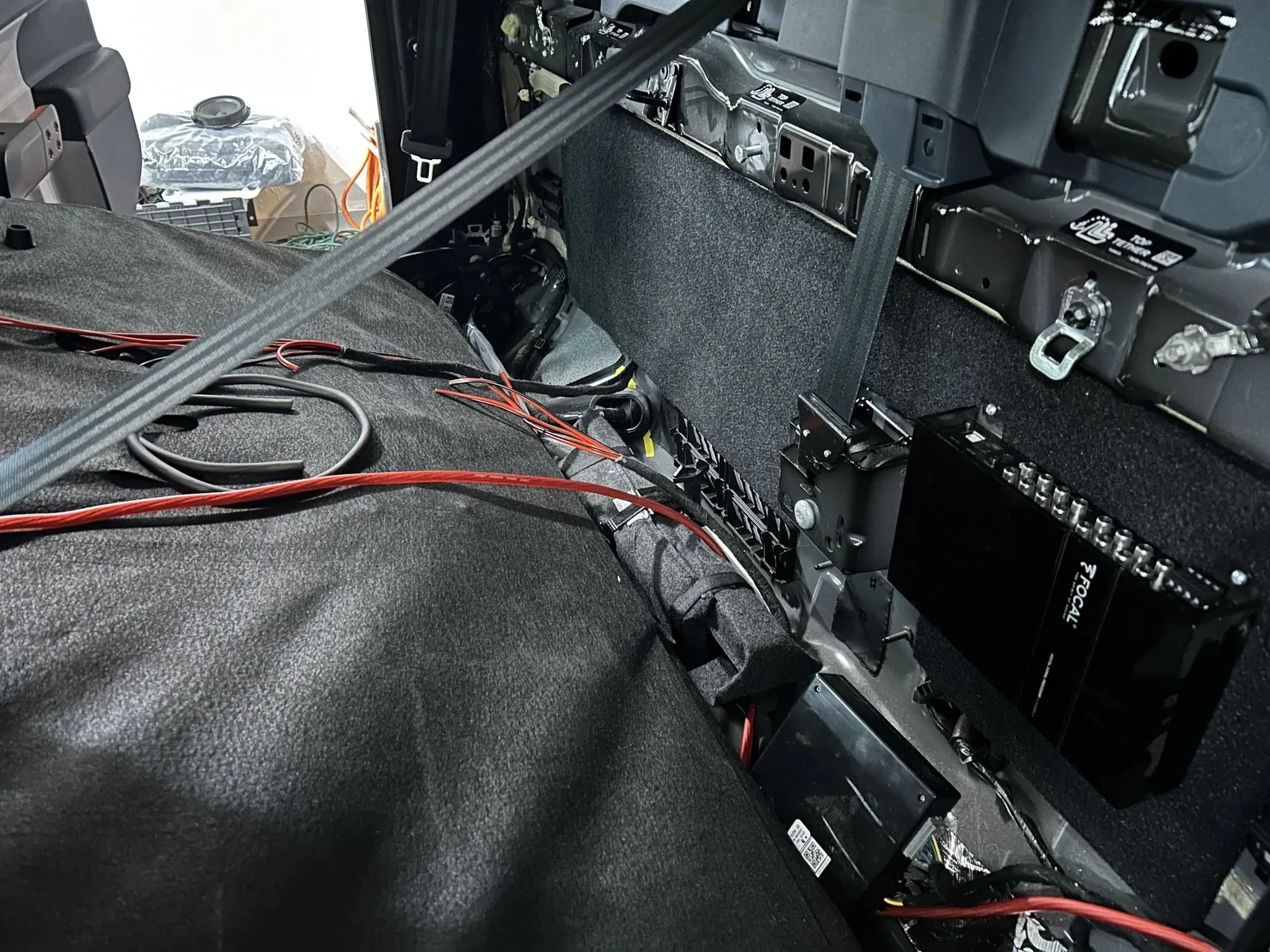

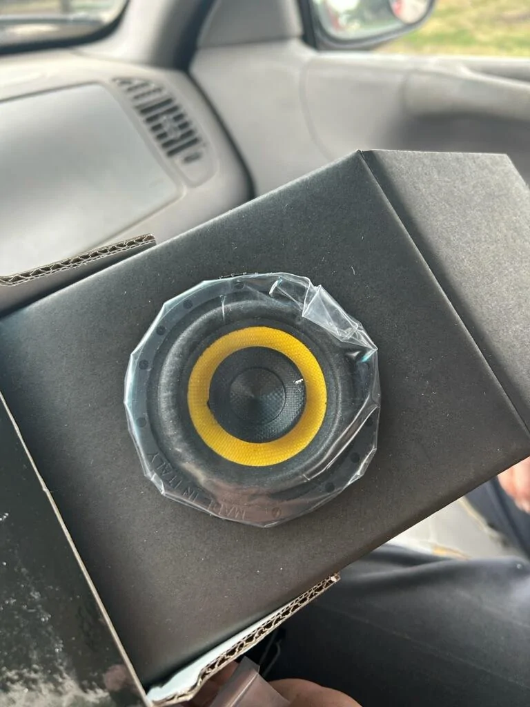

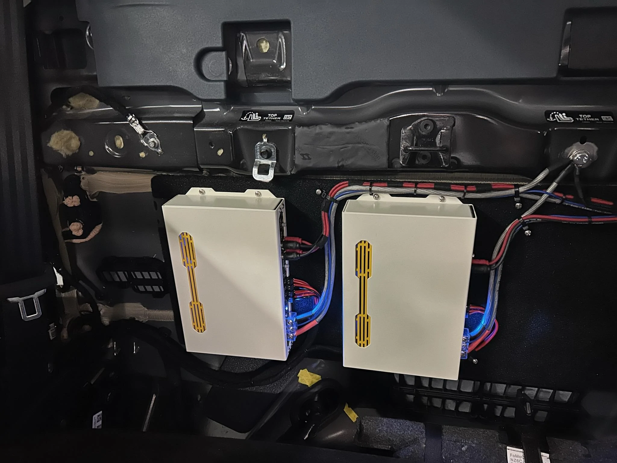

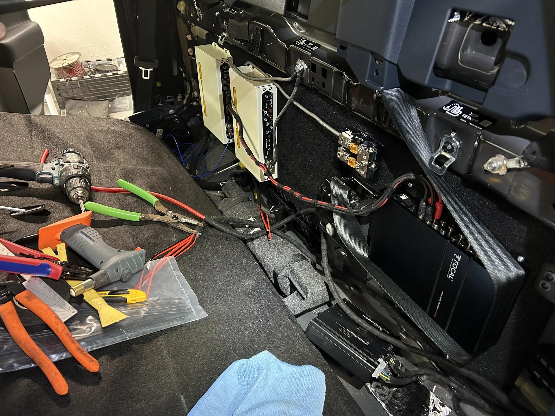

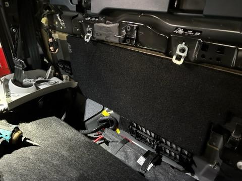

So here are some more pictures of the build and figured I would give a little more information on it so I am running two modified Italia Hifi 4-channel amplifiers (modified by David at sound express), ATI Telesto two-way in the front which is same family as Italia hifi and PHD but is their prototype/experiments brand, PHD Coaxials in the rear which will be getting changed out to some either Italia hifi or ATI if I can get my hands on some very limited edition 5 1/4 coaxials they have, and a Focal DSP for all the processing.

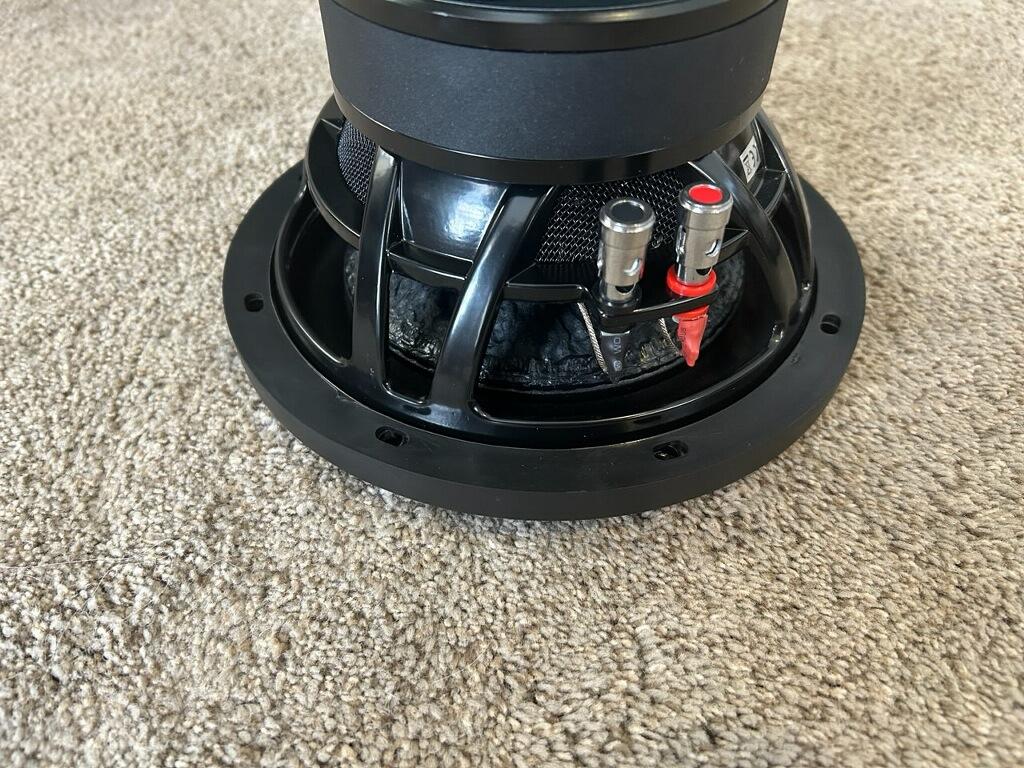

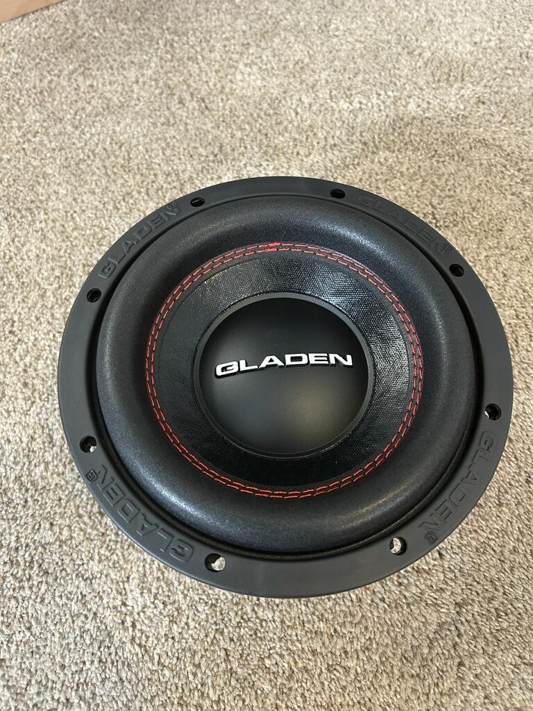

I will be custom building a box for dual 8's I already have a couple gladen rs x 08 that I got as a deal with them and then I will be getting a couple Telesto 8's as well to test out and see which I like more. I already have my modified mono block from Italia hifi as well. I will be going to a 3 way and I went and bought a PHD studio line 2.5' wmt wideband as well. Will be doing that Christmas break as well.

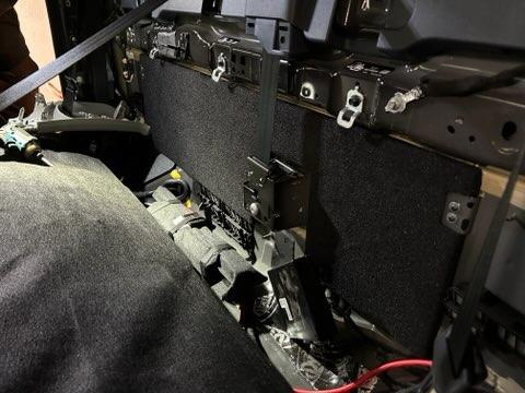

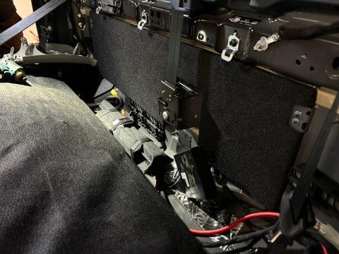

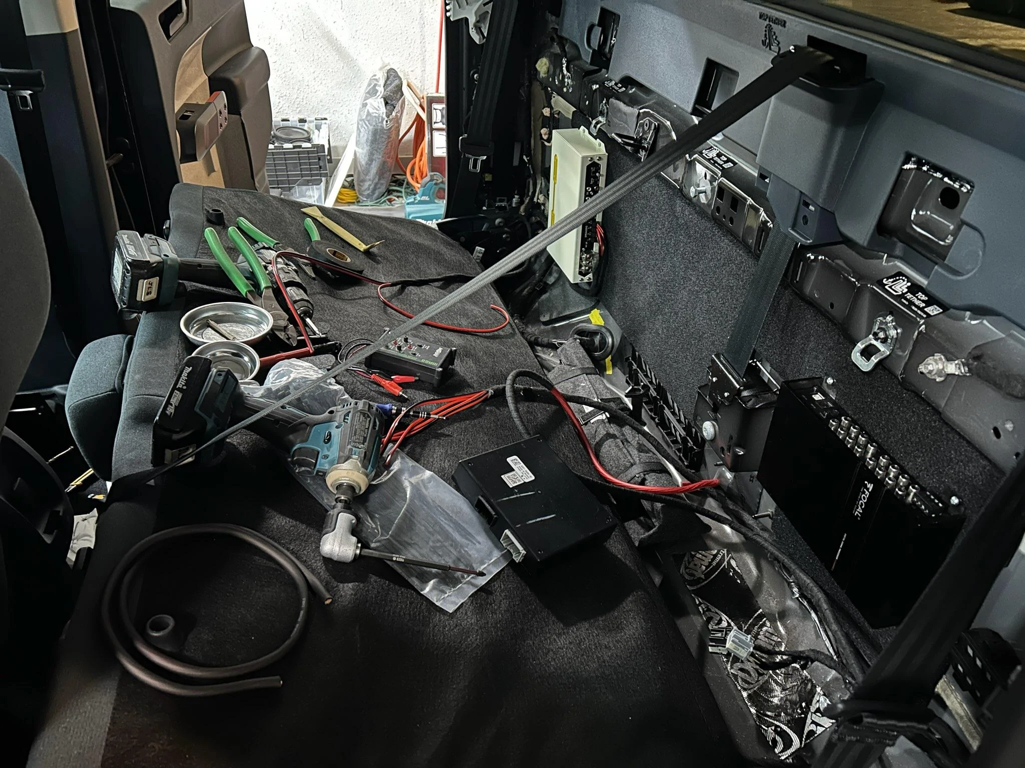

We used 1/2" birch for the amp rack as well. And we were gonna use the mounts already there like a few have but I just didn't have the depth I wanted with the 3 amps and dsp back there. So we cut that part off on the passenger side and attached at higher points. If you look on the photos at each end you'll see two bolts on each side. And then on top of that, we epoxied areas as well so nothing will come lose

Just realized I missed this lol. Thanks for the pics! What mounts have other people used? Is that the threaded screw that sticks out of the rear wall? Also for your tweeters how did you mount them in the factory location? Did they just fit right in or have to be modified?

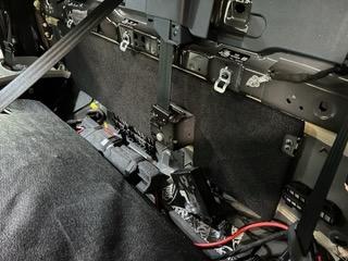

I noticed most used the threaded screw holes on the passenger side metal piece that sticks out. I cut off the piece in blue, and made a bracket to bolt them on the one in red which has one on both sides.

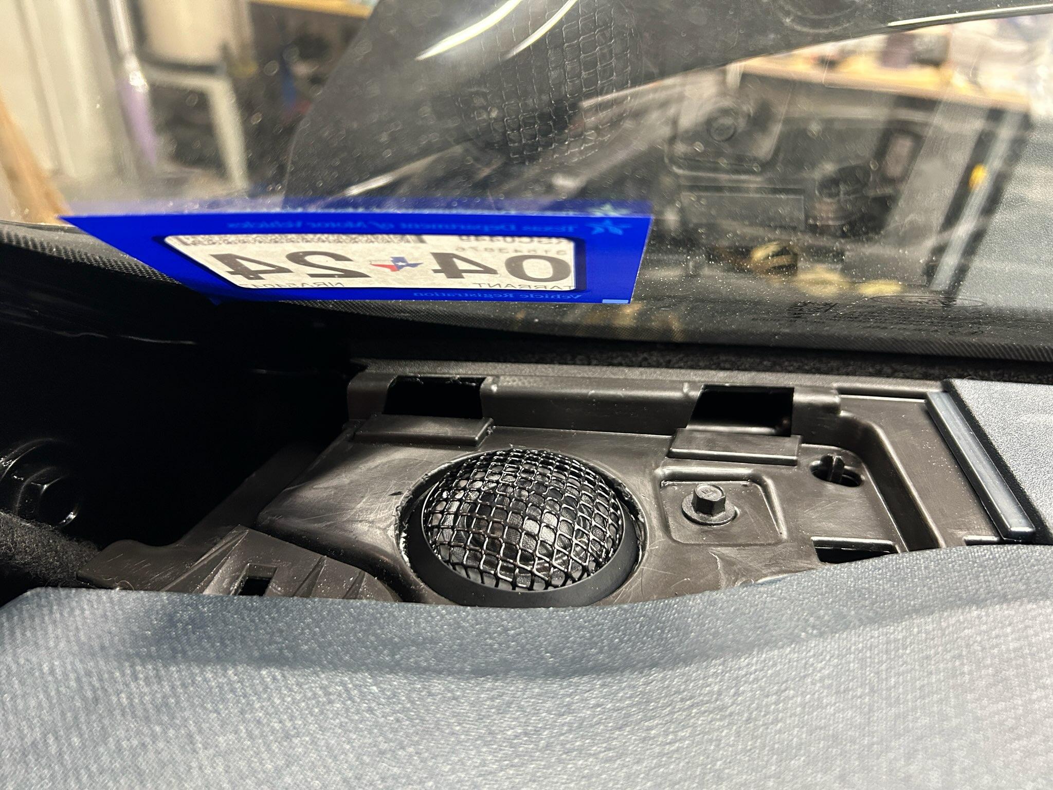

For my tweeters they had to be modified, we dremeled the inside for it fit perfectly inside. It's a massive tweeter as it barely fits from hitting my ac ducting under it. But I will be making a 1/2 birch baffle for that soon to mount the tweeter and the wmt there. I hate the tweeter covers on this thing so another good reason for the baffle then just speaker cloth on top.
