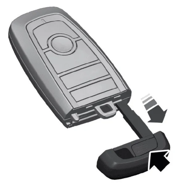

Thanks for the feedback so far. To clarify this is a Lariat lux so the key has no blade. While I did learn something new about the backup location, I do not believe this to be a key issue as that would not explain why entering the code on the driver's side keypad to unlock the door was also unresponsive.
Did you not see the second graphic in my post? The key blade slides out of the fob as shown. That’s why the driver door has the ability to use a key, as a backup.
There is a key hidden within your fob. Press the area that has the ridges, that the above member is pointing to, and then pull on the silver part. This key allows you to unlock the door.

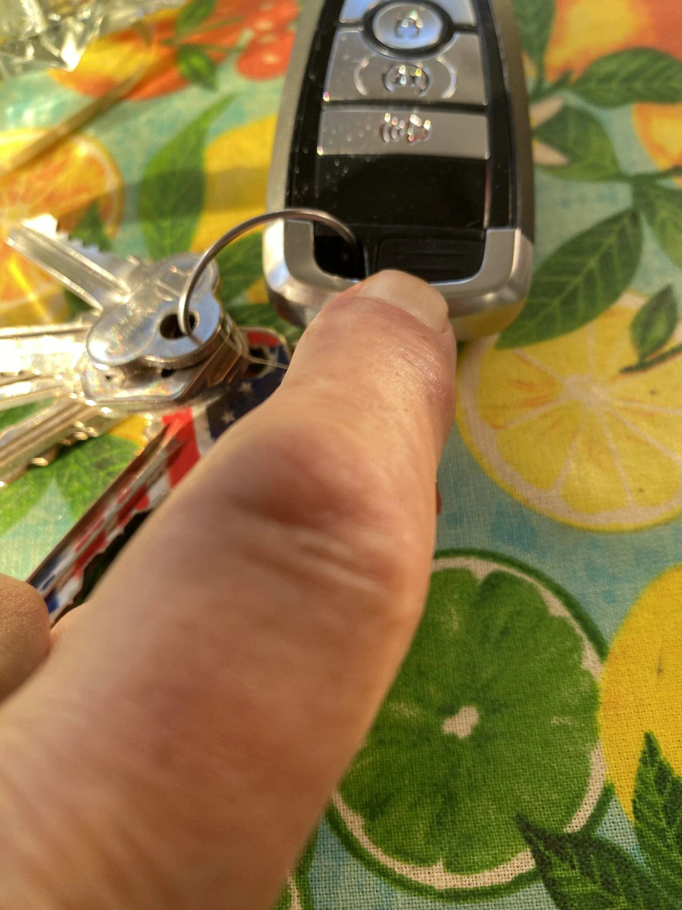

It’s where you can attach other keys, press the buttons right next to it and it will pop out. Remember to do this when left to get serviced. That way you have your other keys with you. They only need the fob.
Thanks...learned something!
