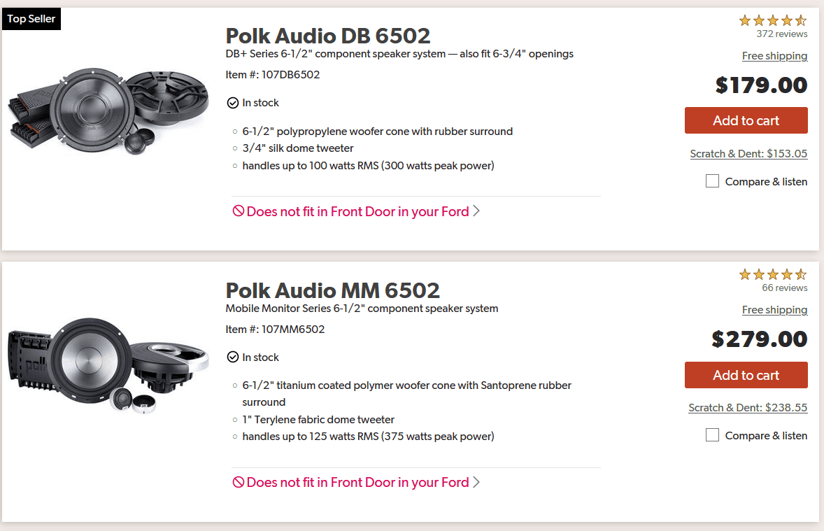

I'm not exactly certain why Crutchfield lists the 2 polk 6.5" components (MM and DB series) as not fitting the Maverick. I don't think they are overly deep. I put a set of MM 6.5 components in my wife's SUV that our son is now driving like 10 years ago and the cones and tweeters look the same, not to say for sure that they actually are the same.
I generally like silk or other fabric tweeters, but my current components have plastic tweeter domes and I like them a lot. I listened to them at a local shop before buying. They're on sale now - possibly going closeout, as there has been a new model (ASE165) for well over a year now, maybe 2. https://www.crutchfield.com/S-uG78Qc1yecI/p_091RSE165/Focal-RSE-165.html
After installing mine, I'm going to guess that it's because of the plastic reinforcement ribs I had to trim inside the door to accomodate the diameter of the magnet or just the general shape of the woofer's backside. That definitely seems like it would be a limiting factor in determining what fits.
Ford Maverick Alpine Optim8 DSP/Amp - Lane's Review, Thoughts, Results... 06a-
That was super easy to do and it would definitely allow a much greater selection of door speakers to fit.
With the current Polk, I suppose it could be the tweeter diameter also. A person would have to dig up and look at the specs closely to see.
I called crutchfield on some of the fitment issues they listed. Some of the speakers that aren't too deep still don't fit because the magnet is too wide.
