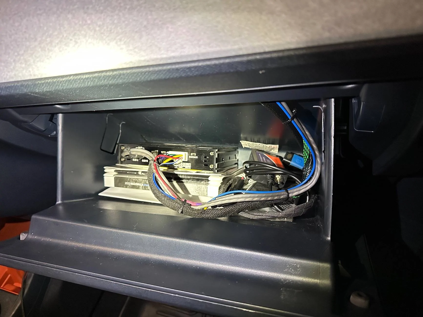

Hey, where’d you mount the DSP? Got my C7 in today, and I’ve noticed there’s no mounting points in it or hardware in the box.

mine is in my glovebox, i dont use that for anything other than the owners manual, an it seems to be happy there :)

Good call, thanks for the reply! Mines all happy in there too now haha. There weren’t really all too many other options it seems…
6 hours later the compact sub is in, rear wall is sound deadened, and the dsp is in. Now just got to get the door speakers in tomorrow, and give tuning a go. Already happy with the added bass!
