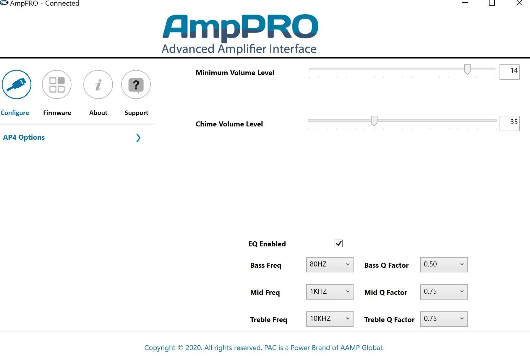

So, I've been dragging my feet with upgrading the system in my 23 Ecoboost, knowing I ordered a 24 Hybrid that may take 18mo to come and that I may not end up taking delivery of anyhow. I've been researching options a ton, knowing I was going to have to go the PAC route if I wanted anything more than a powered sub. I ended up meeting an alpine rep at a local shop that introduced me to their new Optim8. It's a 6x50 + 150x2 amplifier with built in auto tuning and configurable DSP via iPhone mic or alpine mic setup. I was leaning towards a DSP, but it was also one of the things slowing me down on taking the plunge with the extra cost of the PAC, DSP, extra amp, and the Audison powered sub I pulled out of my last vehicle. Anyhow, they offered 20% off the regular price on their demo day, so I bought it. I had enough amazon points to order the PAC Amp Pro directly, so I ordered that as well. It took a bit of time to set up an install date, and I wasn't 100% on speaker selection yet. I was waiting on R2 Pro components to come in and be set up on a new soundboard. In the meantime, I ordered Morel Maximo 4" to replace the rear speakers. I didn't want to spend a ton, but I didn't want to leave the factory crap in there either. They weren't supposed to fit, per crutchfield, but the installer got them in.

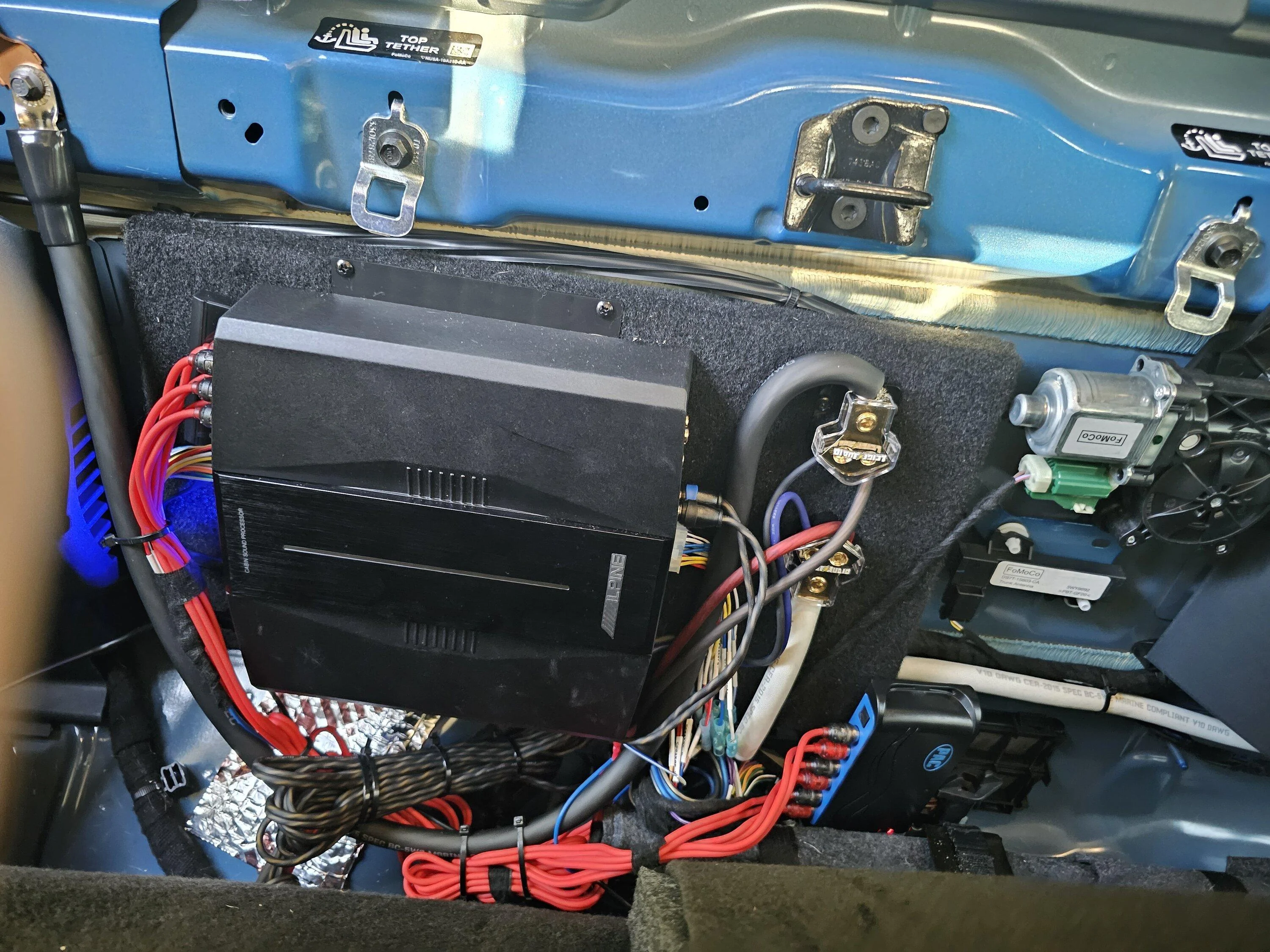

On to the install.... apparently I'm one of the first to have this installed at the shop. Also, I wanted the 2x150watt "subwoofer" channels to run to the front door speakers. I was assured this was completely doable with assigning channels in the Optim8 software. Needless to say, the install and configuration has been a bit of a journey with a lot of time spent at the install shop. The first go round, the door speakers werent getting the power they were supposed to. It took a call in to tech support and some changing of the inputs/wiring to get it to do what we wanted in conjunction with the PAC module. Then there was the center channel. It just didn't sound good. Alpine (as well as crutchfield) recommended not utilizing it, as it would get a mono signal and screw with the front soundstage. After disabling it, I agree. So, I have 2 non-used channels on the processor. I am able to utilize the output on one of those channels and designate is as the actual subwoofer channel and run it to the Audison 10" powered sub. It just barely fits in the backseat footwell behind the passenger seat. I figured I would start with this since I already had it and see if there is any need to spend more money on custom boxes and a separate amp for that purpose.
We got a basic tune set for it, and it sounds pretty good for still running stock front door speakers and tweeters. I am still at a loss which way I want to go there. Doing the listening comparison on Crutchfield, I like the Alpine R2 Pros, Hertz Cento Pros, and some Focal Flax which show having too deep a magnet to fit. I was initially liking the Morel Maximo Ultra sound, but they are a bit harsher than the Hertz or R2 Pros. The Tempo Ultra were another consideration, but they sound a bit subdued in the listening comparison. I'm going to listen to it as is for about a week and make some tweaks before deciding on front components.
The one downside to having the lariat lux with the sliding window is the lack of room for an amp/rack. Everything is pretty crammed in, even after taking out the 6x9 "sub". I went with 0ga wiring to future-proof myself in case I end up adding a 1000w amp and sub down the road. In hindsight, I've also found that the Pac module has a $50 toslink adapter you can add to it, which would have gotten rid of all those red RCA cables and been able to run a single digital coax cable off a converter to the Alpine Optim8.
Ford Maverick B&O Stereo partially upgraded with PAC Amp Pro and Optim8 System amp 20231003_175135
Ford Maverick B&O Stereo partially upgraded with PAC Amp Pro and Optim8 System amp 20231003_173302
Ford Maverick B&O Stereo partially upgraded with PAC Amp Pro and Optim8 System amp pac config1

It's been forever, but I'm back with an update, and the Optim8 will be removed from my car. When it was first installed, I wasn't getting the power to the front doors from the 150w channels that I thought I should be. This was evidenced in the fact that if I faded from front to rear, the 4" morel coaxes that are 4db less sensitive were actually louder than the front speakers. The original install shop spent over 2 hours going through settings, sure it was just something we missed in setup. They ended up calling Alpine and telling me I would need to come back to have some wiring changed. I assumed this was just going to be to swap some RCAs or trick the system somehow. This appointment took another 2.5 hours and complete retuning. It ended up sounding much better in the front stage, but shame on me for not looking closely at what they did and hooking up my laptop before I left.
Here's where the drama starts. When I did go to look at the tune on my laptop and make some sub adjustments weeks down the road, I saw something odd. There was no longer speaker outputs listed on channels 7-8, and my front door speakers were showing as outputs 5-6. I thought this was odd, so I looked at the amp more closely (which was a wiring mess in itself), and there were no speaker wires connected to channels 7-8. Now I knew why the shop avoided giving me a straight answer when I asked them what alpine advised to do to fix the issue. So, I called Alpine tech service and had a tech walk me through the setup that I wanted, who also said that I could definitely use channels 7-8 to run the 6.5 door components. I later went to a different shop to have the Hertz Cento Pros installed and the wiring corrected and re-tuned with the components installed and the mids getting 150 watts. When I arrived to the shop and connected the computer to go through the tune after the speakers were installed and the wiring was fixed, we had the same issue with low output from the front door speakers. Now, this shop is also an authorized alpine dealer and had called their rep to make sure this was possible with the Optim8 as well. After going through all the settings again and them making a few calls, they hooked a multimeter up and found that I was only getting around 9 watts out of those channels. They called someone higher up at Alpine in engineering to get to the bottom of it. They admitted that they were having installers only run subs on channels 7-8 and not advising to run other speakers because "the power wouldn't scale the same." I have no idea what that means or how it would change with the same impedence speakers, but it is evident in the lack of power.
At this point, I called the first shop and told them that I wanted to return the unit for not working as described, and for lying about it when they disconnected channels 7-8 in my 2nd visit to "fix" the issue. I never would have purchased it had they not sold me on it being able to run my mids on the 150 watt channels and get the rated power (or at least close) out of them. They refused and we ended up in a credit card dispute, which they lost. I will be replacing the unit with an Audison F8.9 as soon as I can get an appointment to do so.
As far as technology goes, the Optim8 is very impressive for the price. As far as sound and clean high volume goes, I was obviously expecting a huge improvement with the Hertz components and Morel coaxs hooked up to this processor, boasting 500 watts of power between them. I was let down. The factory B&O would allow me to play up to volume 26-27 cleanly. The Alpine amp lets me play up to the same 26-27 with their master volume set at 30 (out of 35). The soundstage is better if you get your time delays right, but it isn't the dramatic leap in sound quality that I though spending $2000+ would achieve. I would honestly be curious to hear the B&O amp hooked back up to the same speakers with their factory processing. I'm already down the rabbit hole, but for anyone considering upgrading, I would upgrade your speakers and sound deadening first, and just add a real powered sub before spending thousands of dollars.
