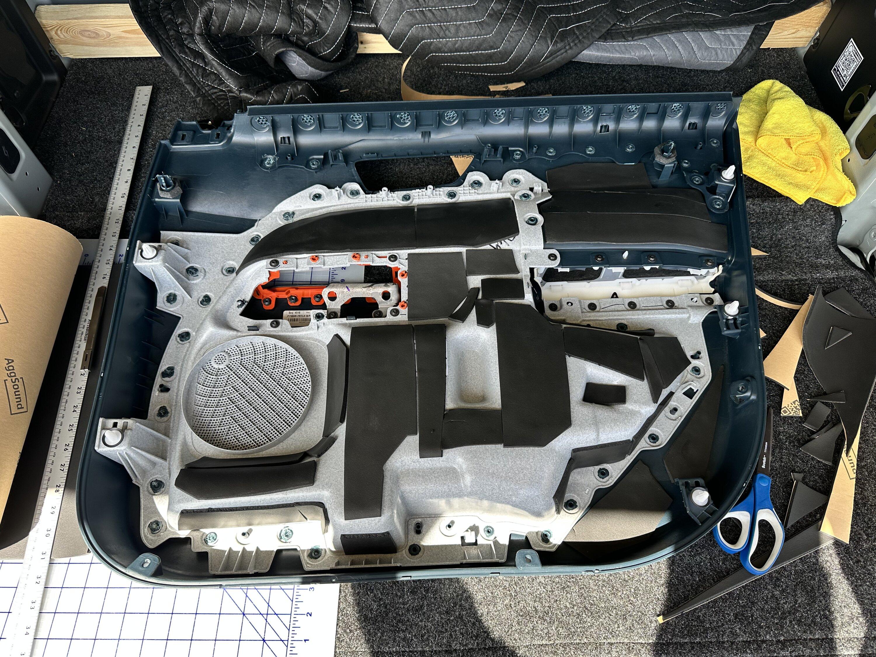

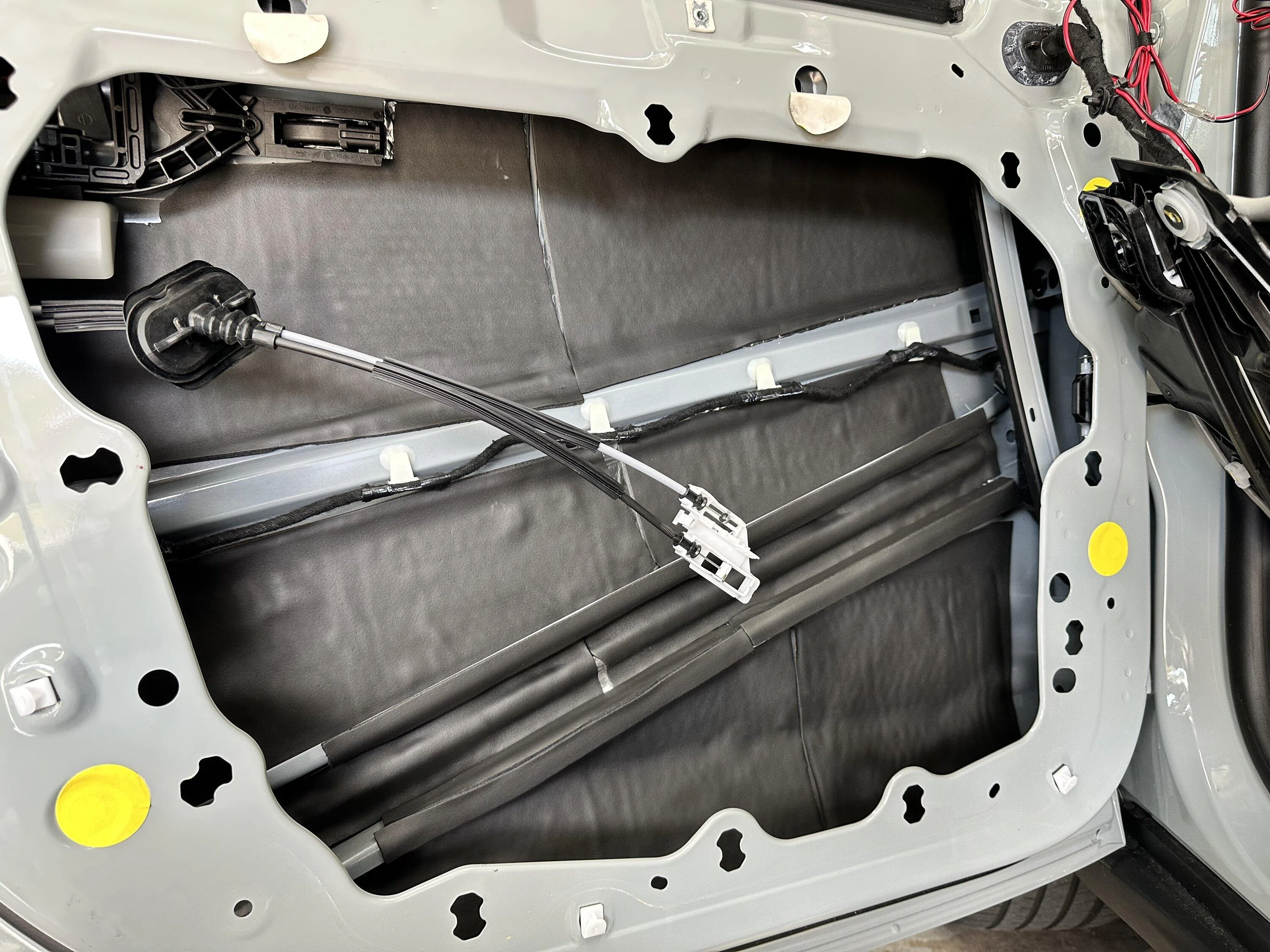

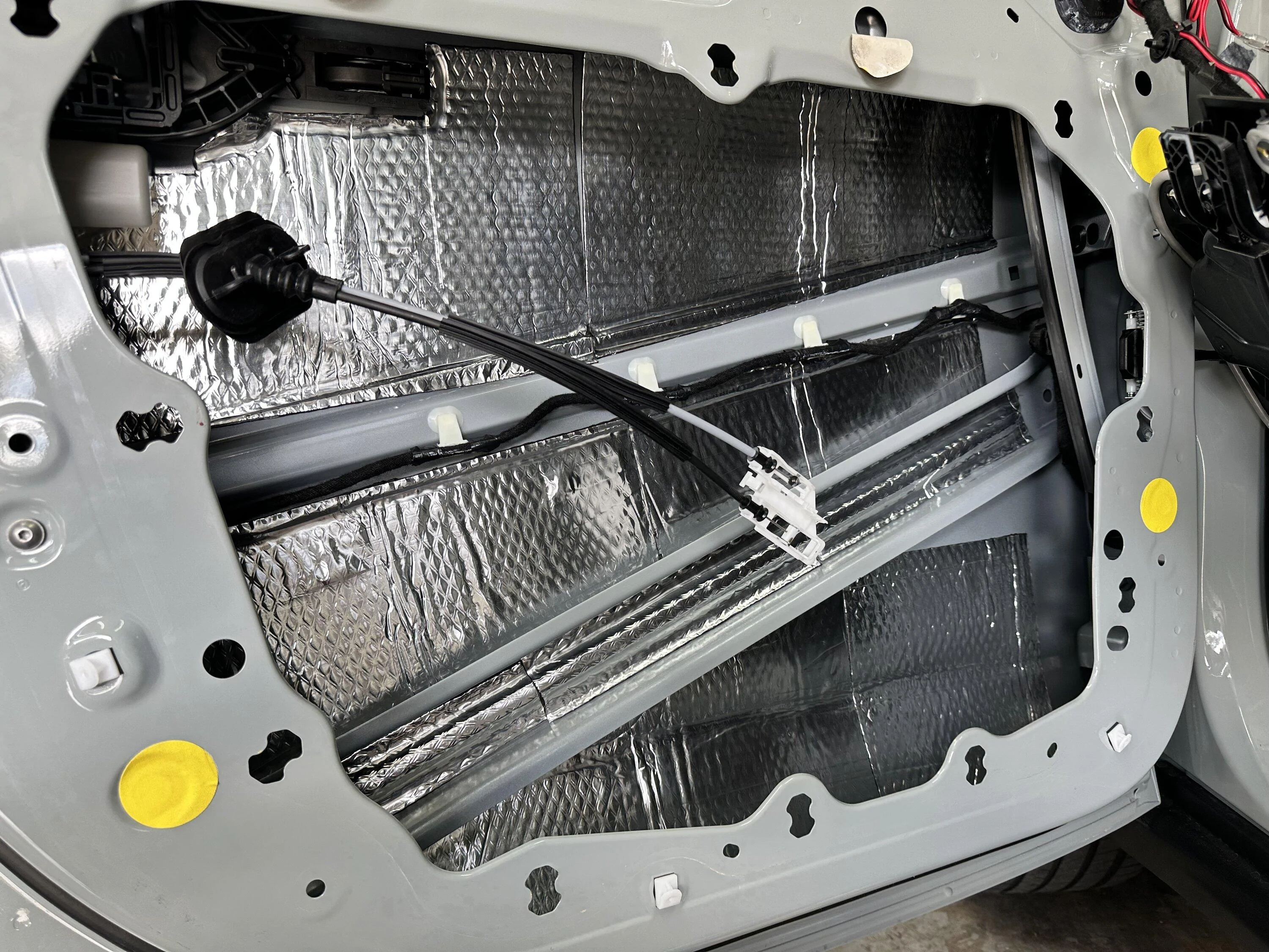

I will be using deadener and closed cell foam on the floors, rear cab, doors and roof. I will probably use closed cell foam alone on the back of plastic panels that cover area's where I cannot put deadener.

I should have been more clear and stated closed cell is for decoupling of sound you are correct. However the average person may not understand that term 100%.CCF doesn't absorb any sound, it deflects it if anything, it should be used either with a barrier or for just decoupling purposes.
Open cell foam is better at absorbing sounds but it needs to be pretty thick to do anything, and it would need to go through a hydrophobic process as well.
You would be better for with some thinsulate for sound absorbing along with decoupling if that is your main goal. And with the amount space definitely get some sm400l.
