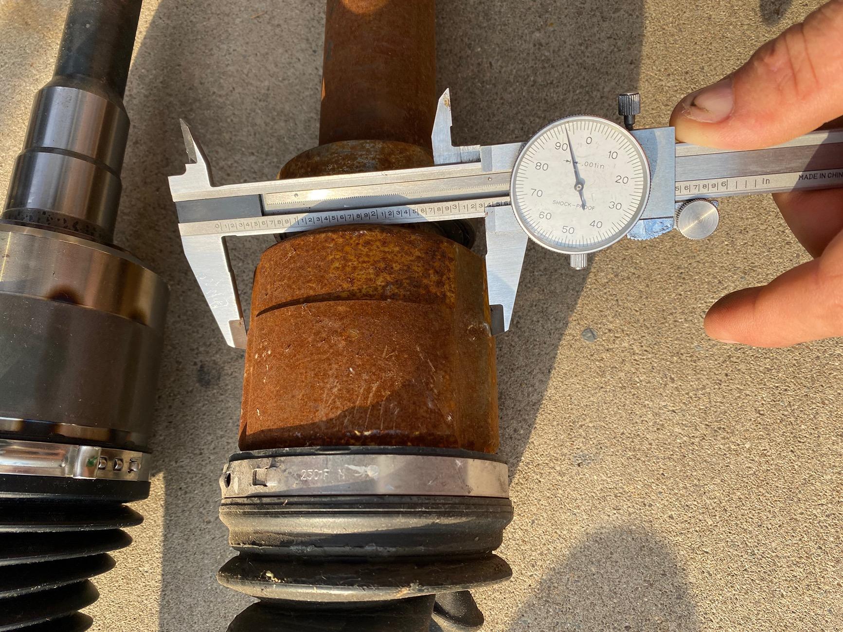

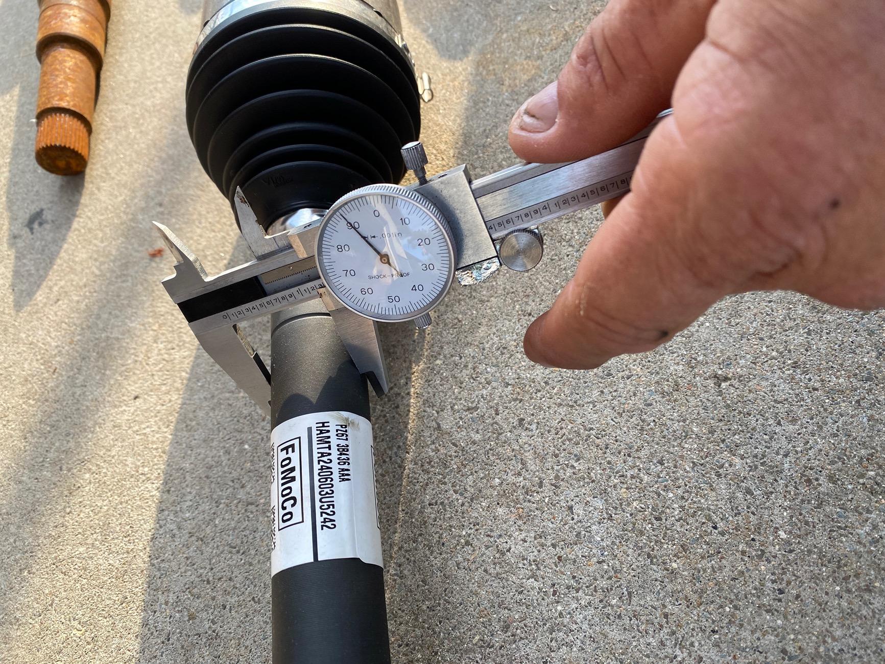

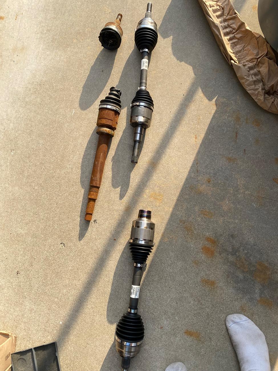

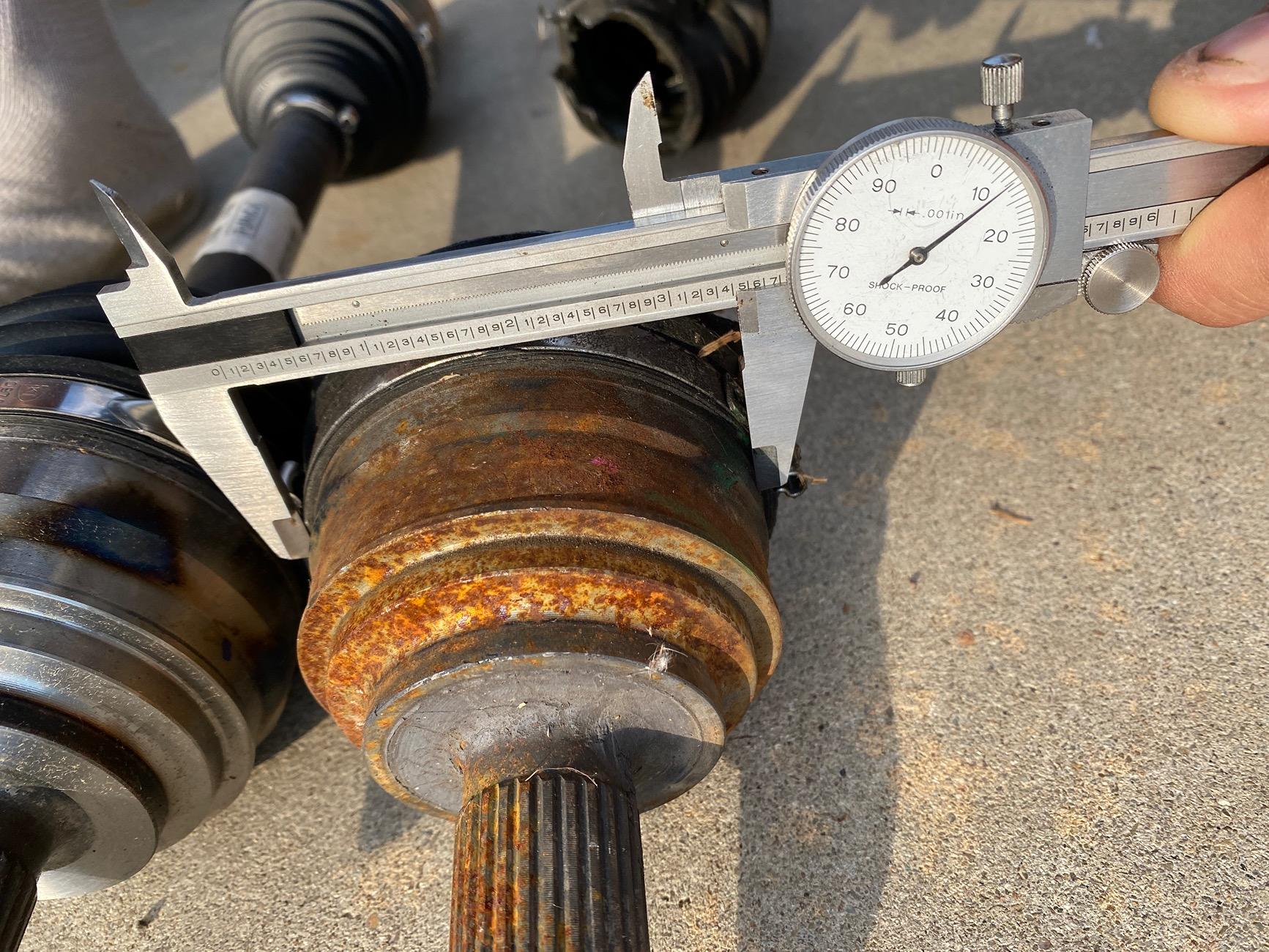

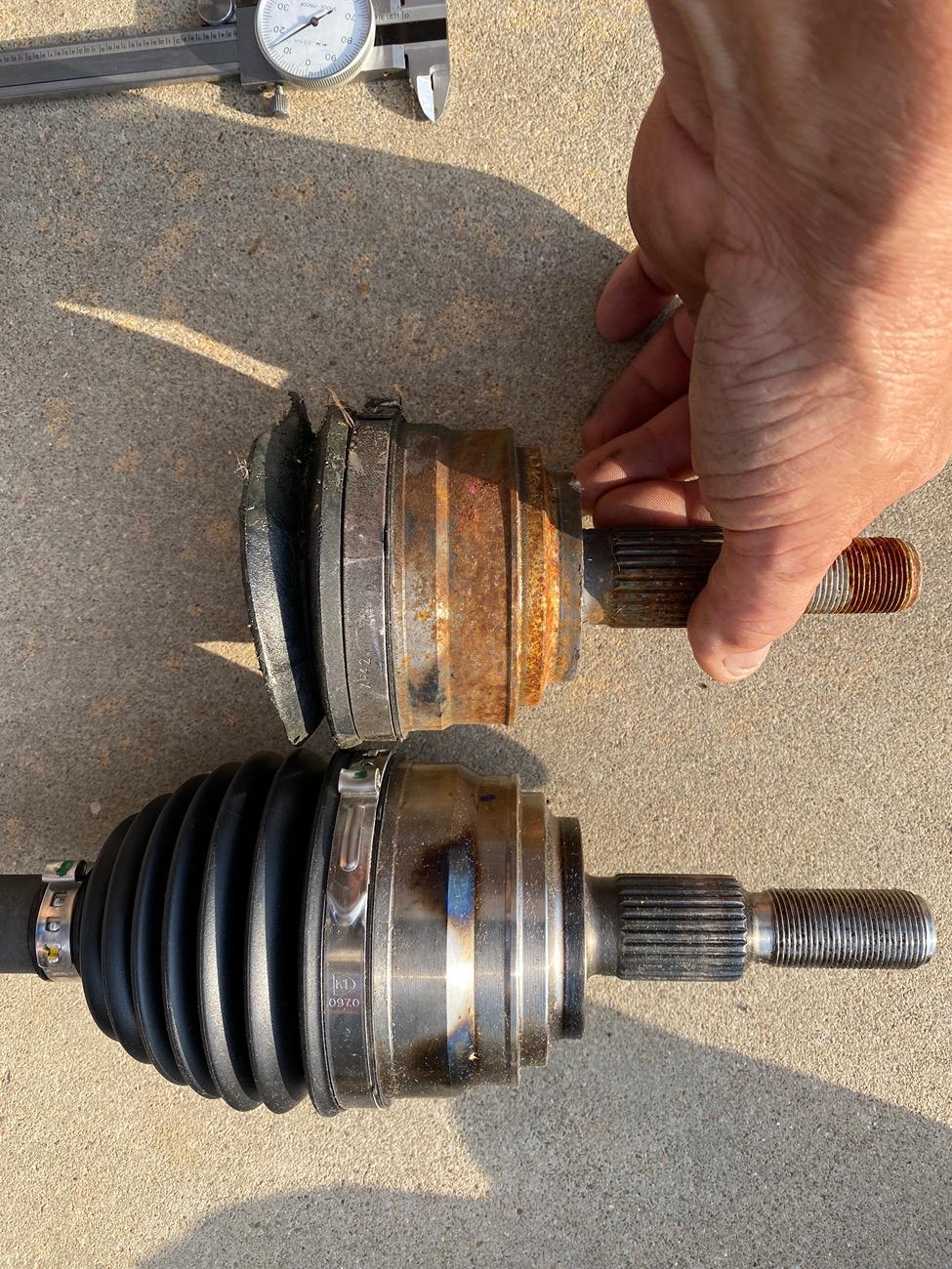

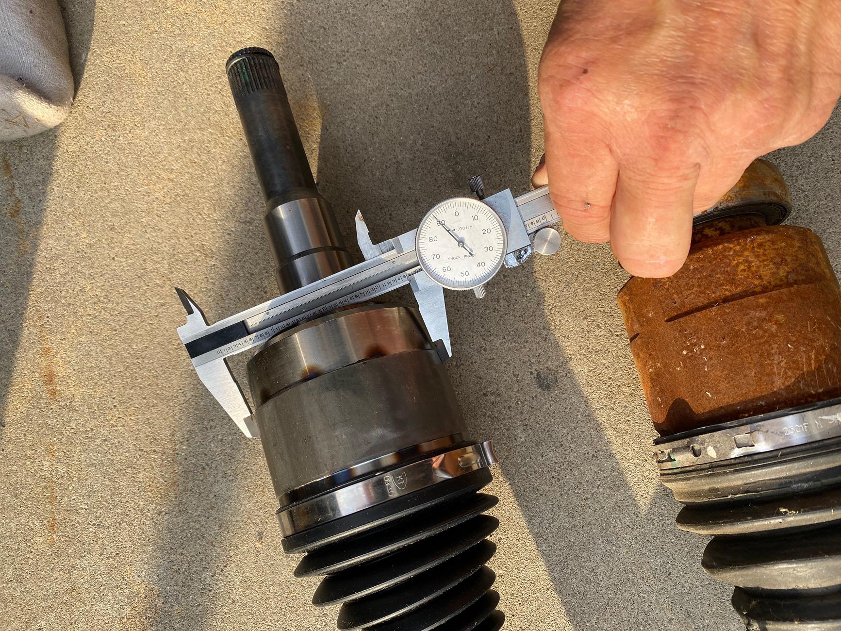

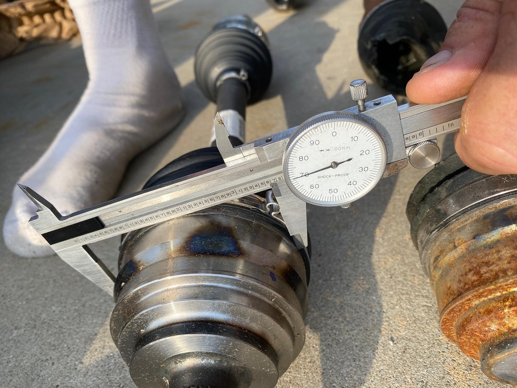

Here are some pics of a broken hybrid and a spare set of tremors , as you see cvt of hybrid necessitates a carrier bearing and longer inboard shaft.
From my previous measures with the 2 hybrid builds I put axles in the actual shaft is about an 1/8” difference and a quick measure today shows the inboard and outboard joint housings are at least that in diameter and length is bigger too . Just the fact the inboard side or plunger side doesn’t have the 3 indents on the joint , tells me the overall inside is substantially thicker .
I will be de booting these soon when I have to mock up for the wider an arms .ill post more pics and measurements then .the other chromoly arms are going on this week along with the full bottom skid plates that just came in !
