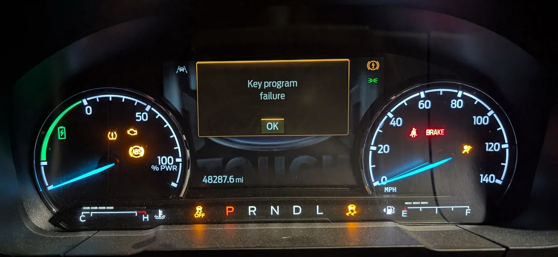

I bought the recommended key for my 2022 Lariat Lux off of Amazon, and have tried more times than I care to count. Always getting a key program failure error.
Did you get the correct MHZ radio transporter?
My Lariat came with a 315MHZ key fob, I first ordered a 900ish MHZ that didn't work, then I ordered the 315MHZ and it worked like a champ
