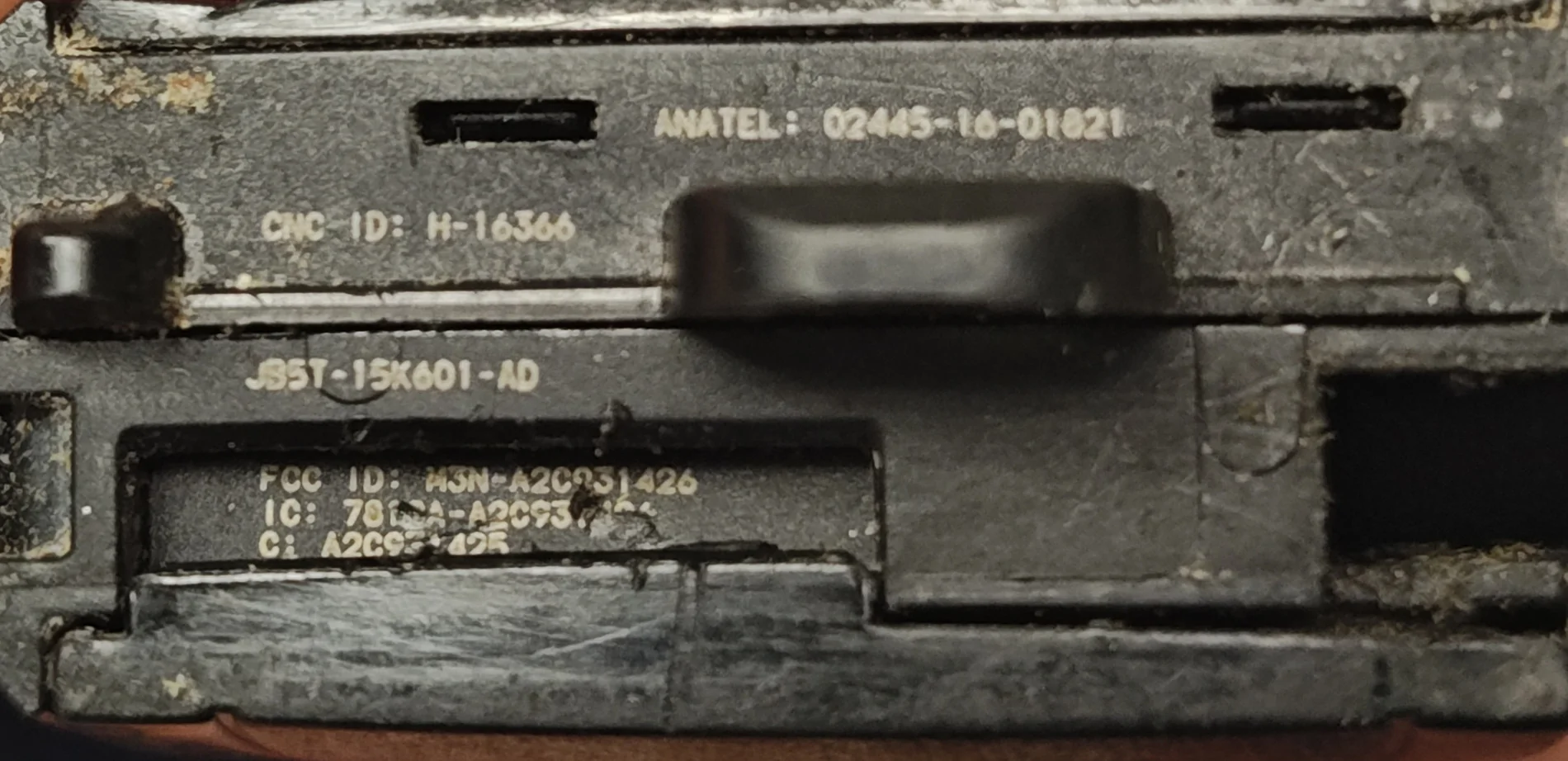

Did you get the correct MHZ radio transporter?
My Lariat came with a 315MHZ key fob, I first ordered a 900ish MHZ that didn't work, then I ordered the 315MHZ and it worked like a champ
I got this one that is 902mHz says it's for a 2022 Maverick. Mine is a 2022.
Aichiyu Keyless Entry Smart Remote Key Fob Replacement for Ford Bronco 2021-2023 Edge Explorer 2017-2022 Escape 2010-2022 Maverick 2022 Ranger XLT, 902MHz FCC ID: M3N-A2C931426, P/N: 164-R8182 https://a.co/d/08UlLNCQ
Lariat or non?
Or basically keyless entry or not?
From another thread below.
What codes does your fob have on it?
I made sure to look up the FCC ID from the original key before ordering one from Amazon It is located in tiny print in a cavity that is revealed when you pullout the manual key.
FCC ID = M3N-A2C93142300
Part number = 164-R8163 or HC3T-15K601-AD
This key runs at 315MHz
I purchased two of these keys - https://www.amazon.com/TUCKBOLD-Explorer-2018-2022-M3N-A2C93142300-Replacement/dp/B0D8QFGKKZ
Keyless Entry Remote suitable for Ford Ecosport 2018-2020, for Ford Edge 2017-2020, for Ford Explorer 2018-2020, for Ford F-150 2018-2020, for Ford F-250 2017-2020, for Ford F-350 2017-2020, for Ford F-450 2017-2020, for Ford F-550 2017-2020, for Ford Fusion 2017-2018, for Ford for Ranger 2019-2020.
You might need to take a second look at your factory key fob to make sure.
See this:
https://www.mavericktruckclub.com/forum/threads/2024-lariat-tremor-hpr.69811/post-1288876
Mine is a 2024 Lariat Tremor and got the 315MHZ transporter
