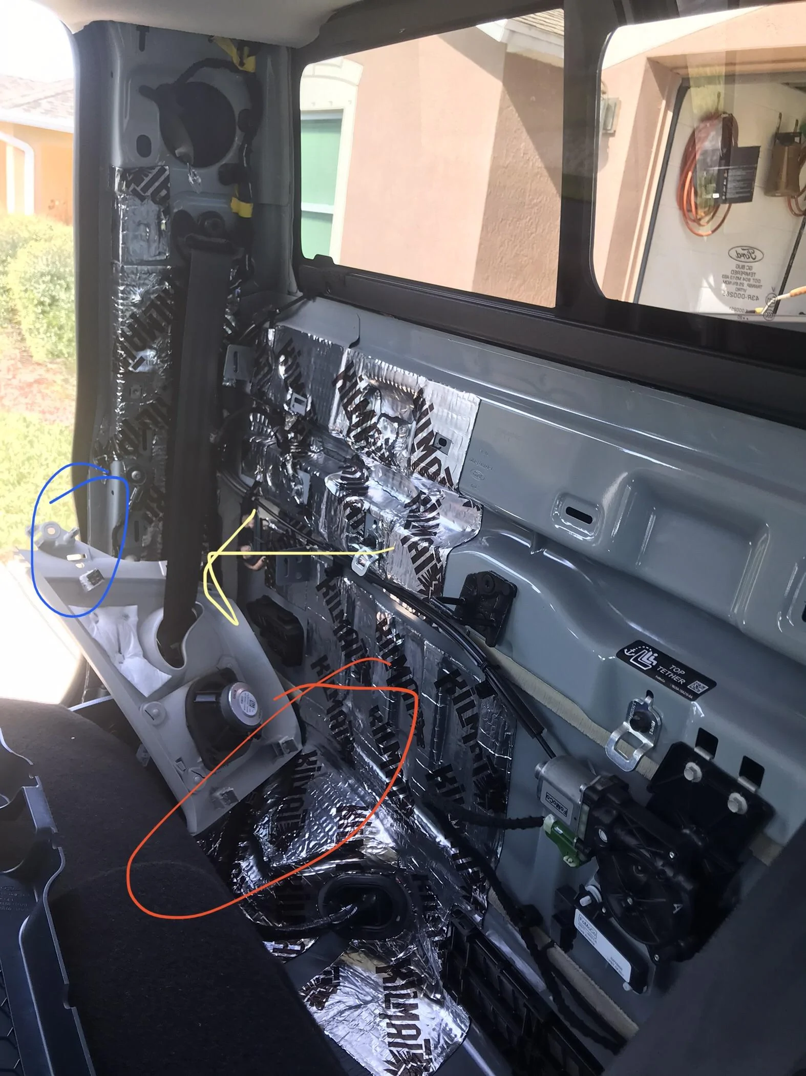

Really quite easy. Speaker grill is hardest. Zoom in on picture and you can see hole where clips snap into near headliner.

I’m pleased with results. I just need to finish under the seat. The truck is really quiet. I might double up with left over deadening. Definitely not worth taking apart entire truck.

This speaker grill was the only pita to remove. Yellow arrow is the magnet not seen behind seatbelt. Blue circle is the 7mm. Red circle is the 2 clips that you must push panel towards roof and hit the cross or they will not pull out. Remove bottom of panel first obviously.
You can see one of the other vents just behind speaker panel in bottom corner.
