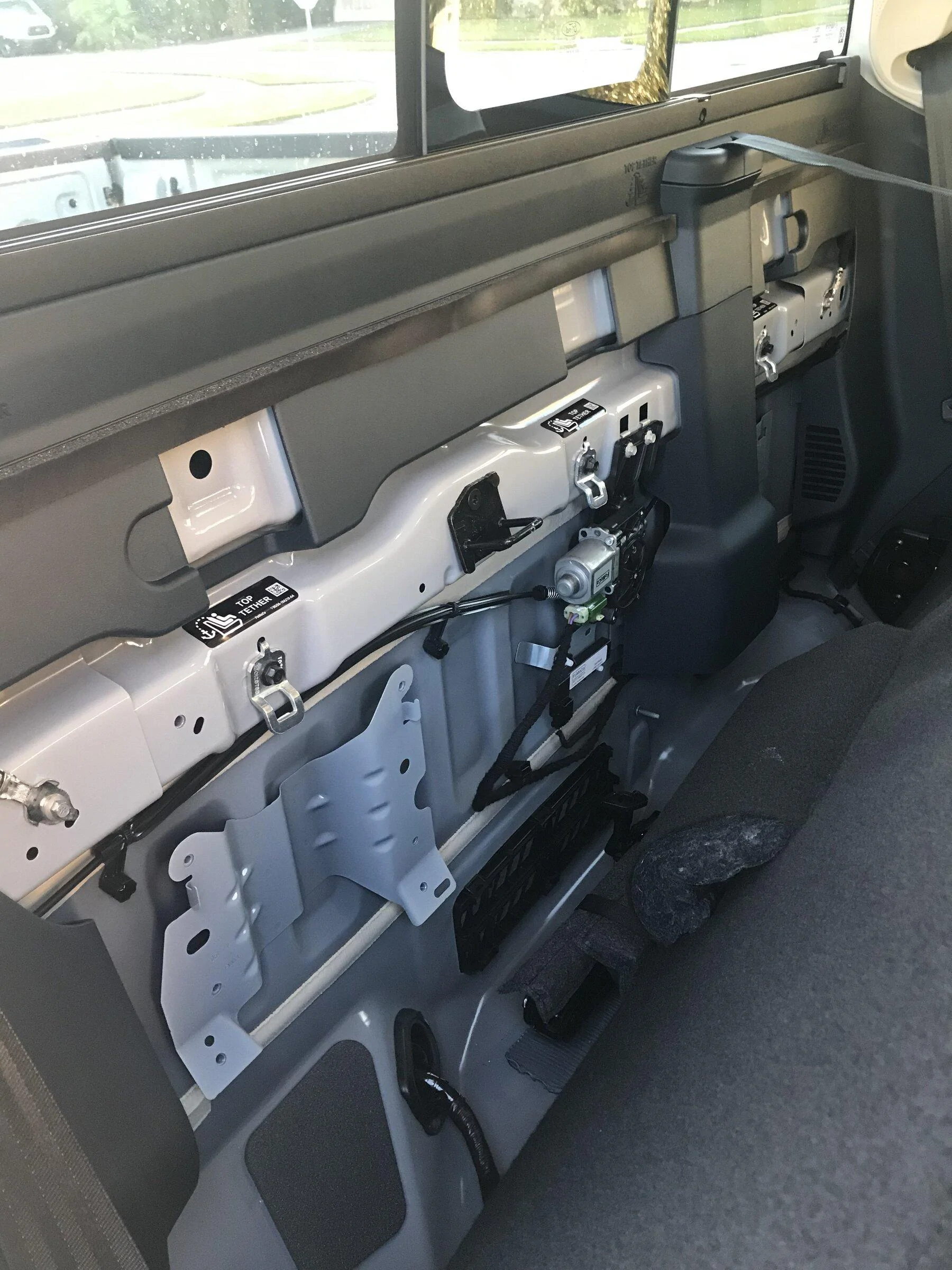

Opinions. Thinking of removing the amplifier mounting bracket from back wall. It vibrates like a sob tapping on it. Not going to drill spot welds as they are visible bedside.

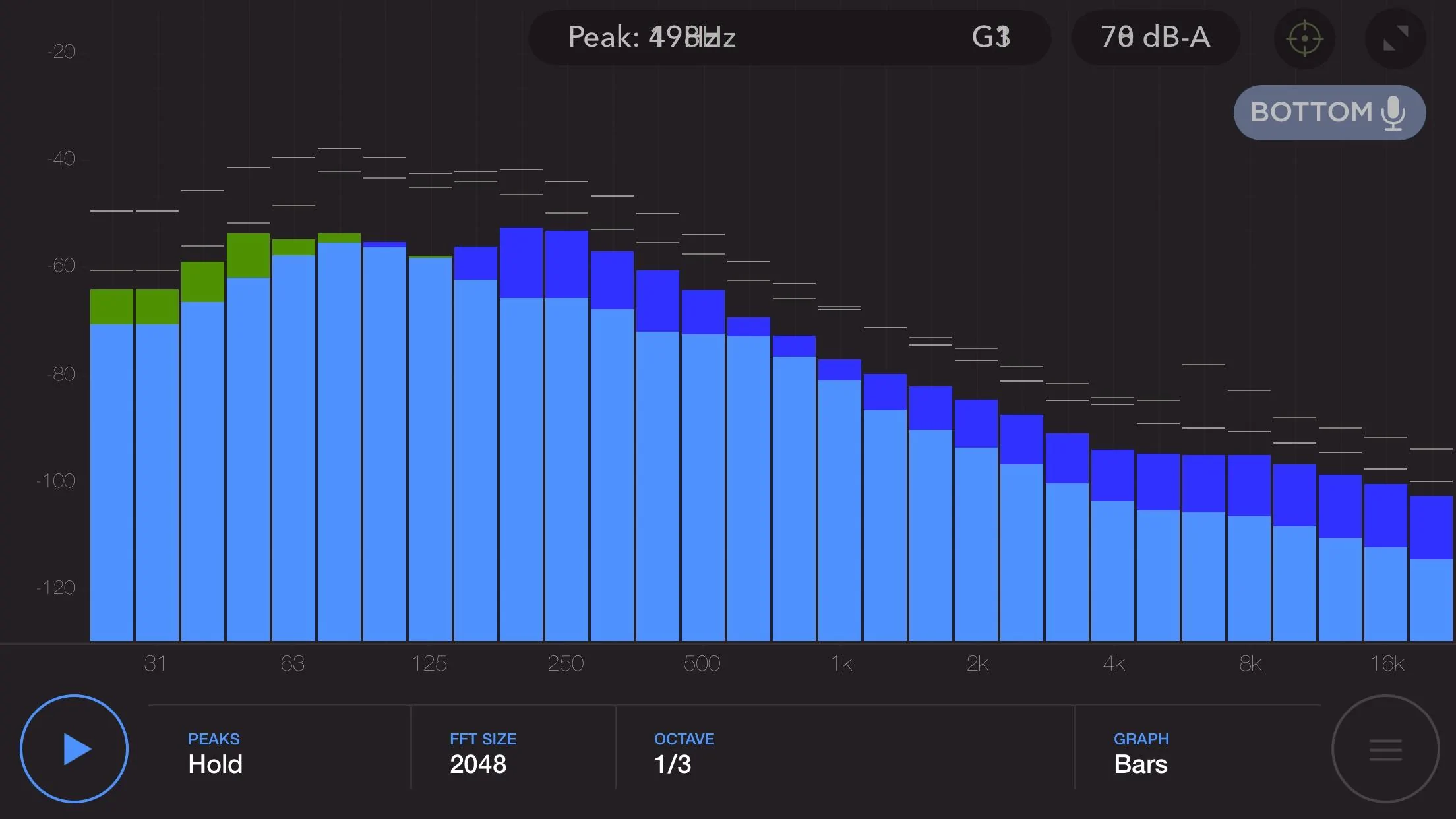

This is the spectrum analyzer at 55mph. No wind tonight. Fan speed on 2. No acceleration and no other cars near me. A normal/not smooth but pothole free 4 lane road I frequently use. Disregard peak as that was during acceleration.

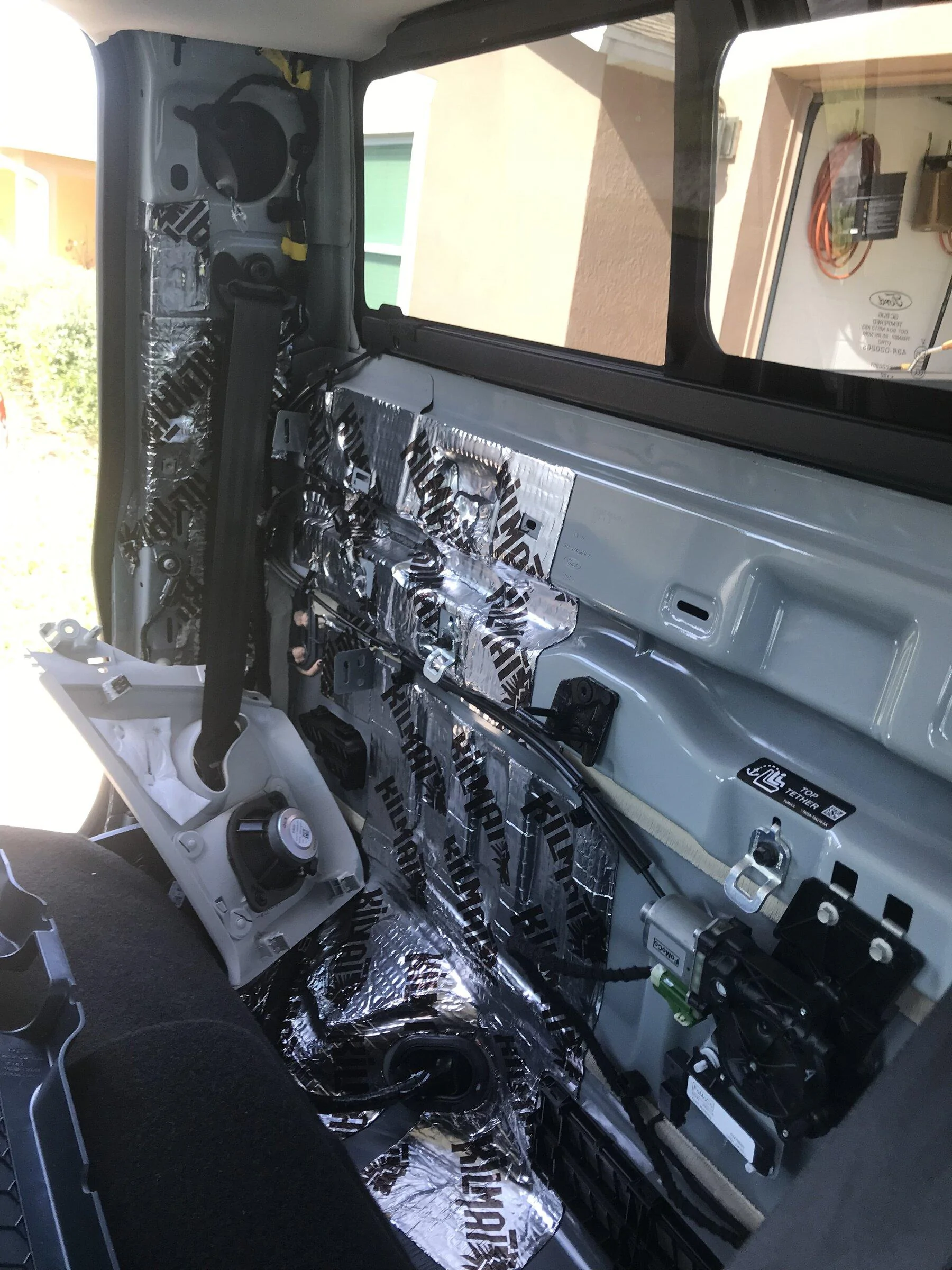

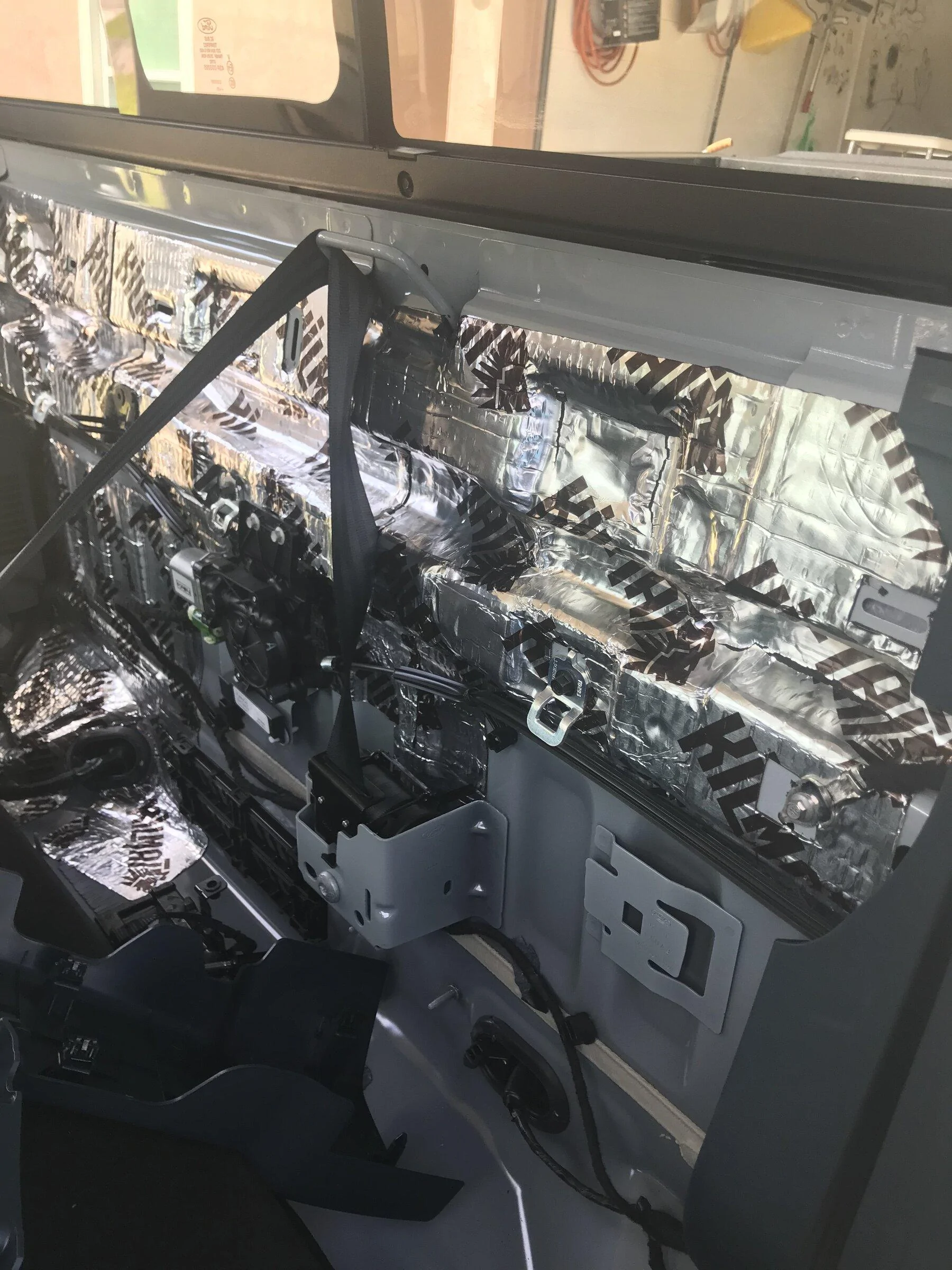

Progress report. Well worth it. Did most of the back wall. Still going to do under back seat. Simple to disassemble.
1. Raise seat bottom and unsnap threshold trim.
2. Remove trim around seatbelt near floor by unsnapping pulling up towards you and sliding it up. Small track it slides into.
3. Lower seat bottom and lower seat back. Unsnap back panel trim. Lay it on seat back. No need to remove seatbelt.
4. remove the long pillar trim that runs up to speaker grill starting at bottom of trim. Starting up near speaker grill is much harder. There is not much to deaden behind this trim but there is some stamped holes and a little flat surface to cover.
NOTE. No reason to remove speaker grill. Nothing you can effectively cover. No surface area and lots of structure behind speaker. If you must. Remove front bottom 7mm fastener. Bottom back is magnetic against pillar. The top clips of grill require you to push grill towards roof before pulling out. The clip hole is cross shaped and clip does not pull out until you push upwards and it centers with cross. Don’t waste time here though.
Additional notes. Nowhere flat so a roller is useless. Use a smooth round object. Backseat removal is not necessary to place deadening under it as it is very accessible from back and under seat. The storage boxes just unsnap after removing step 1 threshold cover.

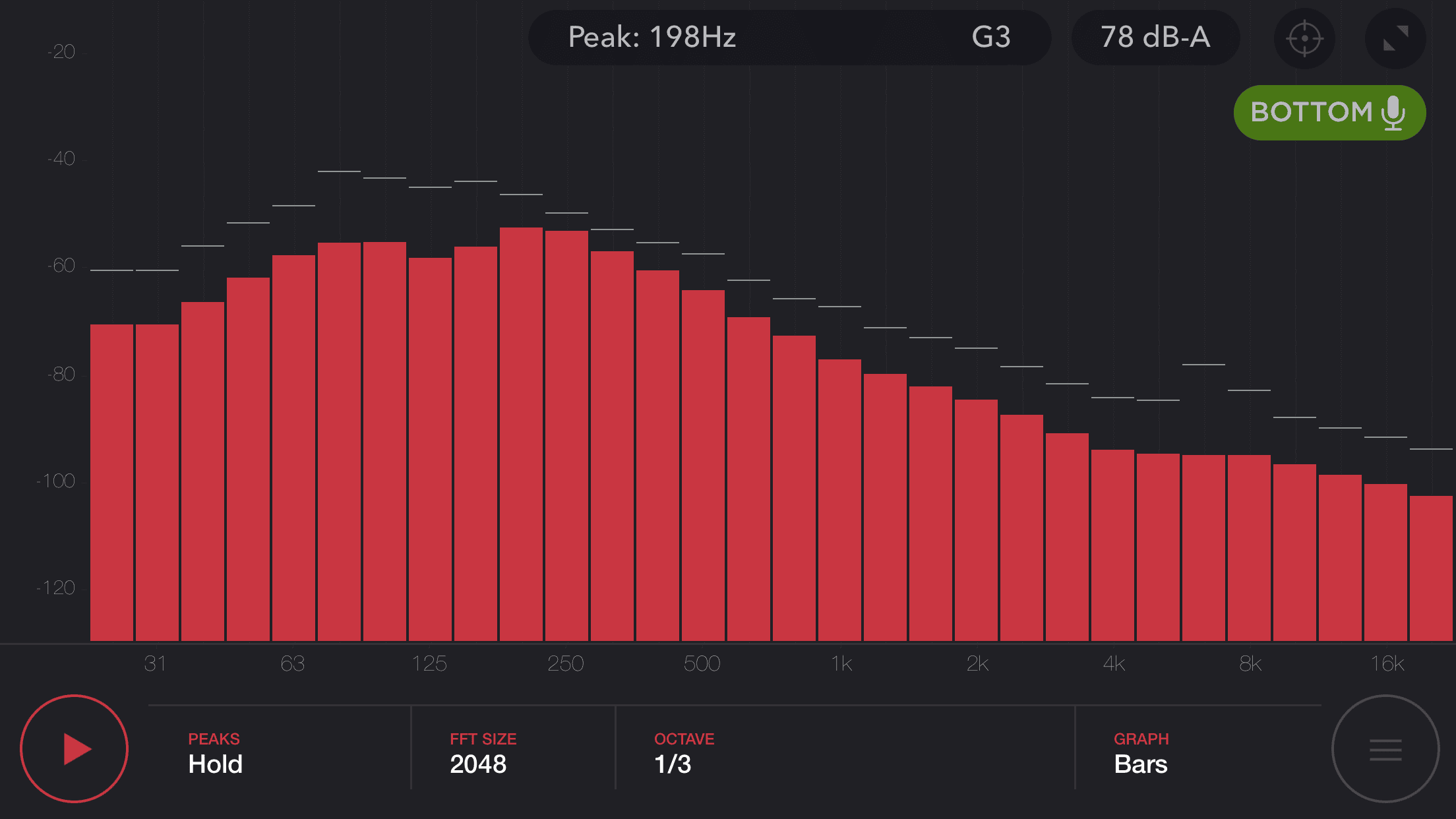

Working on spectrum analyzer pictures to overlay them. But they don’t seem right. Pictures below are in progress pics.
Impressive amount of metal structure back there, in upper pillar and under seat.
What is that big actuator to the right of the bracket?
