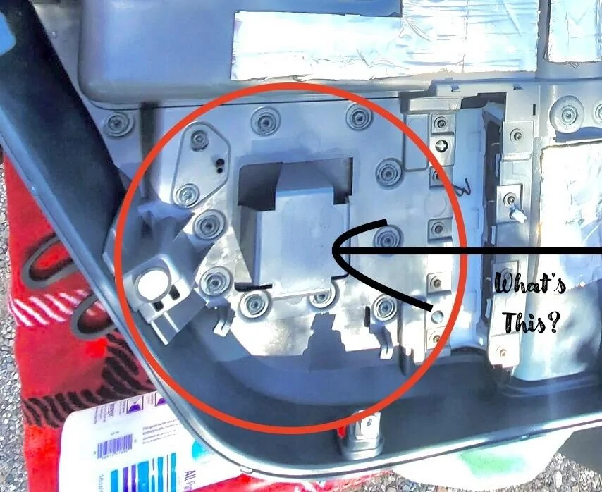

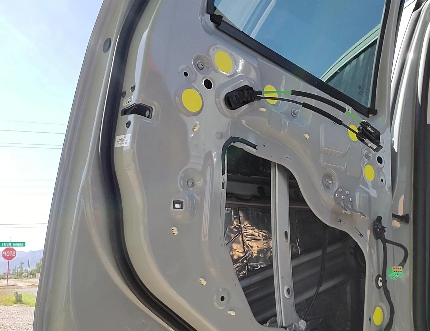

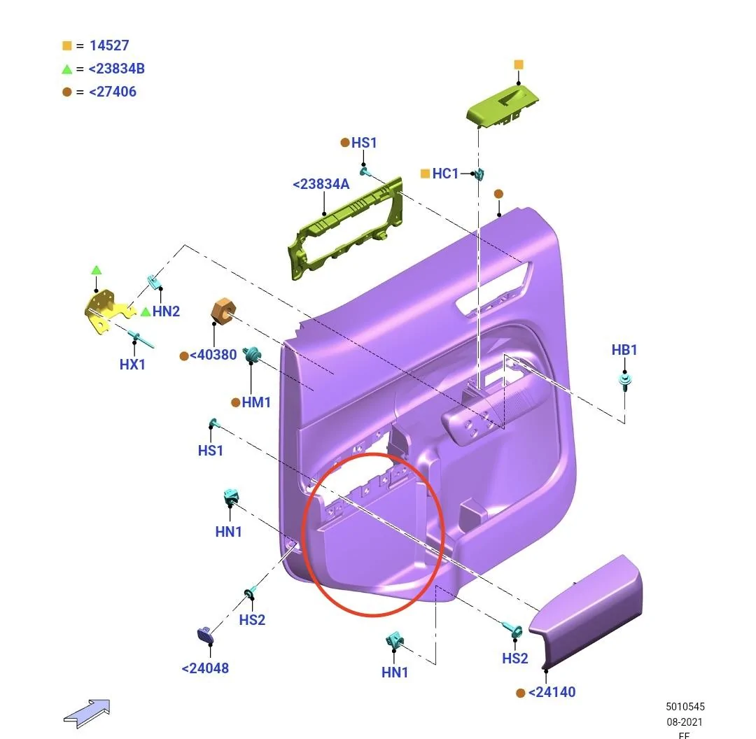

Thanks, your answer is a help especially since you have seen the inside of the door panel. Because the inside steel panel backs up that area, I need to determine the depth of the space behind the outside layer of door panel where the square support is located, so that I can choose the right speaker. Looks like I need to wade in and take the rear door panel off to ensure I can mount a speaker there.
Again, thanks for your help.

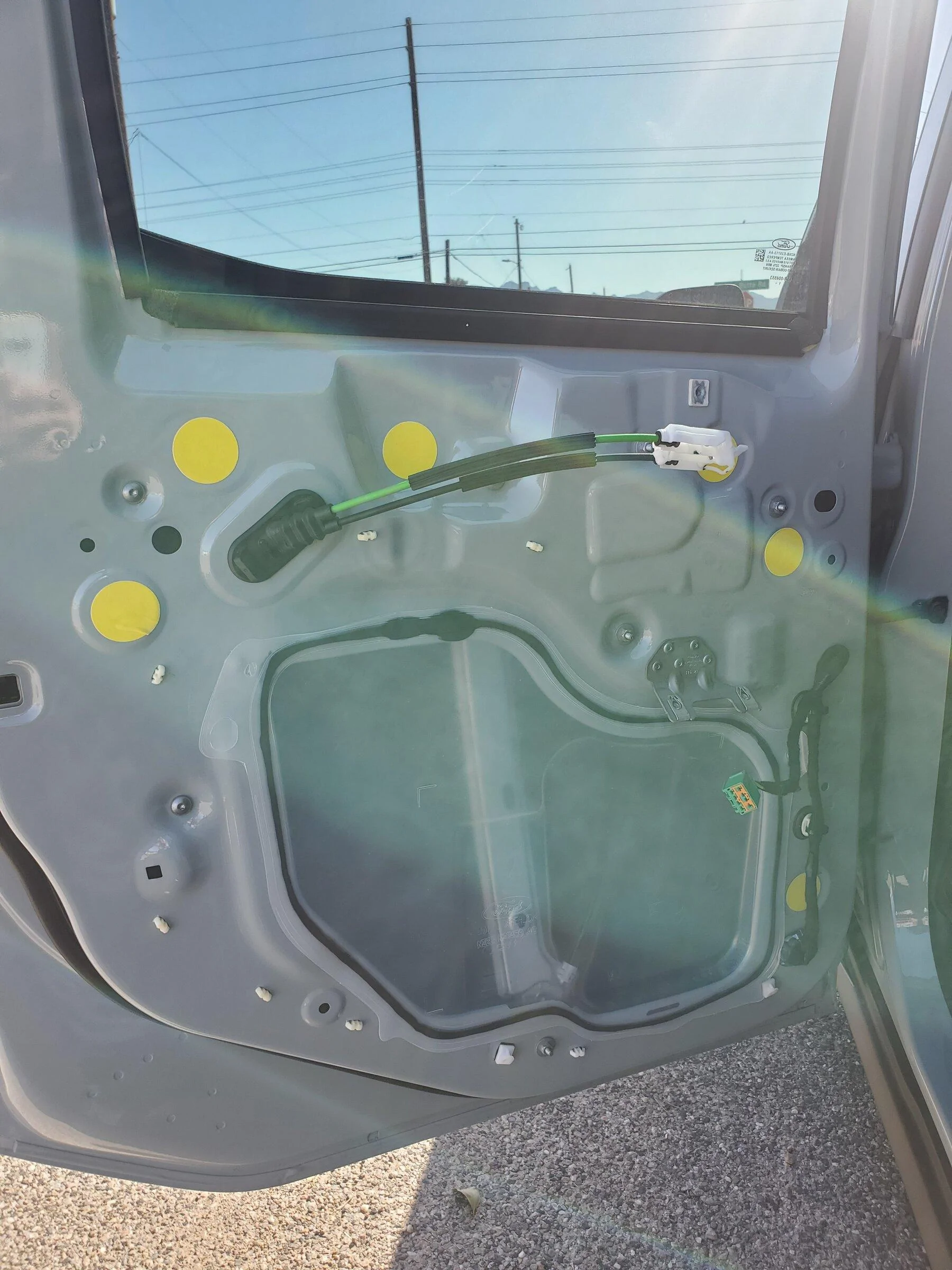

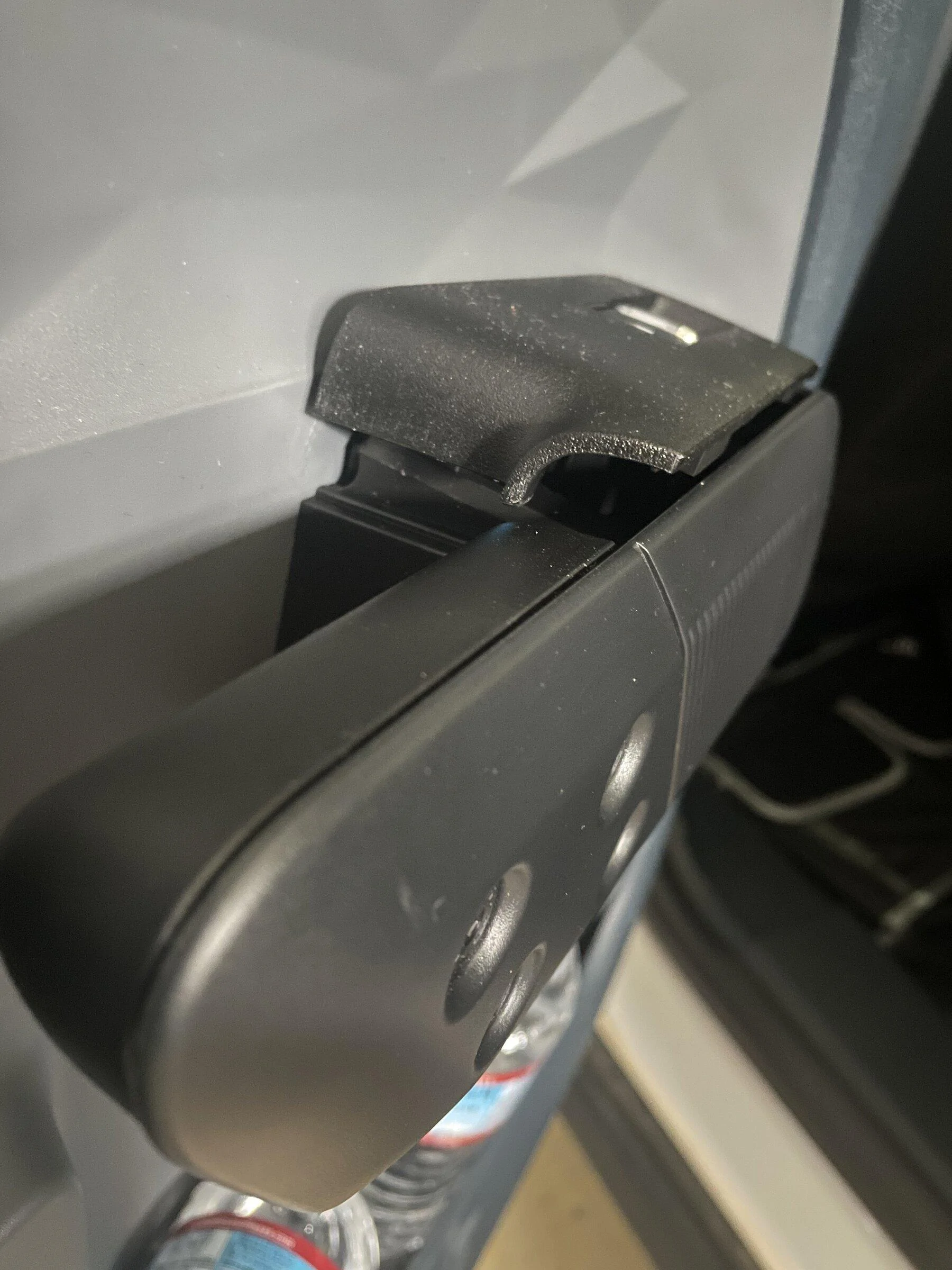

Thanks. I've done the front doors already but the rear door window switch panel seems a bit harder. Not sure where the clips are. I may just hold my breath and pull up (similar to front ones)
So true, it's definitely a nail biter... but push up nice and steady from the open end of the handle side. Then take a breath. Just be careful the door panels scratch really easy. I felt the same as you when I removed mine.
