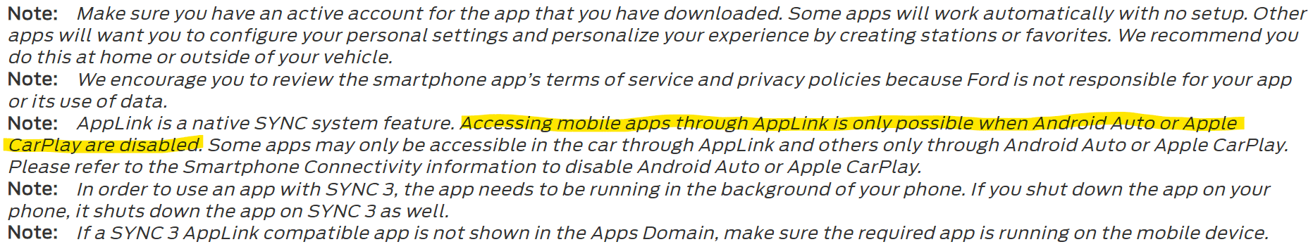

I did find this on Fords website. Is it possible the highlighted section is the reason no apps are appearing in Sync?
https://www.fordservicecontent.com/...7&vFilteringEnabled=False&div=f&buildtype=web
Great point! I had disabled Android auto as Sync won't even entertain the idea of installing apps if it's enabled. With it disabled, and will the apps like Pandora, Spotify and Waze running, I've tried installing them via Sync and keep getting the message that apps cannot be installed. Tried with three different Android based phones, multiple cables, both the USB-C and A ports. Haven't tried an iPhone yet, but if I have no luck with the iPhone, I suspect it's either a software issue with Sync or it specifically has it locked out for whatever reason.
