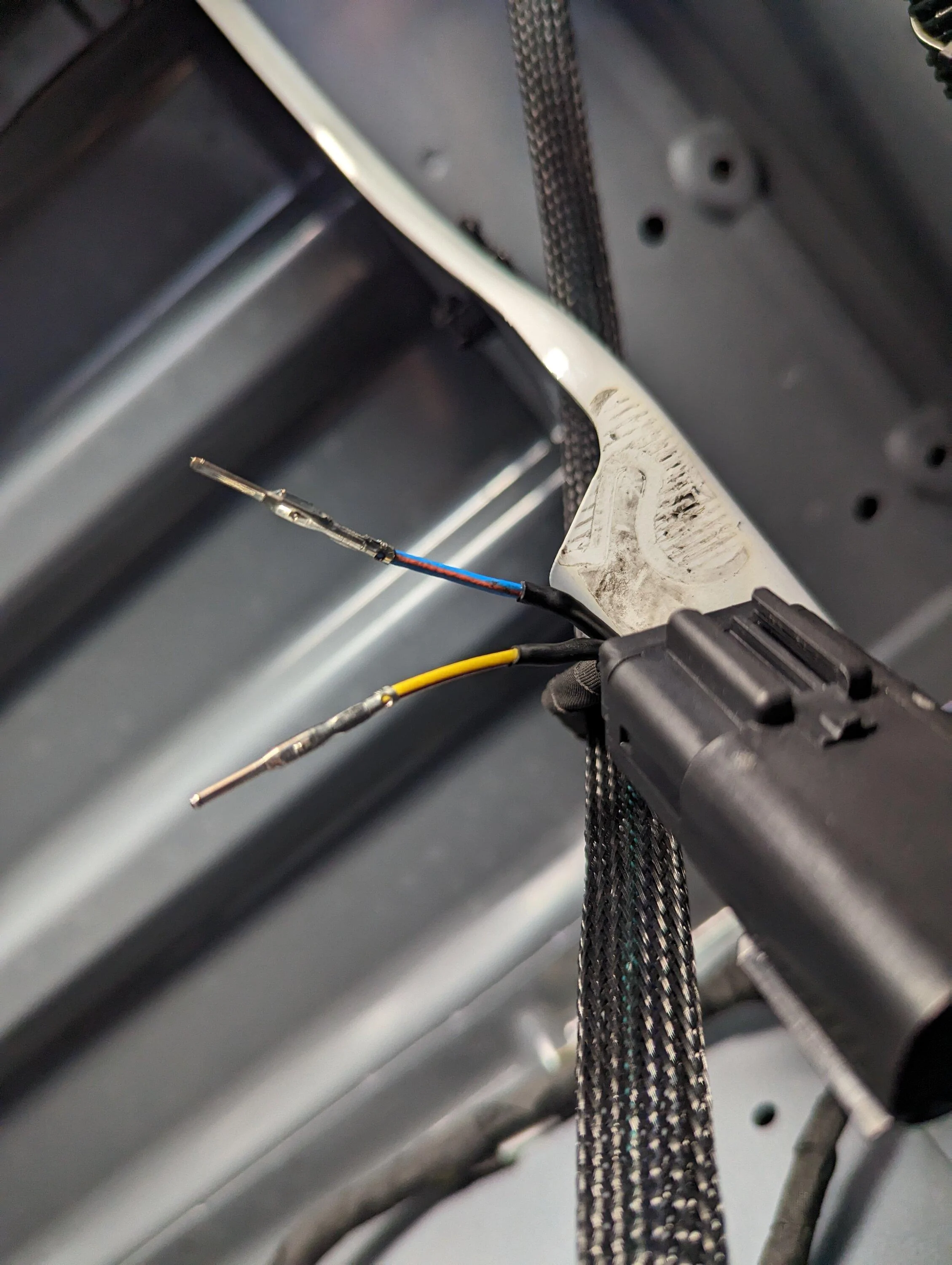

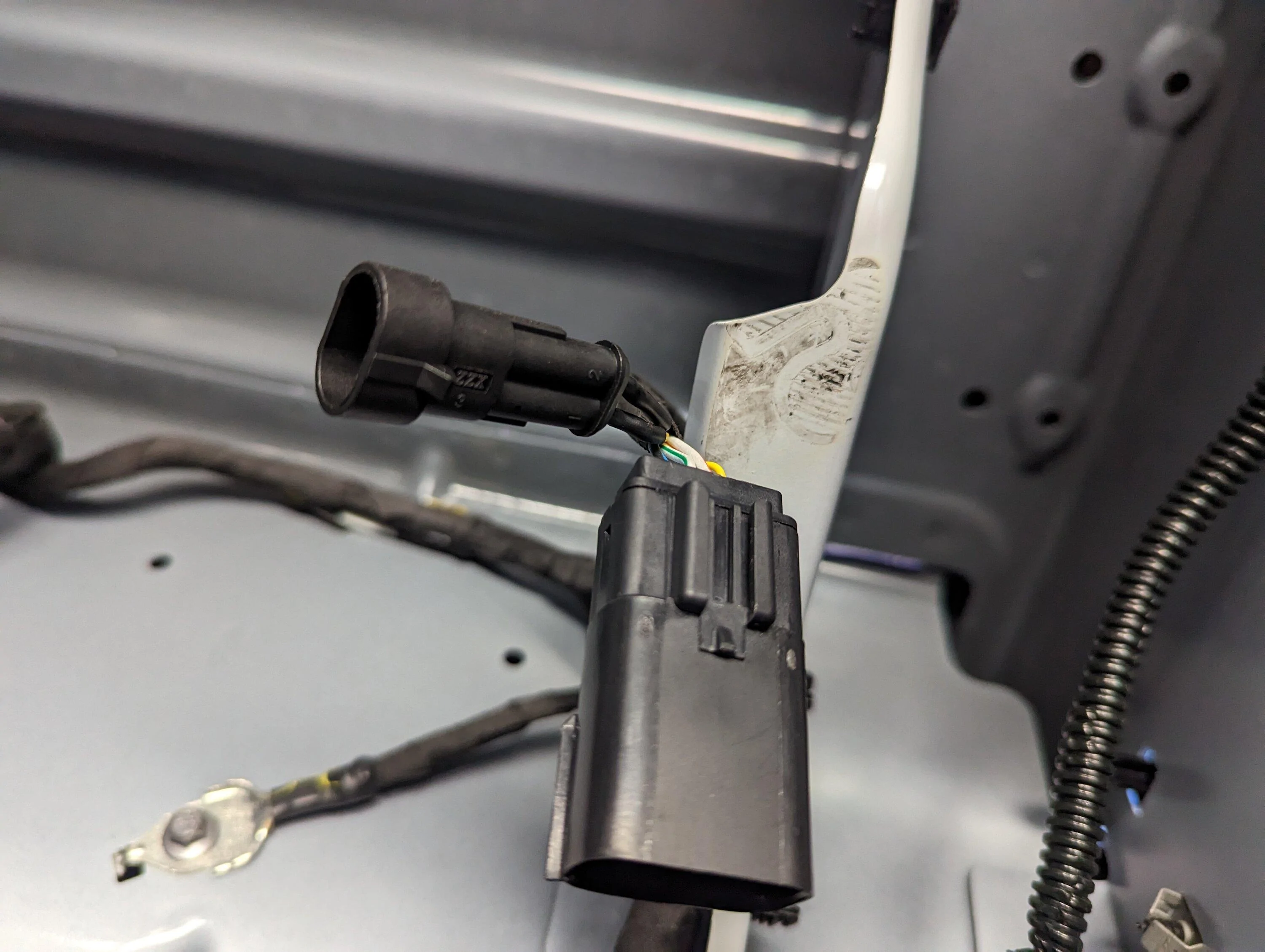

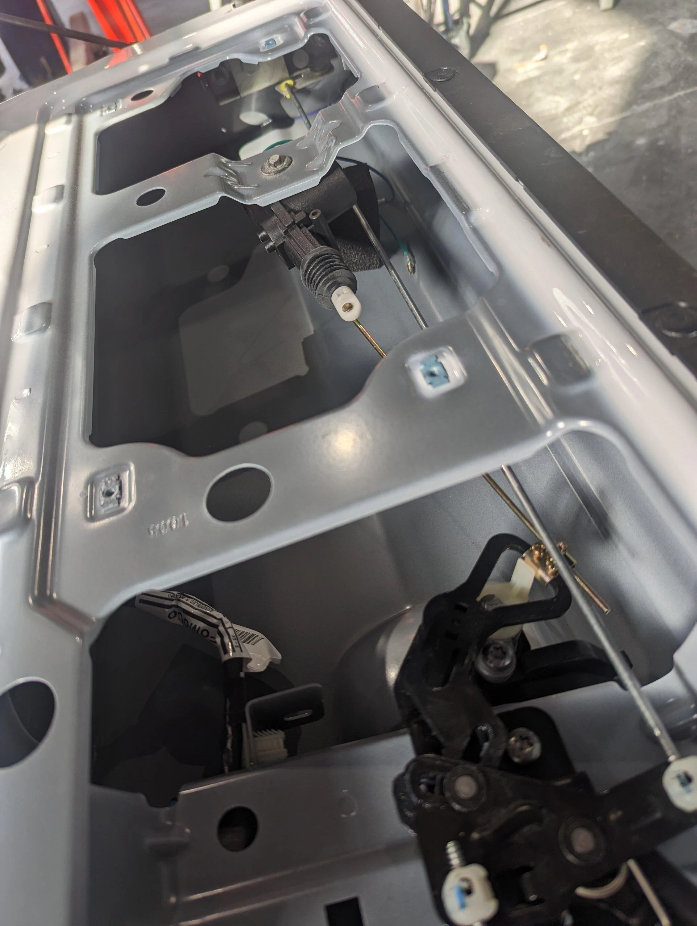

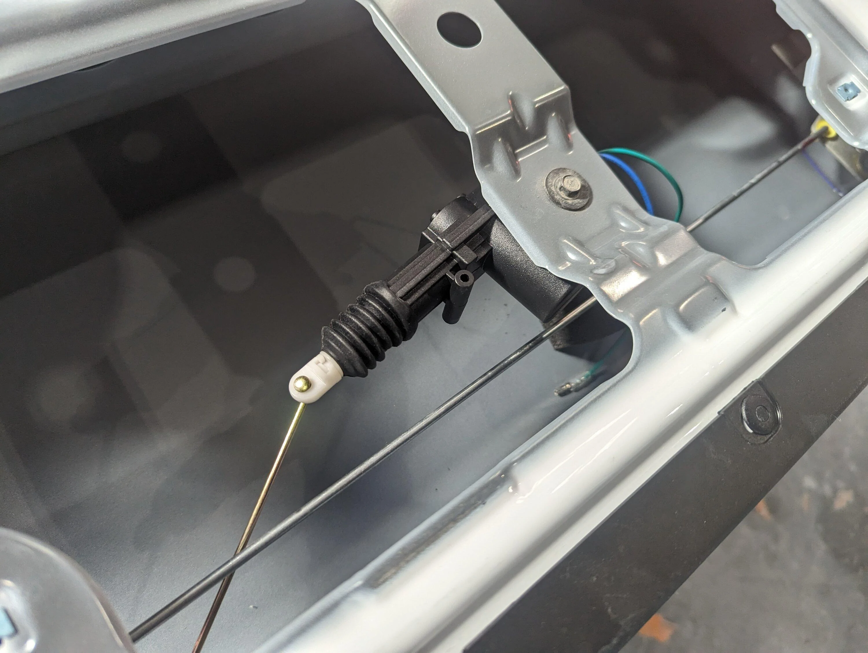

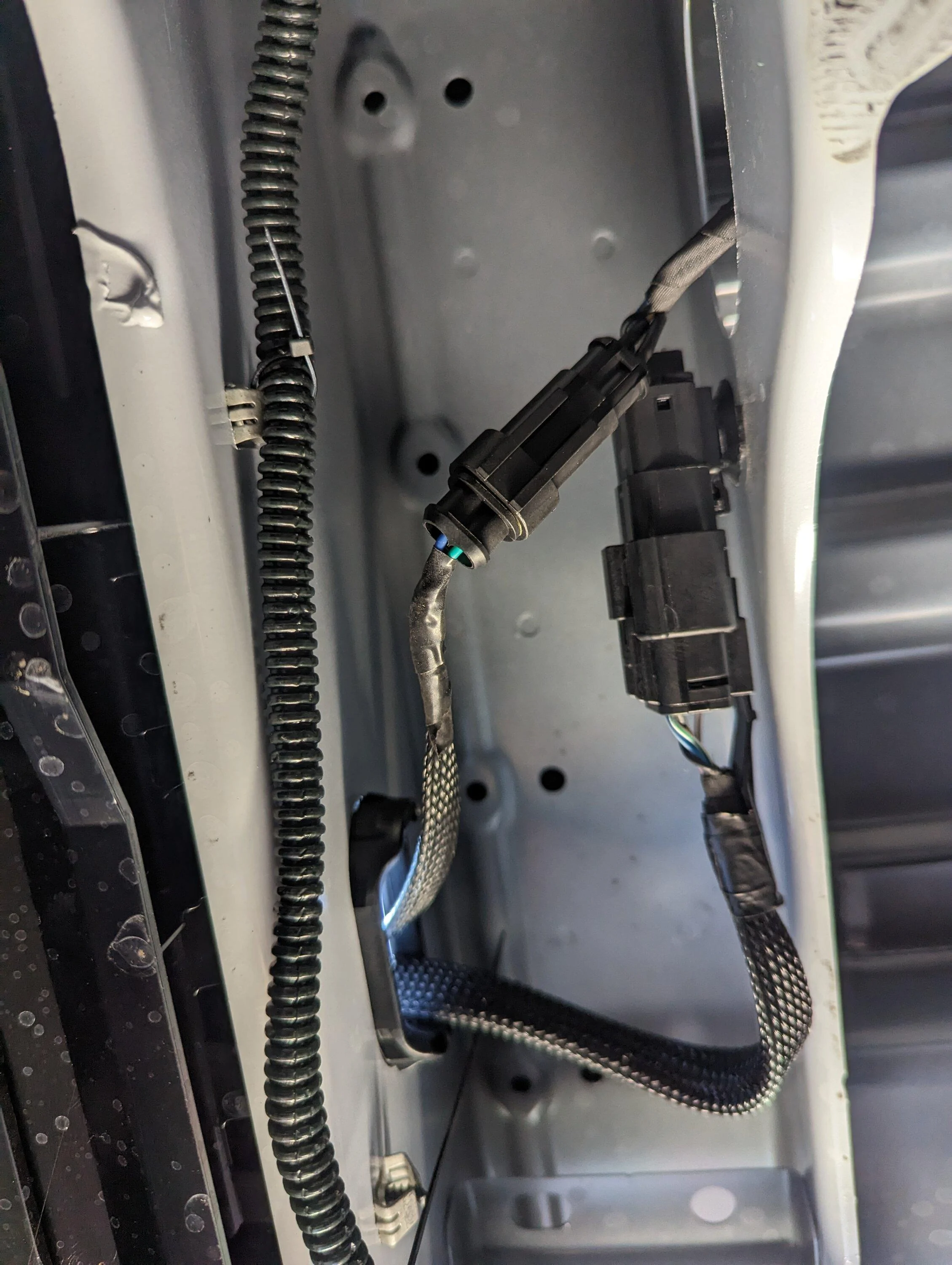

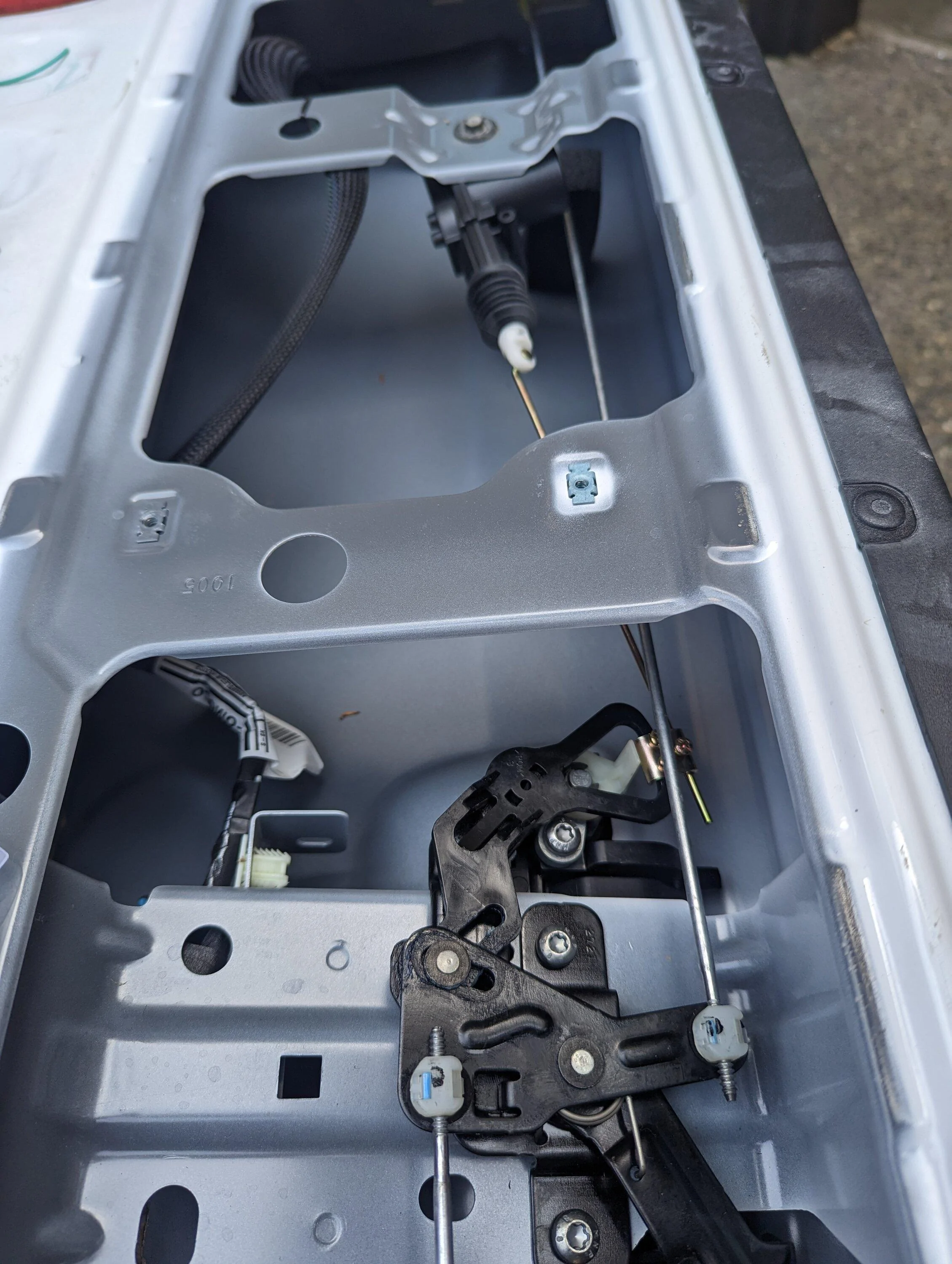

I did it for ~20$ (free cause I had the parts laying around from other projects) and it works great, just a universal door lock solenoid wired to the stock rear harness. Used existing holes and can be reversed if wanted
