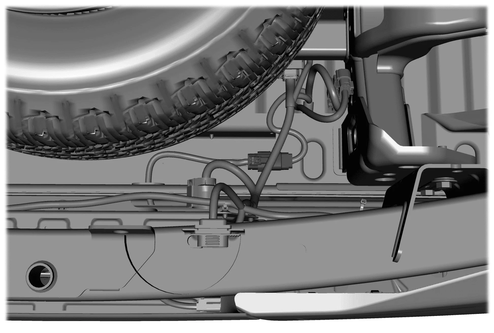

One in every crowd🤨whats the easiest way to disconnect the wire to the power tailgate lock?no,i dont need it and unless there is a way to keep it from locking when i remote start the truck its gone.i dont want to manually keep unlocking it since it want unlock when the windows do.
Owners Manual has instructions for removing the tailgate:
1. Unlatch the tailgate.
2. Disconnect the power door locks in-line
connector located under the pickup
box on the right-hand side of the
vehicle near the spare tire.
3. Install the protective cap on the end of
the in-line connector that remains
under the pickup box.
Note: A protective cap is in the glove
compartment.
Ford Maverick Easiest way to disconnect the wire to the power tailgate lock? 1683037747628
