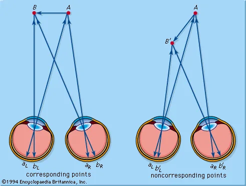

And one bit of trivia - does anyone know why pigeons and chickens bob their heads when they walk? (some lizards do the same) ...
Depth perception. Important in self driving applications. Need two eyes pointing the same direction, or a head bob and compare the different pictures. When Tesla couldn't get parking sensors (supply chain) they just wrote software to use their cameras and removed the little sensors (cheaper, easier to build).
