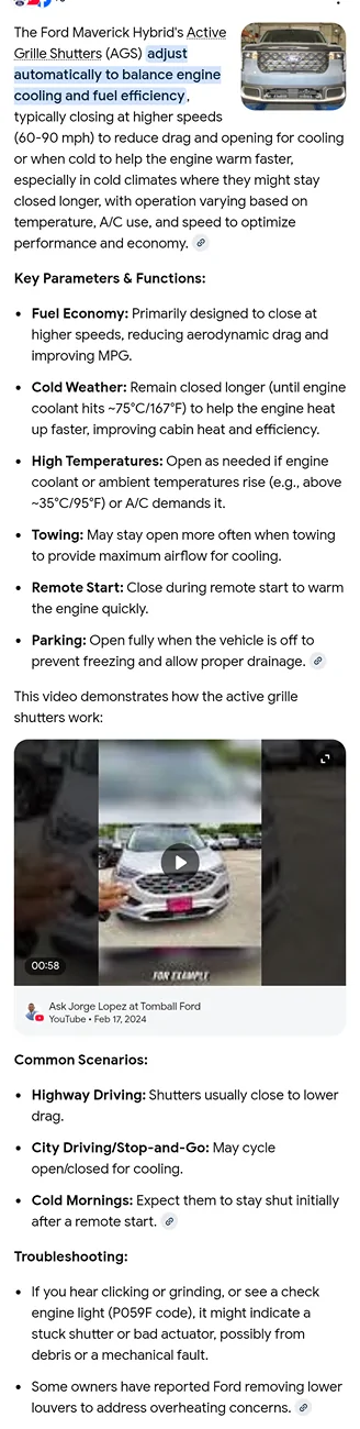

Is there a speed parameter that also effects the operation of the shutters? I've watched them through the ODB2 reader + the free version of car scanner (works with CarPLay!). I see they modulate based on engine temp, but not sure what else is figured in with the algorithm.
Found this:i
Ford Maverick Active Grill Shutters Not Working chrome_screenshot_Jan 13, 2026 10_13_03 AM CST

Found this:i
Nice find too bad what ford says here is not true on my 23 ford mav hybrid xlt.
Mine shutter opens to 46% when the temperature is below 38 degrees.
My shutters opens when the coolant get up to 210 degrees.
It does not have a sweet spot to stay open too. It will open to 20% for a while when the temperature reaches 210 degrees, , then close when the coolant drops to 195, then it will open when the temperature climbs back to 210.
The shutter my open further if the outside temperature is warmer.
The shutter opens fully when you have the AC on.
When using remote start, my shutter opens a bit and the coolant fan starts,
Its correct, when you power off the truck the shutter open too 100%, I guess they don't want it to freeze closed at 80 degrees?
I have not seen my shutter act any different when it 40 degrees or 90 degrees.
Mine seems to open and close off coolant temperature and ambient temperature doesn't have that much of a effect on operation.
I like where it said ford removed some slats that helped with over heating,
They remove some slats to move air through the engine compartment to remove any gas or oil fumes that may have accumulated from a leak that may have happened.
I guess it was easier to do that instead of fixing the leaks?
There were fires reported to have happened from gas or oil leaks that could not be vented out.
I wish the truck could be like that in the screen shot.
All this information about shutter and temperature is gathered from "car scanner" app.
