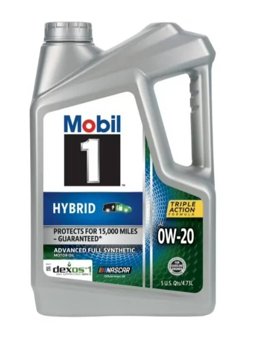

Excellent video.
Multi-parameter testing done on a dyno.
It confirmed for me, 100% synthetic
Ford Maverick AAA Article on Advantages of using Tier 1 Fuel Brands 20240924_084305
