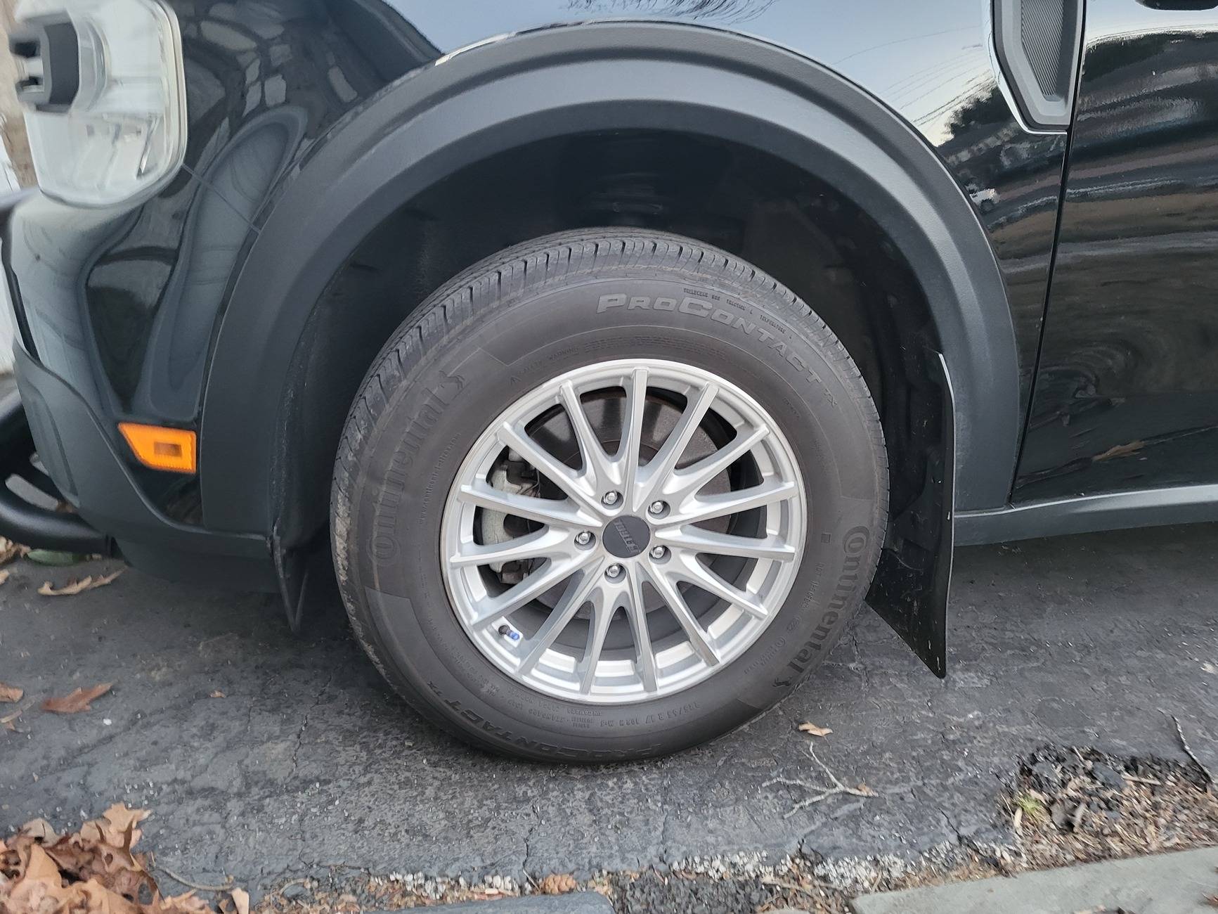

That's what I thought too, so I quickly ponied up to buy new rims (see my profile photo), but I kept the steelies as winter rims (a necessity up here). I found the silver jarring with CG, so I painted them with Dupli-Color Wheel Coating in Graphite. For my taste, this was now acceptable and not even half-bad. I think the problem with the steelies is mostly the sparkle silver, which only "works" IMO with iconic silver.
Yeah, the sparkle eventually got to me, so I replaced them with Bronco Sport take-offs.

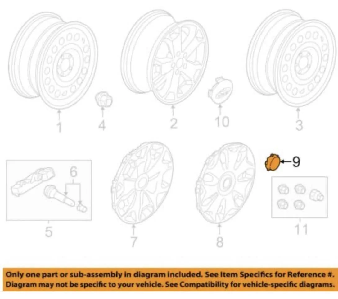

Although they don't look as cool as the Transit caps, the center caps from a Transit Connect fit with no modifications and can be ordered from your local ford dealer. Part Number: DT1Z1130A.

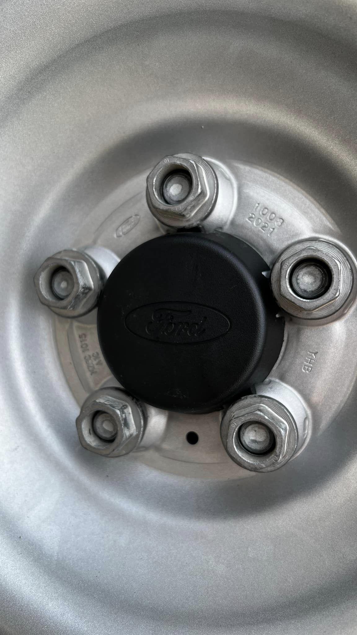

Ya, But the "Part Number" that i was looking for was... 1763878
This is what the auction discription stated:
"1 set (4 pieces) original Ford hub caps
Suitable for original Ford 15"+16" steel rims on Transit/Tourneo Custom from 2012 up to now
Easy assembly by slipping onto the wheel nuts
Color: black, material: plastic
Outer diameter approx. 24.5 cm
Ford part number: 1763878"
And this is what I got...
Not sure what happen here.. But, these caps have the 5/180mm spacing..
Upset, NO
Since, the American Connects did not come with this option.
I was at the start already thinking of ... "Plan B".
It was just a long, long, long shot that I couldn't pass up.
If it had worked! I would have had the problem of (waiting) in replacing one if lost.
As it turned out, I can easily replace one, now by a local source.
Also, I simplified the work on the 'Spacers".
I did spend a few hours on each, filing and beveling them to get the right gap (7/16 in) and the maximum surface area. That way I could ensure that the bonding adhesive would have the greatest chance to hold.
I was relieved when each cap, snapped ON with a resounding "Click"... ;)

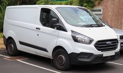

Ford Maverick A "Transit" solution to the Maverick steelies 2018_Ford_Transit_Custom_300_Base_2.0_facelift
The European Ford Transit (Tourneo Connect/Custom)
was suppose to have the same lug spacing, (108mm/4.25") as the American Maverick.
https://www.wheel-size.com/pcd/5x4.25/
It did NOT.
So, being the DIY-guy. I was determined to see this project though..
And so... the Project and Thread... ;)
