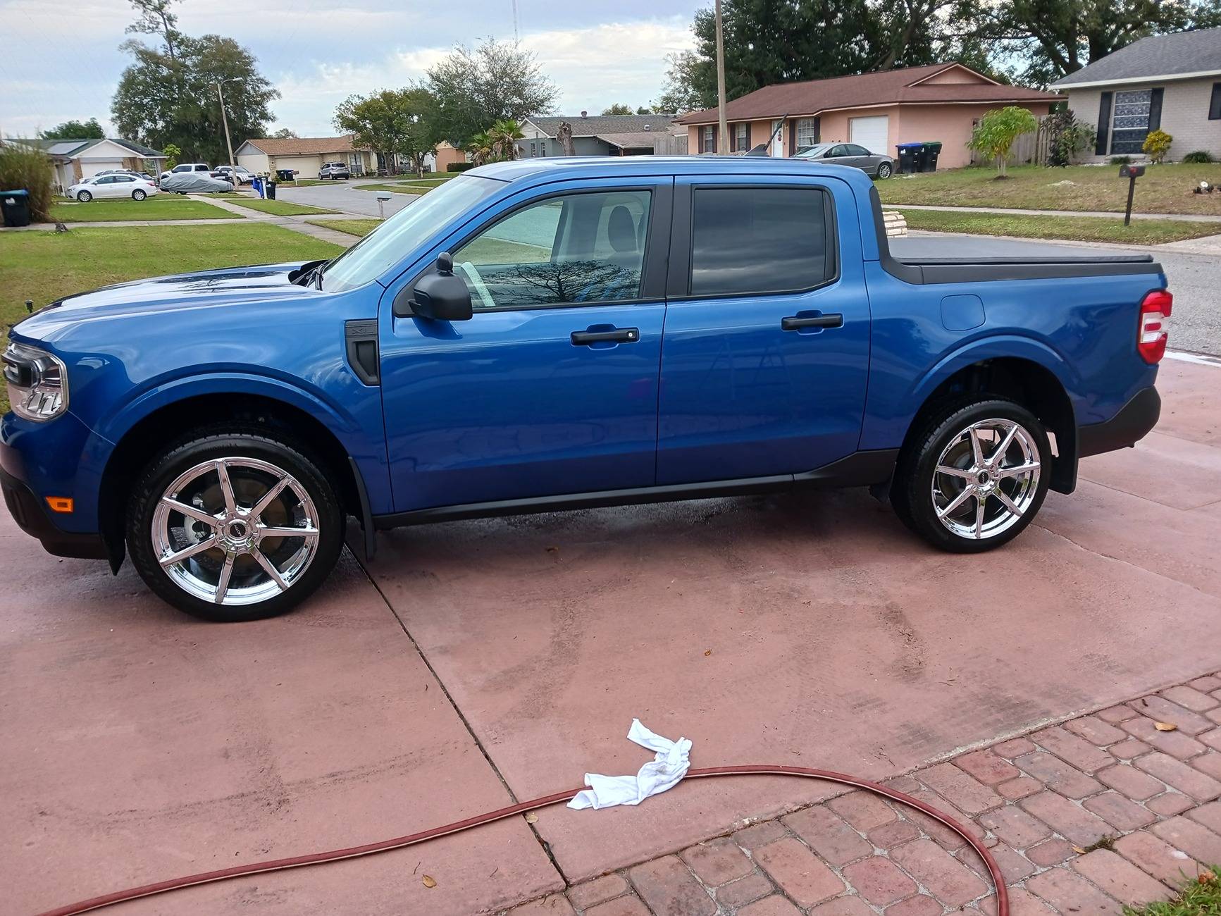

So Happy with Discount Tire, Jose, Mike and the whole crew in Apopka, Florida. This is my 6th.set of rims and tires from them in 25 yrs. I am kind of picky, so I like chrome( old school) ,open design ,so I can clean inside rim easily, no extra bolts and screws to catch wax,and a center cap to cover lugs. Discount was able, when I found the wheel I like, to order for me (Motiv#432c, 20×8.5 5-108 )and I bought them and new continental control contact sport srs+ tires. 245/45 R20.
So even if Discount does not have the rims you like, find them and they can order from manufacture for you,love this.
The original Continental tires have 1 ply sidewall, which I did not like, so changed out at 5400 miles. Funny how tires on truck were single ply sidewall and full spare ( atlas brand) has 2 ply sidewall. Just an observation. Thanks again Discount tire,costumer for life.
this is what I got on my 23xl

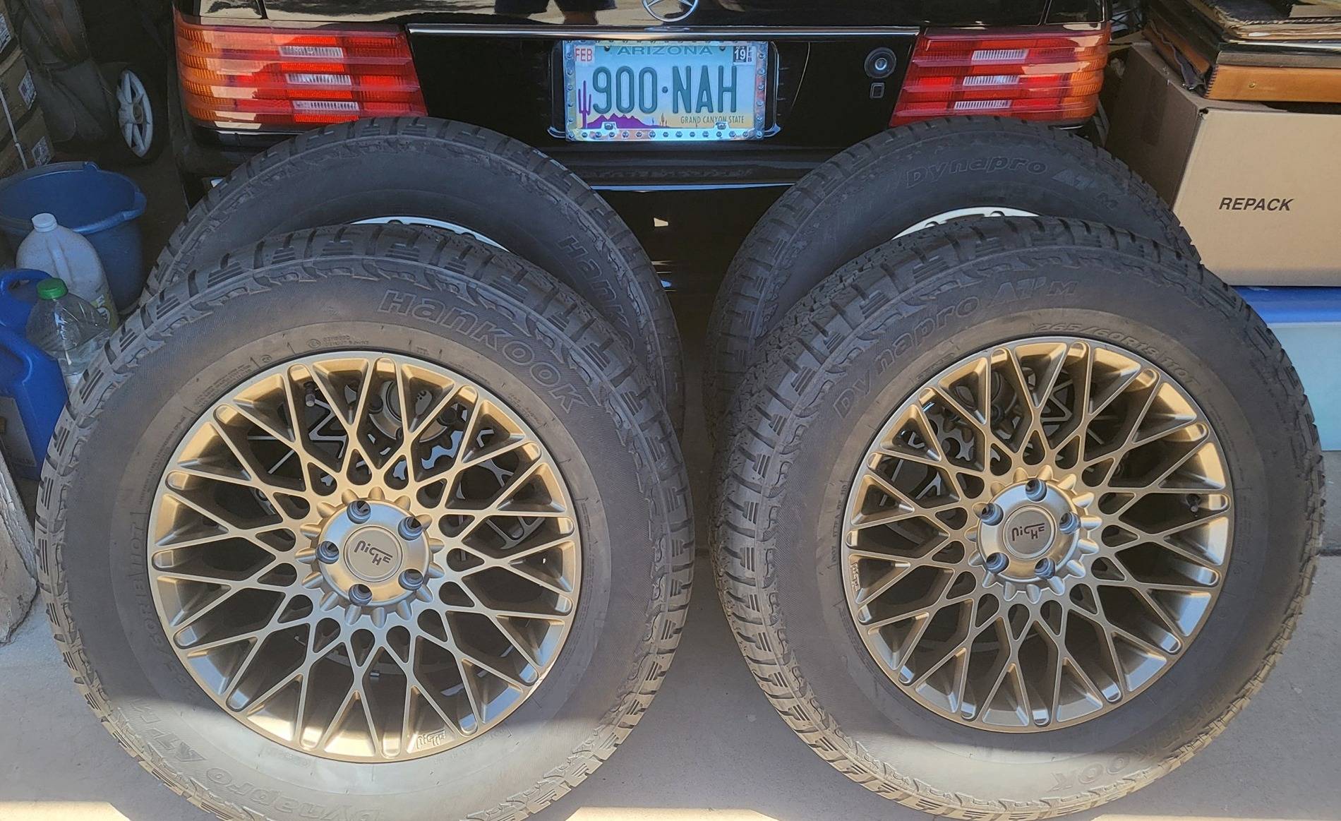

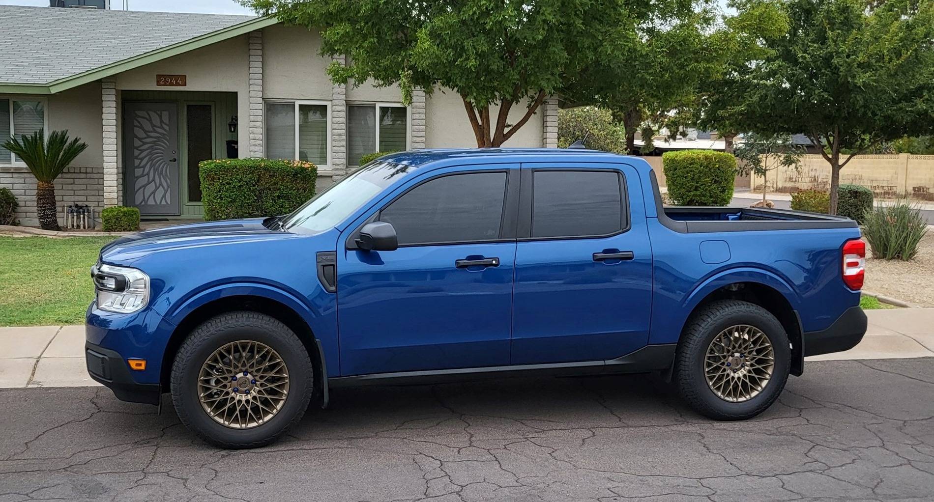

Too bad you are so far away. I have these available in Phoenix. They were on my AWD before I put the steelies back on to trade it in. Anybody interested? pm me. No rubbing on stock suspension.
