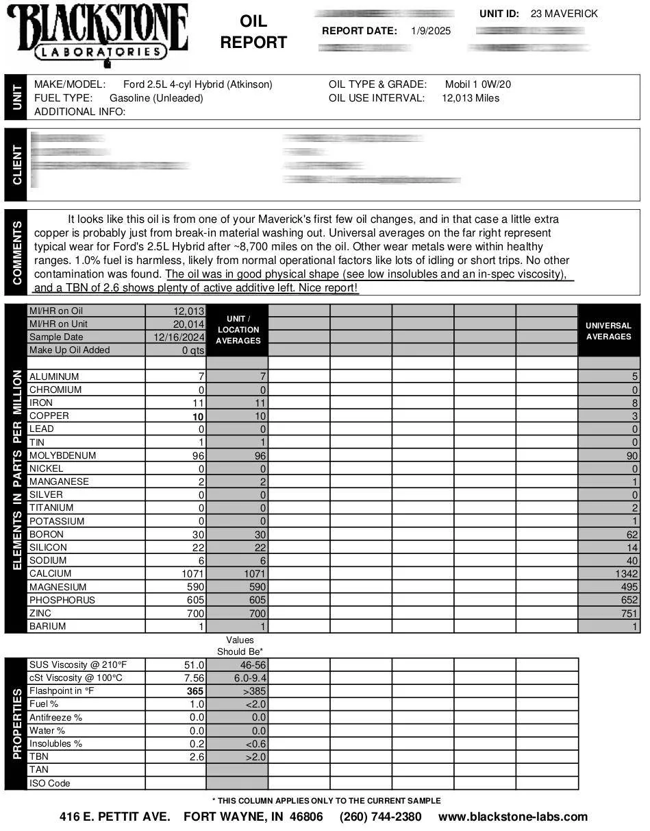

Doesn't matter to me. I am not going over 6000 miles. Oil is cheap. Engines are expensive.
Blackstone's analysis for Hybrid says a much longer interval on the Hybrid w/ full synthetic (not ecoboost) is fine. 12k ODO analysis was mostly non-highway miles. If a Hybrid is driven almost all highway, the OLM will recommend a much shorter interval.
I trust Blackstone analysis.
You do what you want with your vehicle. Mine is getting an oil change every 5-6k or one year.
His post was useful, yours, not so much. I'm happy for you anyways.
