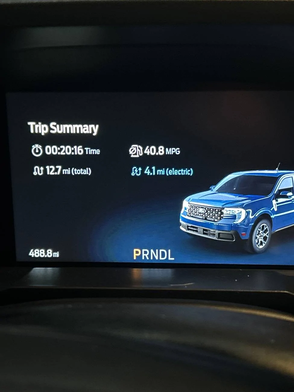

Got it, - I have a 2 week old hv awd and am trying to figure this stuff out as well and get the best milage - trying to remember to put it in Eco (crazy it doesn't go back to that mode once u select it) and pull up "This Trip" card (crazy it also doesn't go back to that once u select it too!) The stats on your trip don't help me w that because neither leg was Eco, but hopefully we all figure it out.
