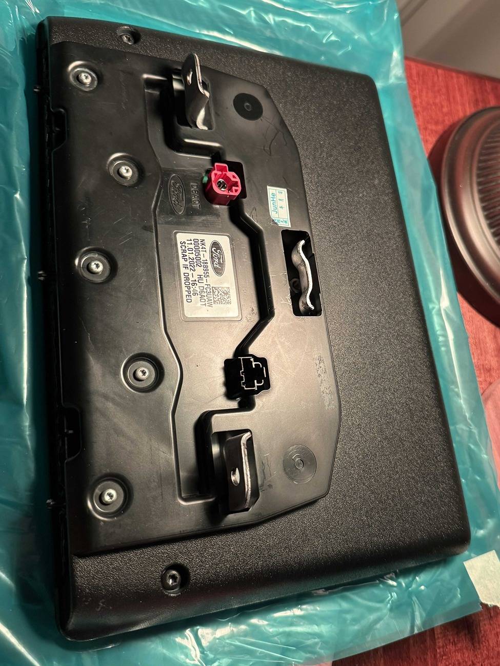

  5. Disassemble the Transit screen from the housing and snip off the three little black “pins” sticking out from the bottom. Not doing this can make mounting the screen squarely to the dash difficult, at least for me.

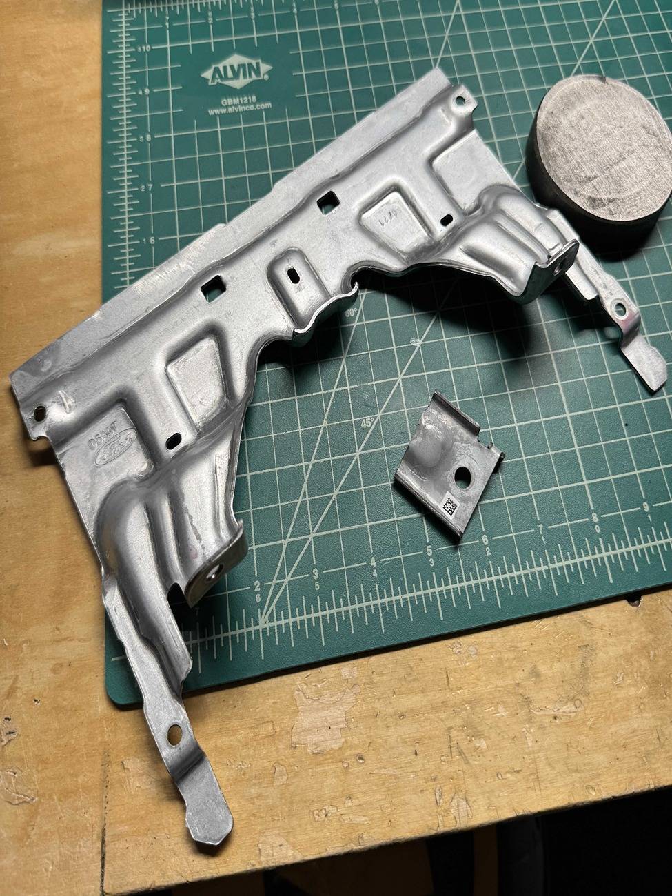

  6. While the housing is off of the screen, remove the metal screen bracket from the LCD carefully, and cut off enough of the central mounting tab so it is at least flush with the outside plastic housing when reinstalled. This allows you mount the screen more securely later.

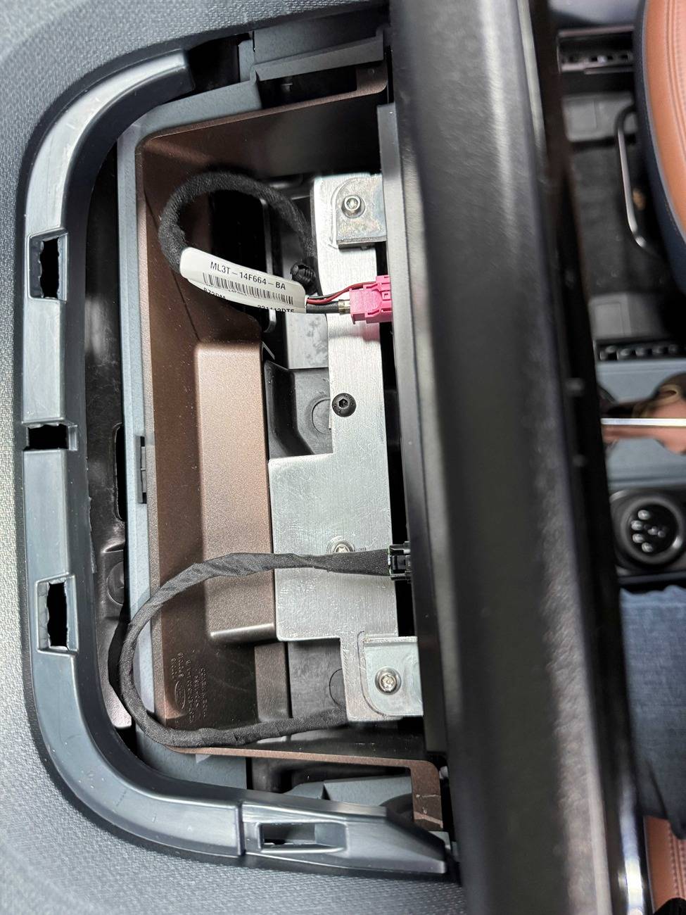

  8. No one was kidding, removing the factory APIM from the dash was a NIGHTMARE. It can and will cut you, scratch up your plastic interior, and came close to nicking some nearby wiring harnesses during removal/install.
    • I found carefully rotating the APIM 90deg left of right so you can get better access to unplug cables…things will still be very tight to get a hand in for unplugging.
  9. Plug in all new parts (screen, passthrough harness, APIM, climate knobs, etc…) carefully and turn ignition to ON.

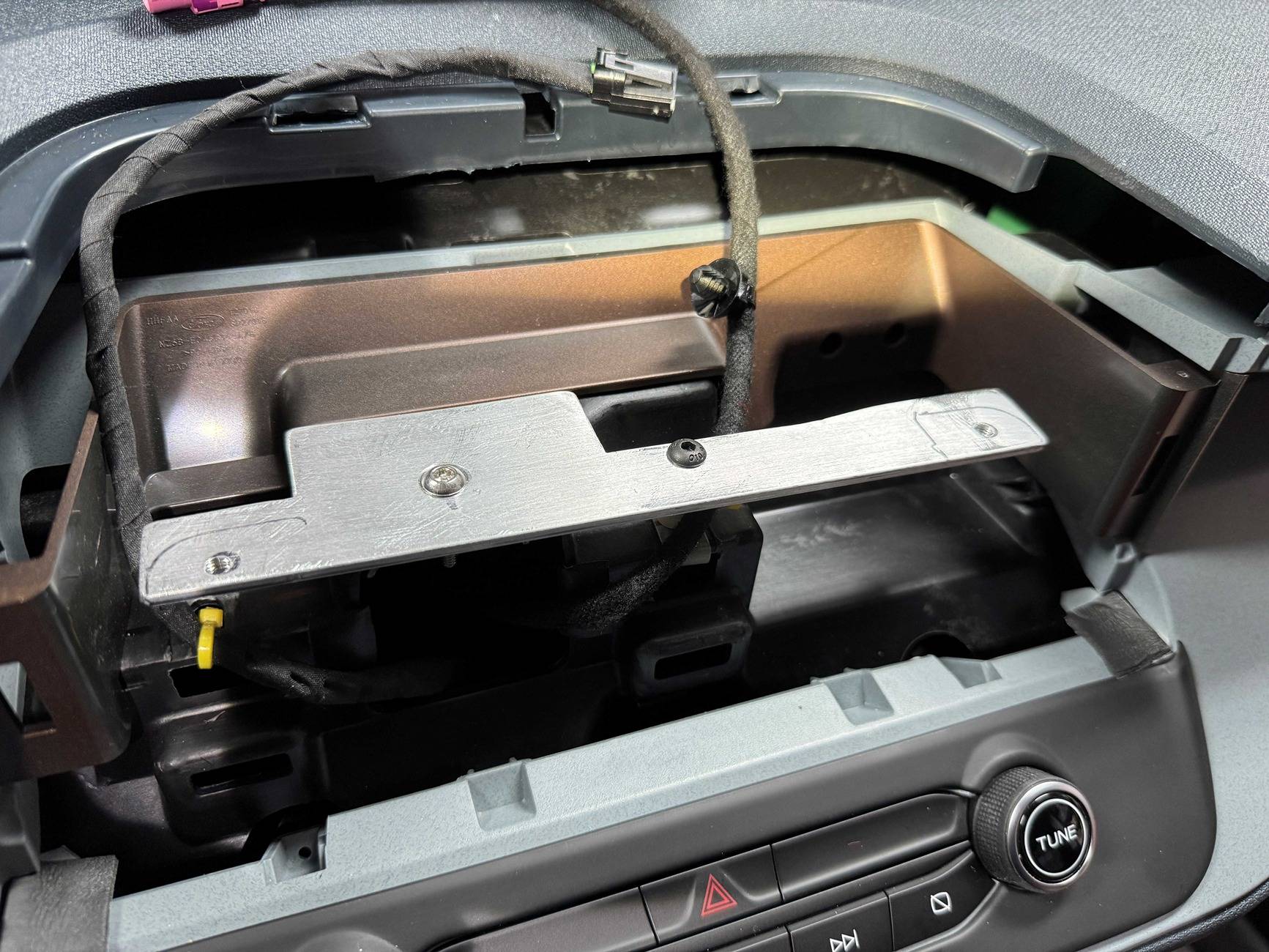

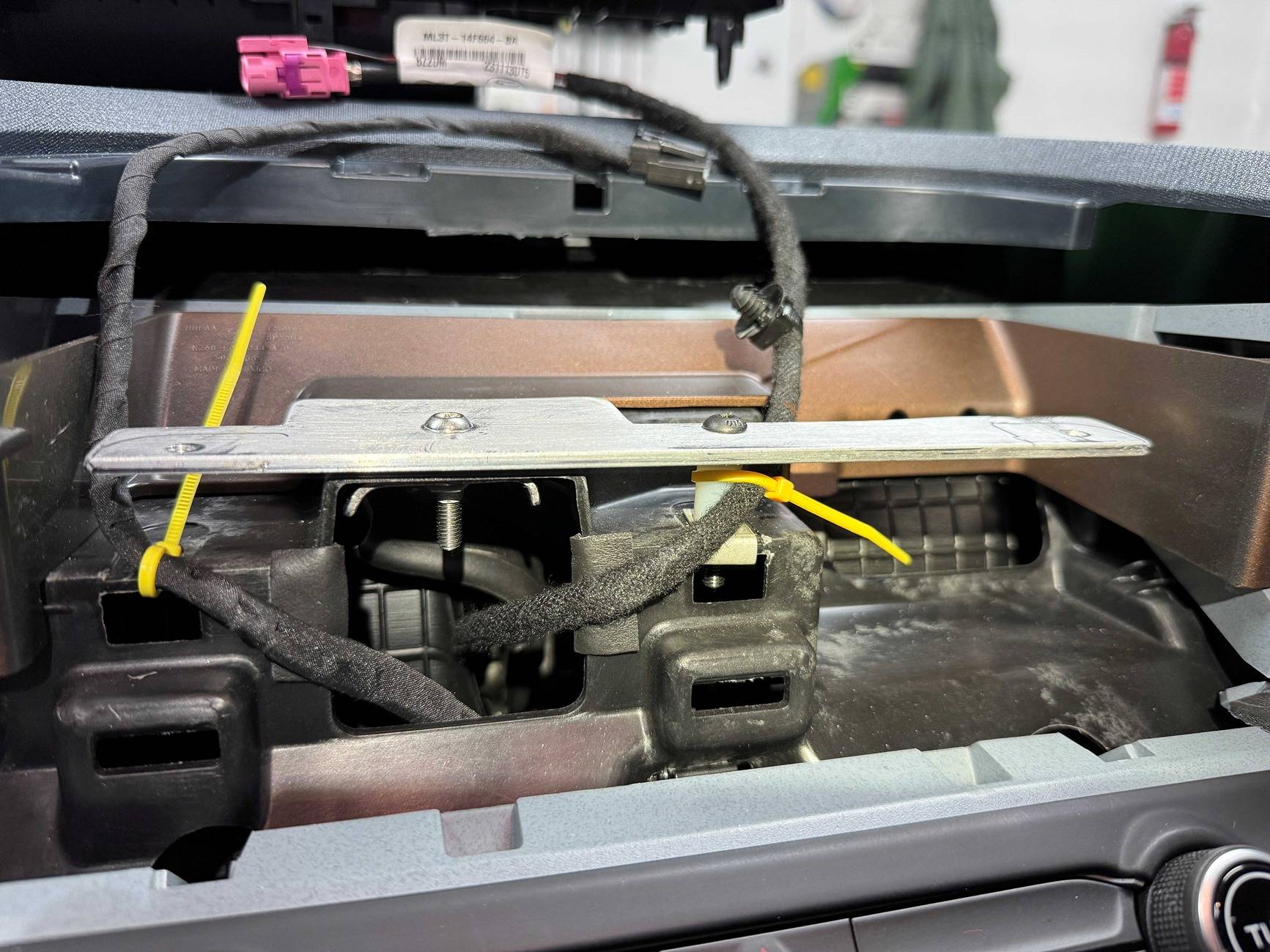

  12. Use the aluminum bar stock to layout where the CENTER dash mounting hole from the OEM screen will be, and also the PASSENGER side mounting hole for stability.
    • This is very important for Audio quality…the center screw hole in the dash from the original screen is the only grounded mount to the car frame (image). This made a pretty big difference for me.
  13. We chose to use our own M5x30mm bolts to mounting our cut aluminum bar stock using through holes, and then drilled and tapped hole on the ends for the Transit screen mount after tracing the layout.
    Ford Maverick 2022-2024 Sync4 APIM and 12" Screen Installation DIY Guide (Lariat Models) 190146-b136d3fc98c7e4612b2d1041e0646120
    Ford Maverick 2022-2024 Sync4 APIM and 12" Screen Installation DIY Guide (Lariat Models) 190147-6cf466a5d5772d2488cf419b9a04d723
  14. If you cut off the center metal tab on the screen housing mount, you can reinstall the factory begin screen tray without any modification.
    • We used some 3/8-1/2in sections of heatshrink tubing to fill the gaps next to the screen until I can 3D print something (maybe at a later date).
