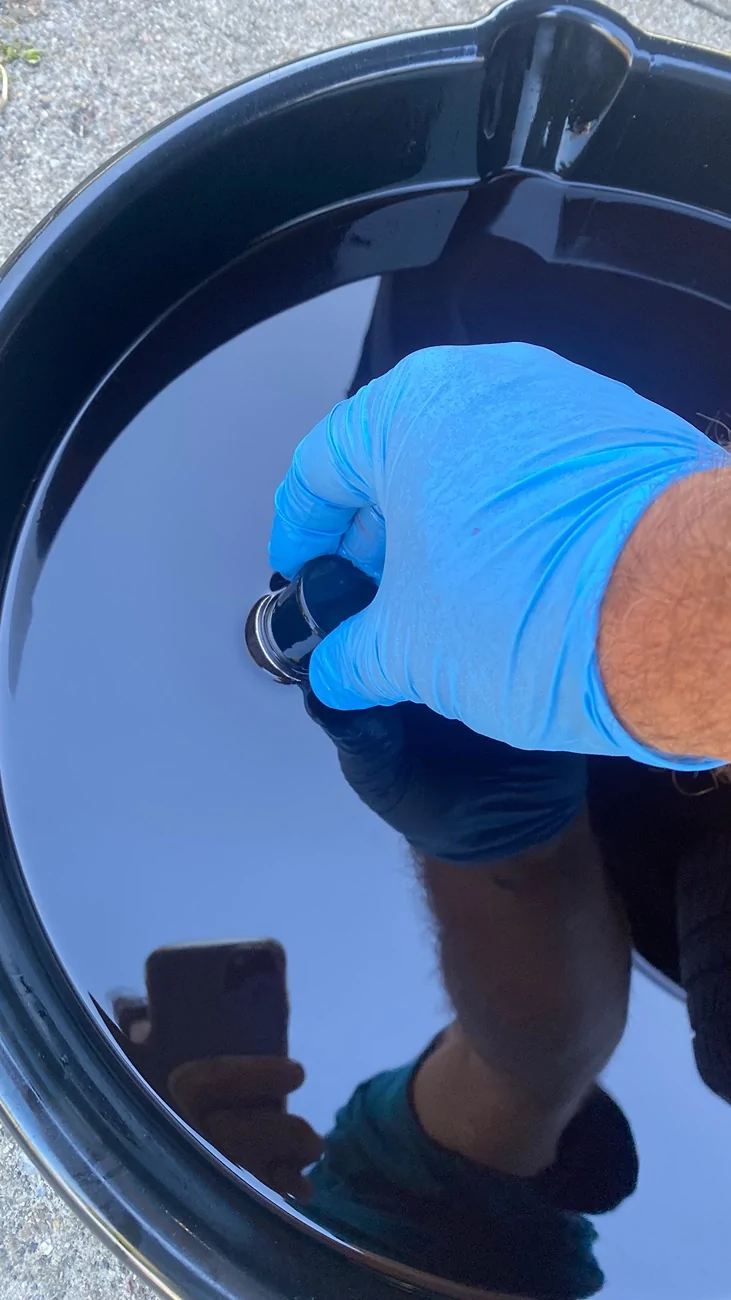

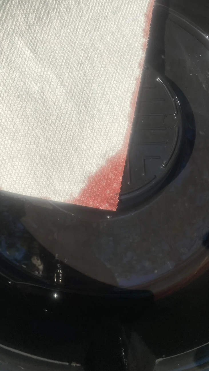

Because I tow a lot (25% of the time) and it looked easy to do, I changed my hybrid transmission oil.
A) It was easy to do
B) I think it was too soon
C) I think I wasted time and money

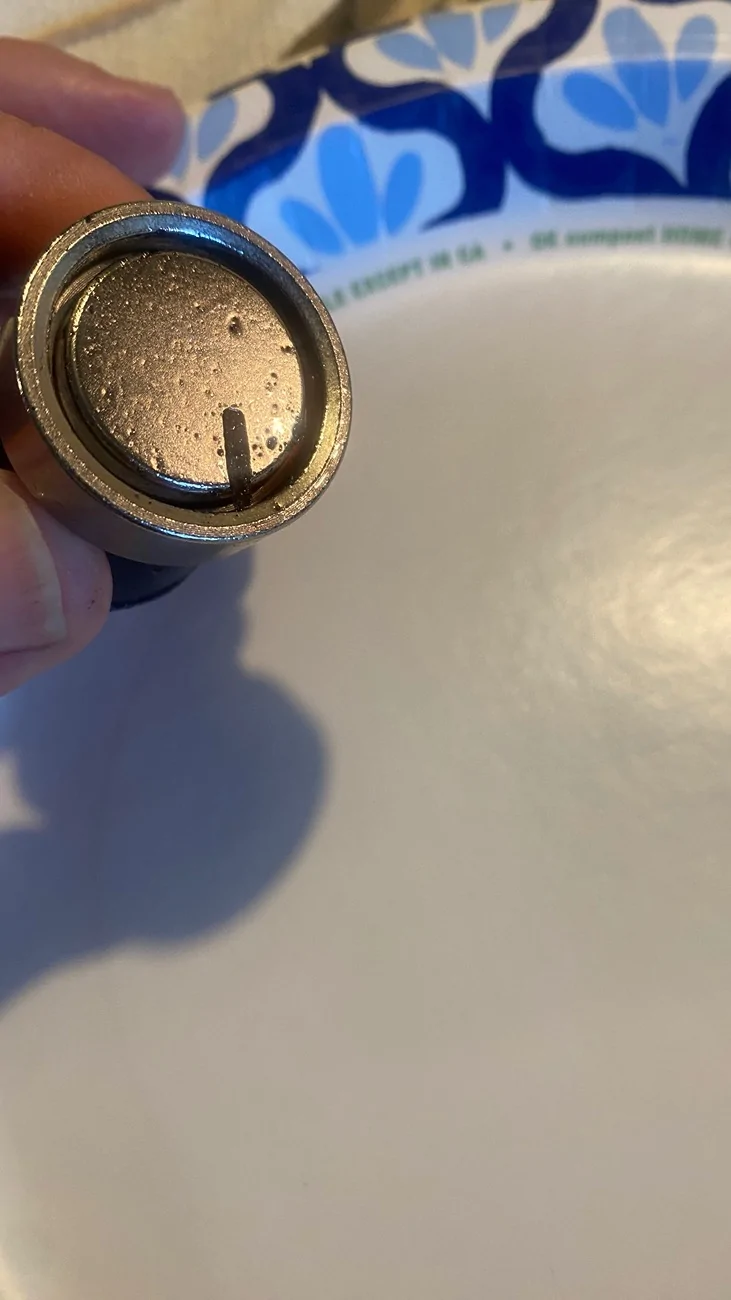

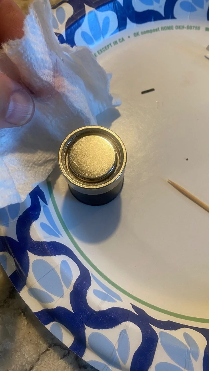

Oil was CLEAN. REALLY clean.
Did not see much in the way of dirt or metal particles.
I dredged the oil pan with a powerful magnet for 5 minutes and only found one flake and about 3 grain of sand sized particles. None of the "glitter" I have read about.
Oil was transparent and wine colored.
When I wiped the magnet off there was virtually no soil on the paper towel.
Color me shocked. Impressed. Relieved. Sad I did it too soon all at the same time.
2022 FWD HF45 towing 3200 lbs 25% of the miles.
Ford Maverick Shocking Hybrid Transmission Fluid Change at 65k miles IMG_9061
Ford Maverick Shocking Hybrid Transmission Fluid Change at 65k miles IMG_9035

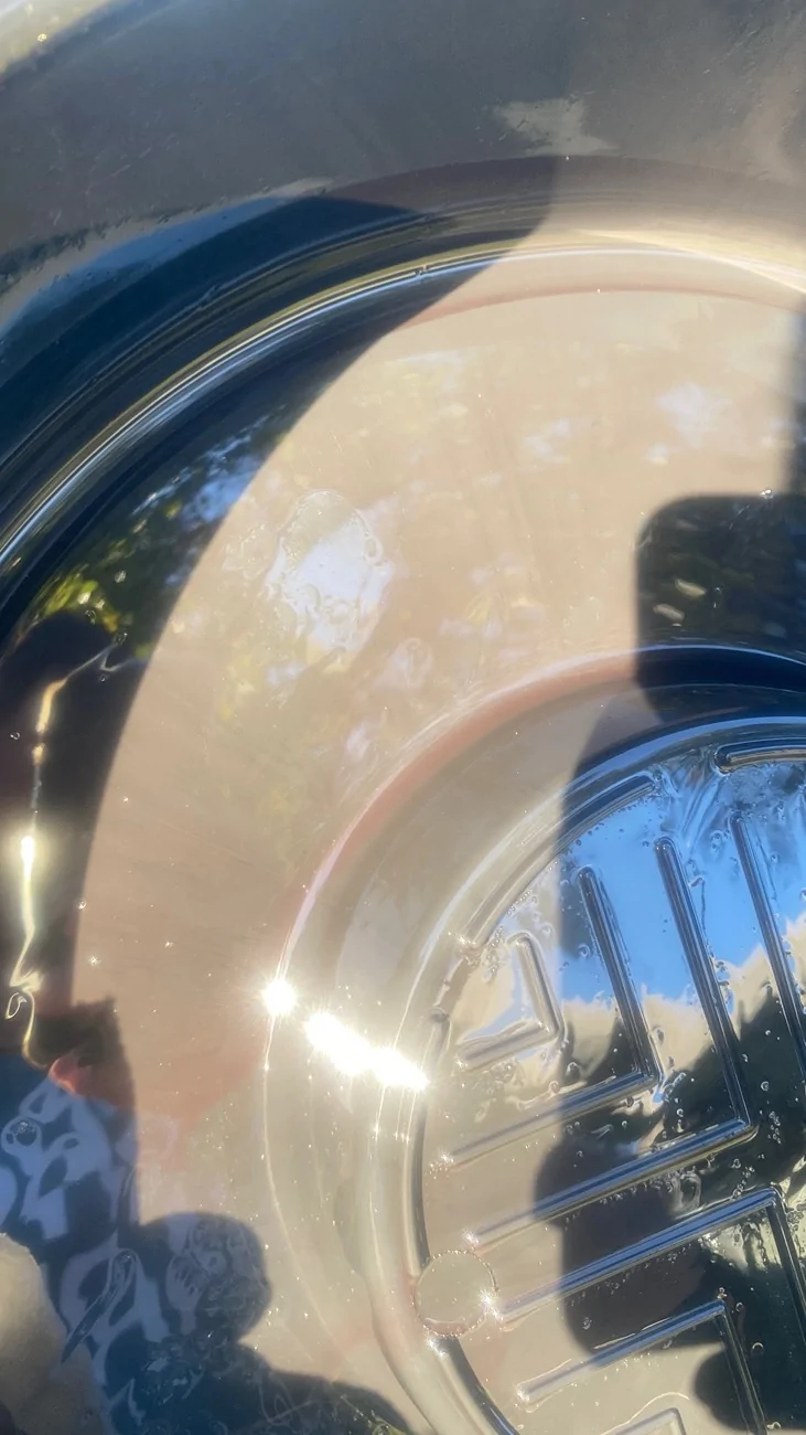

Bottom of the pan after 1 hour of settling. Clean
Ford Maverick Shocking Hybrid Transmission Fluid Change at 65k miles IMG_9052
Magnet: one flake and a few grains. No "dust". No "silt". No "glitter".
Ford Maverick Shocking Hybrid Transmission Fluid Change at 65k miles IMG_9054
The magnet has a texture. And you are seeing some air bubbles. No soil when wiped with a white paper towel.
Ford Maverick Shocking Hybrid Transmission Fluid Change at 65k miles IMG_9060
Rectangular flake: theory: was part of the oil pan casting / or fill plug threads. The fill plug was VERY tight and took a few attempts to get out. Eventually using a 1/2" drive socket wrench and 18" handle.

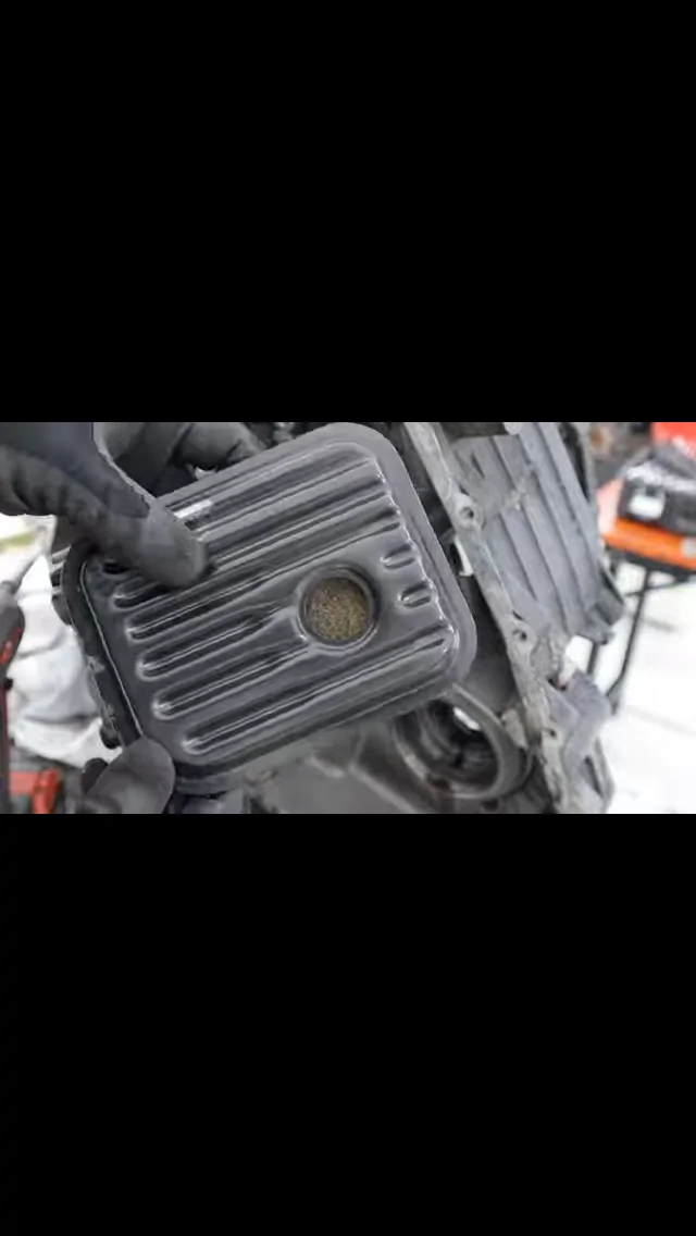

Great write up and good preventative maintenance! Your irreplaceable filter appreciates it for sure. Remember, the oil you drained flowed through your filter many many times. That one metal speck you found is “fresh” and would have been picked up by the filter during next flow through.
Your filter has specks in it for sure;)
