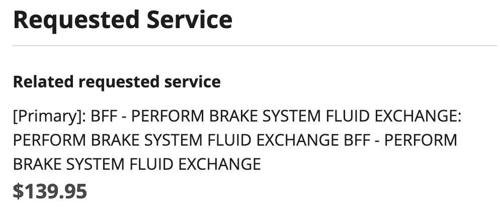

Im sure prices vary but I trusted this particular dealership.
Every 3 years I can put aside $46.65 💪

Thanks for the info. I've checked with (1) dealer so far and they quoted me $174.95 for a brake fluid flush so quite a bit higher than your quote. I have several dealers around me so I'll be sure and call around.
