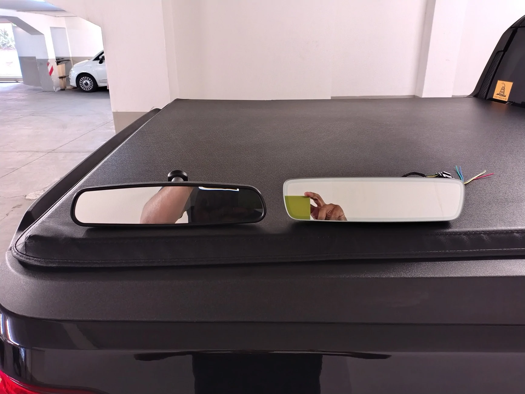

Swapped my interior mirror with the Mustang Mach-e autodimming mirror.
Ford Maverick Mach-E Frameless Rearview Autodimming Mirror - install DIY IMG_20260418_085710357_HDR

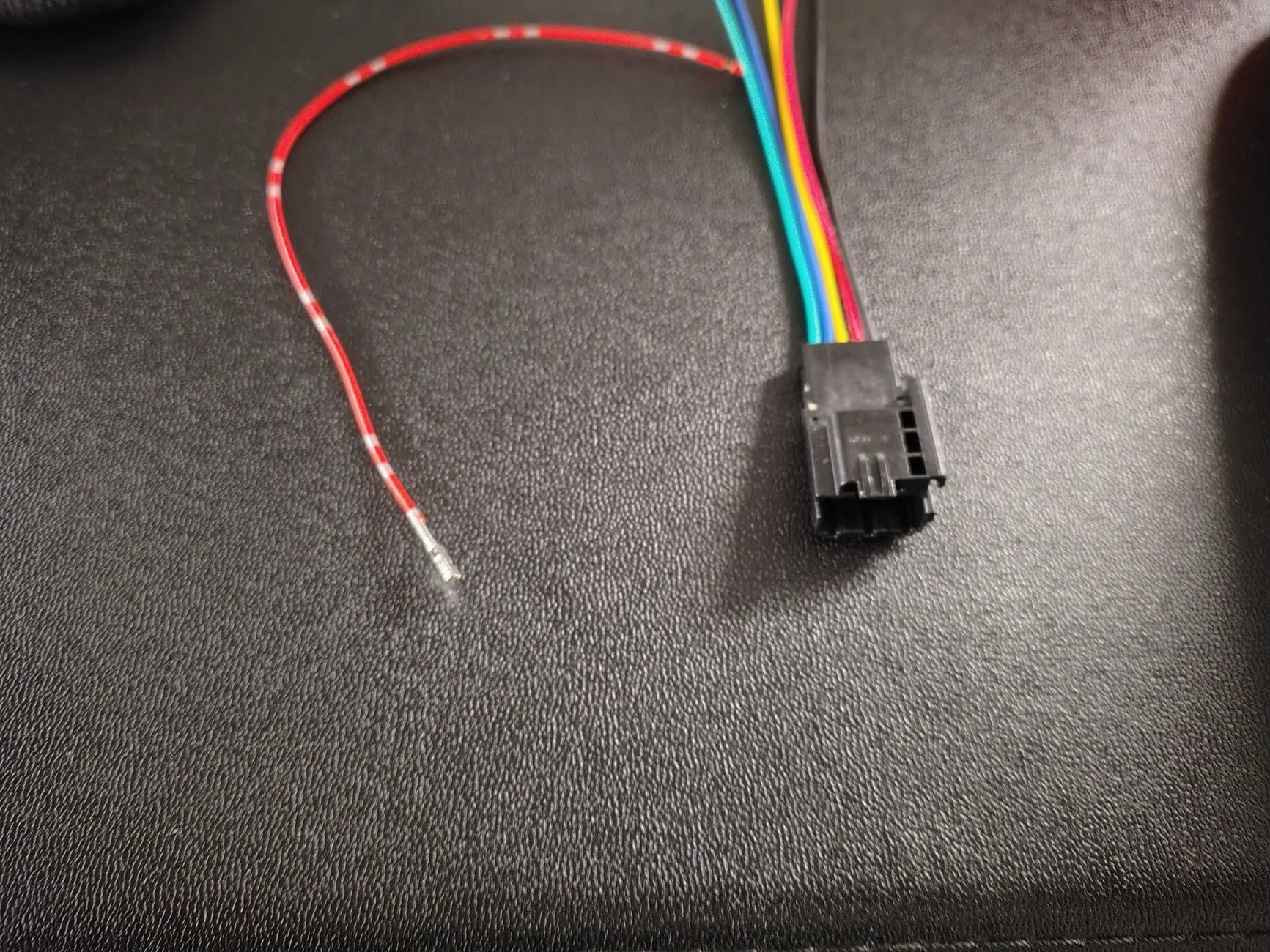

I buy from Aliexpress the Connector plus a female pin for the BCM.
Ford Maverick Mach-E Frameless Rearview Autodimming Mirror - install DIY IMG_20260418_091526813_HDR

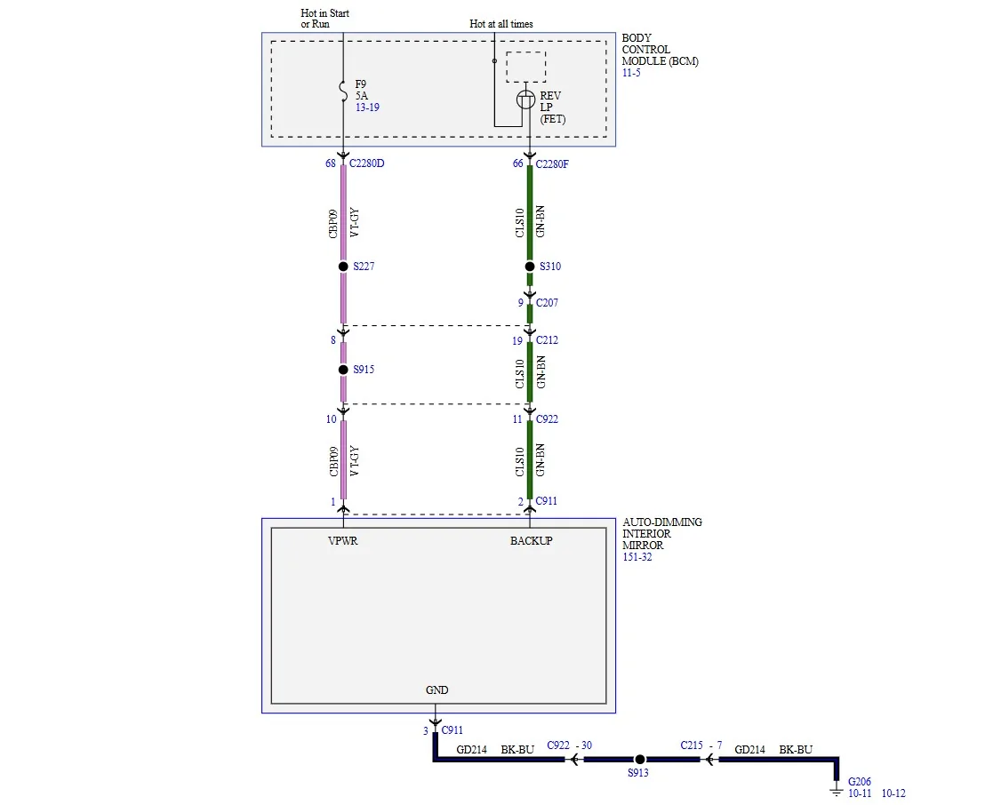

Electrical Diagram for the Mav.
Ford Maverick Mach-E Frameless Rearview Autodimming Mirror - install DIY Screenshot 2026-04-18 122641
For the mirror diagram
1= Positive from the BCM
2= Positive signal from Rev light
3= Ground
Ford Maverick Mach-E Frameless Rearview Autodimming Mirror - install DIY Screenshot 2026-04-18 122954

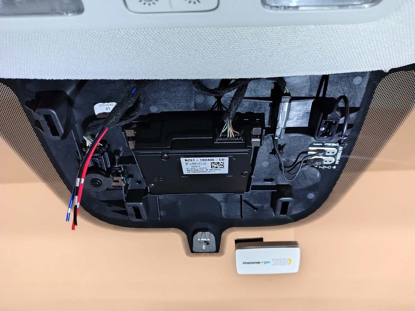

Wires From the BCM passed through the A-Pillar and roof linning.
Ford Maverick Mach-E Frameless Rearview Autodimming Mirror - install DIY IMG_20260418_085859992_HDR

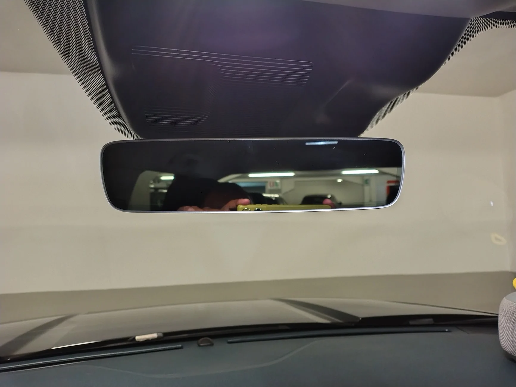

The result.
Ford Maverick Mach-E Frameless Rearview Autodimming Mirror - install DIY IMG_20260418_110954716_HDR
3= Ground
The result.
I've had one in mine for years..best addition and I've never seen the need to wire it up..looks good and easy to actually hook up..lol

Is it a camera?
why the complicated wiring?
I put mine in just going to a switched power wire already there in my 22 xlt
Quest
May 20, 2023
248
431
Canada
Its not a camera & the extra reverse wiring is to disable dimming when in reverse
